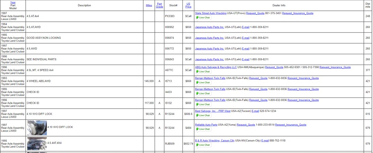

    I don't think tons and 40s and full width are ever the direction I want to head.
    Problem is the closest 80 series axle available is over 5 hours away and $650. Haven't seen any for $250.
    You guys got me wondering again if I should just pick up a TG housing to use the next couple years, and then explore all my options when it's time to do a SAS. I'd hate to put all that money in an axle now, to want to do something different a few years down the road. Although I guess most of the money would be spent on the 3rd, which could be reused in a custom housing if need be.
    If only I could decide what to do. :annoyed:

    Look for axles that are an open diff and in lx470s (the lexus 80). Thats how I found mine, it took a while but I found it. I tossed a spartan locker in it and ran it with the factory gearing for a year or so. If you plan on jumping or truck or anything you WILL have to truss any toyota axle.
    I still disagree with snowys math, he left off the STUPID expensive 80 brake parts liek calipers you will inevitably have to replace and you aren't finding one for 250 unless you know somebody. And you can build your own shave kit out of scrap metal. Even if the 14b was more expensive you are getting an infinitely better axle in evrey metric besides toyota fanboiism (snowy).

    Thanks Jake, I'll keep that in mind. Would certainly make for the easiest swap.
    Need to make a decision here soon in order to get ready for spring trips.
    Yep, definite downside to living in a small, mountain town. Usually you can count on finding anything you need in Denver, but not this time.
    I've only been looking an non-elockers, and have searched for lx450s as well. No dice.
    I'm not stuck on Toyota, but I think the big interest is I could run one now with my current setup, and it would also work for 37s and a SAS. Not true with the 14b.

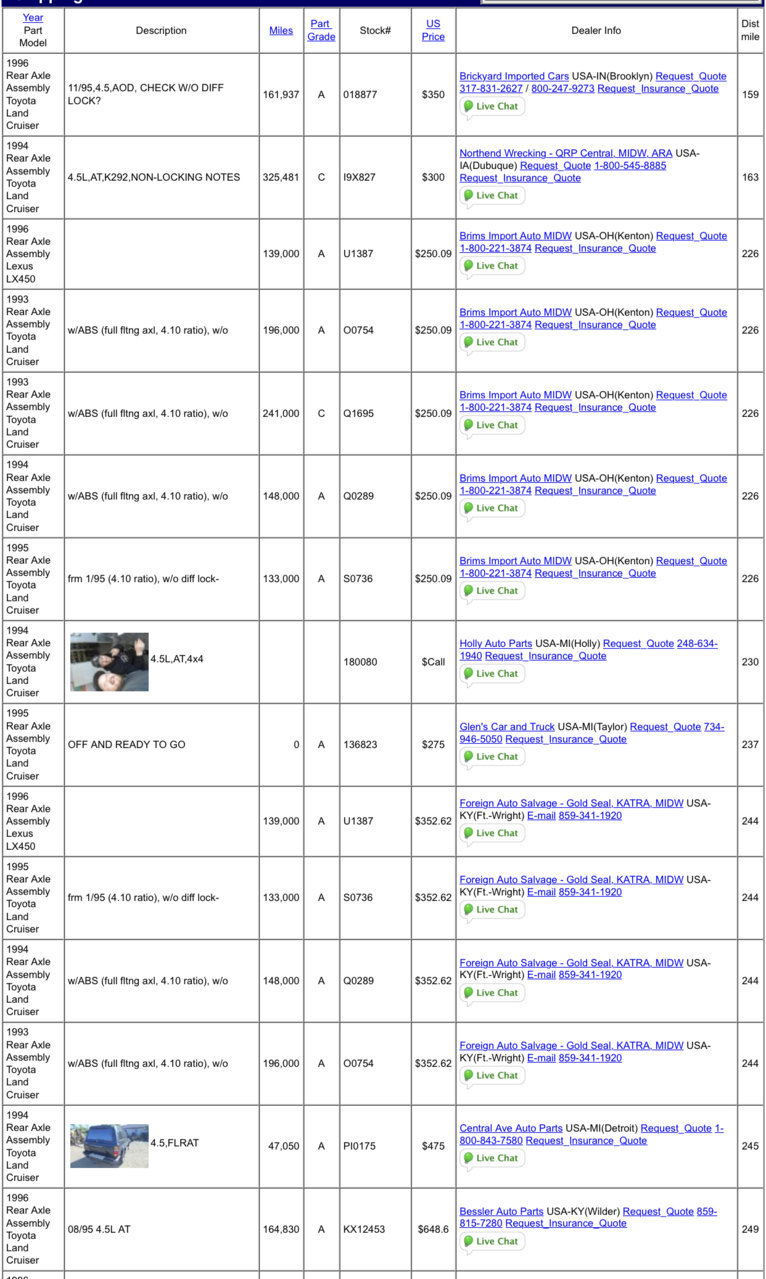

    Yea it took me a while to find mine. I dont know what junk yards snowy is hanging around at around here, but you are more likely to find a Porsche 911 in a yard before a toyota truck in the Chicagoland area. One tip is to hang out in the parting out/for sale forum on ih8mud.com for cruiser parts. I have no idea what your fab skills are or in your circle of friends but a friend of mine shaved his 14b down to where it had more ground clearance under the diff than a d44 on 37s, so its doable if you have the skills.

    They’re out there around the Midwest.
