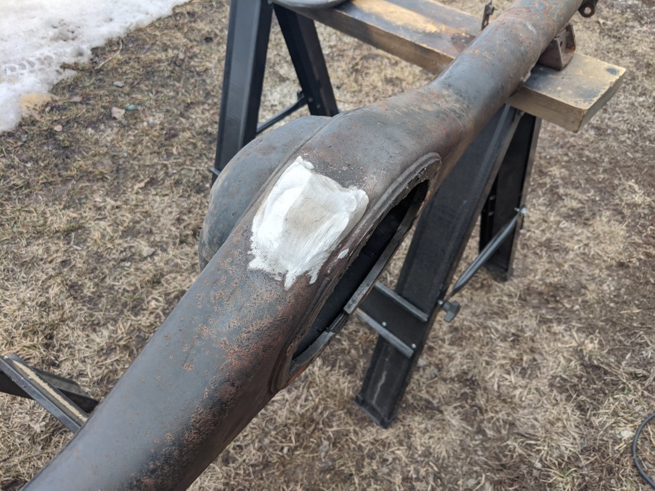

    Slowly been tinkering on front end stuff, but did get to work cleaning up the housing today and cutting off the drain plug.

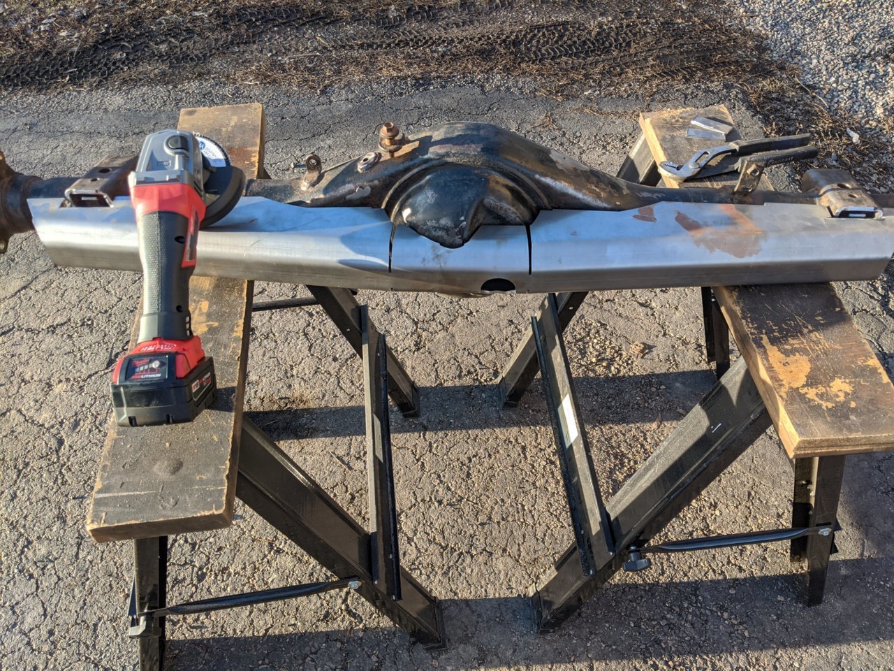

    Got the ruffstuff truss in and began fitting it up. Needs notching around the leaf perches, and some other small fitup adjustments. Also need to figure out how I'm going to mount the shocks off the back of the axle and make them fit, and make brake lines work. Otherwise seems like it will go on pretty easy.

    I nested some shock mounts that are 1.5" wide and for the round axle tube, still want them?

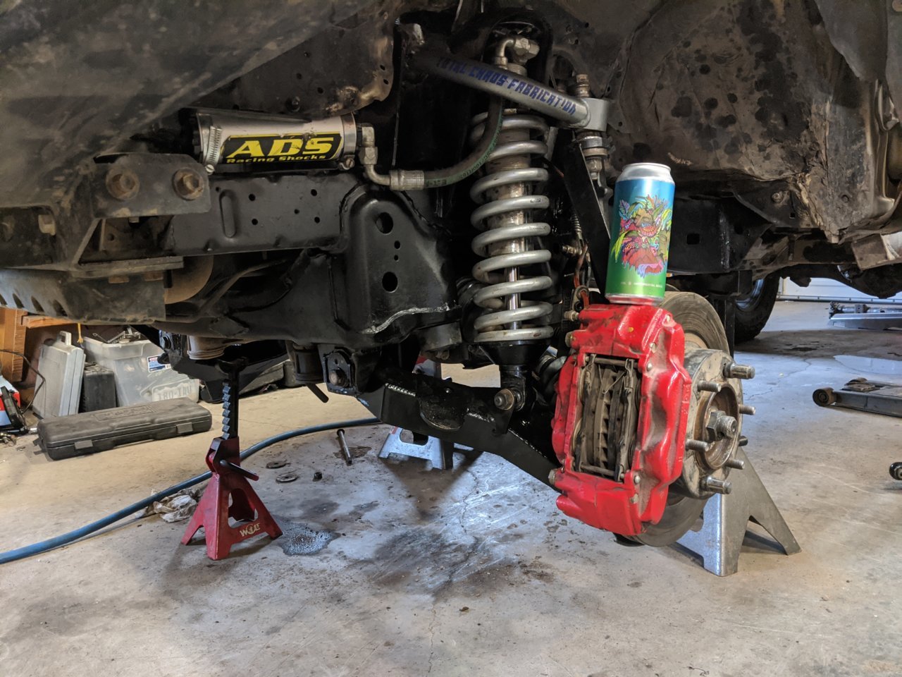

    Got the truck back on the ground today and aligned. Netted around 4.5 degrees of caster and .2 degrees of negative camber with the cams almost in the center. Super happy about that. Obviously could get more caster out of it, but would like to keep the cams centered and bushings happy.

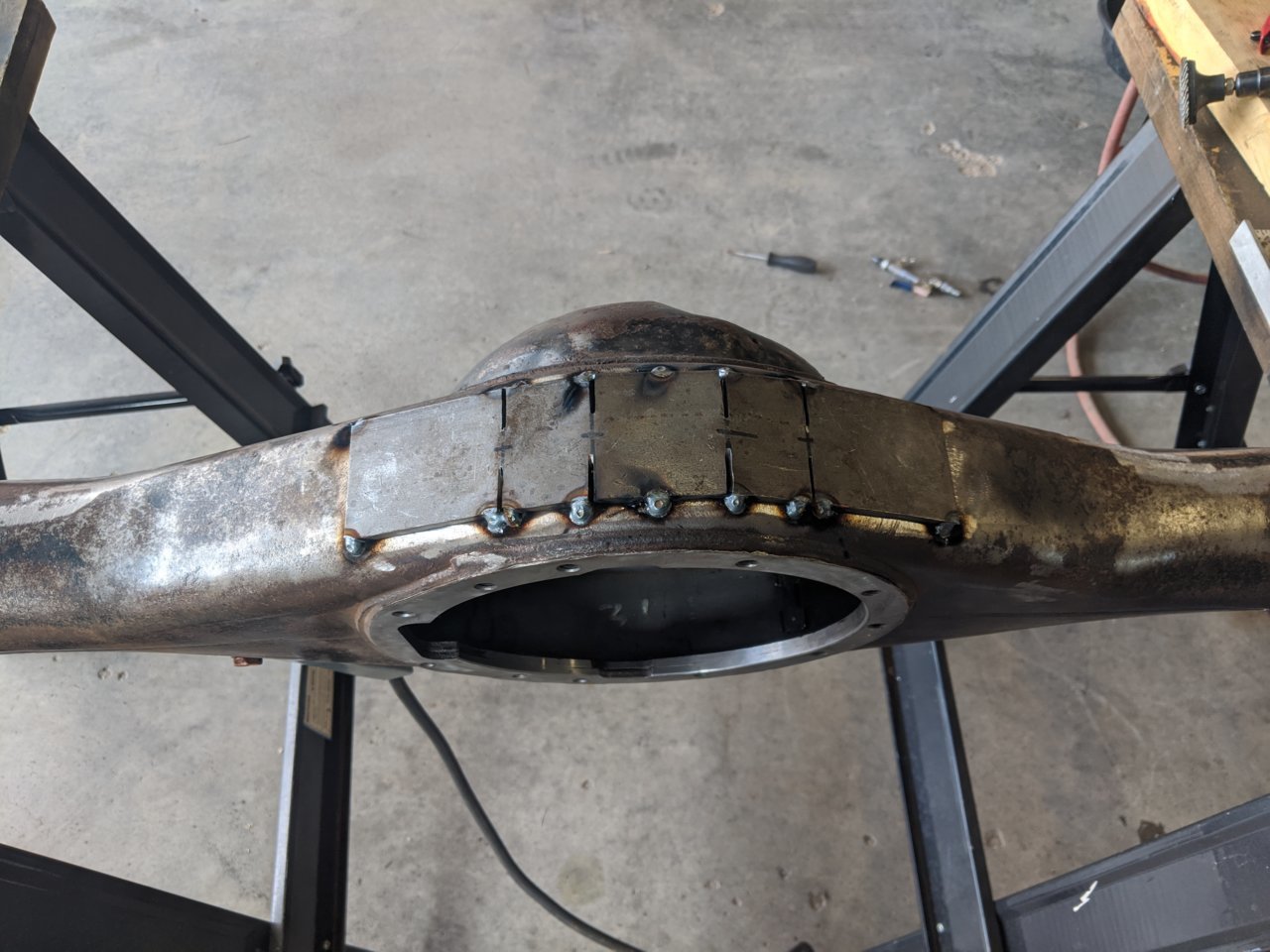

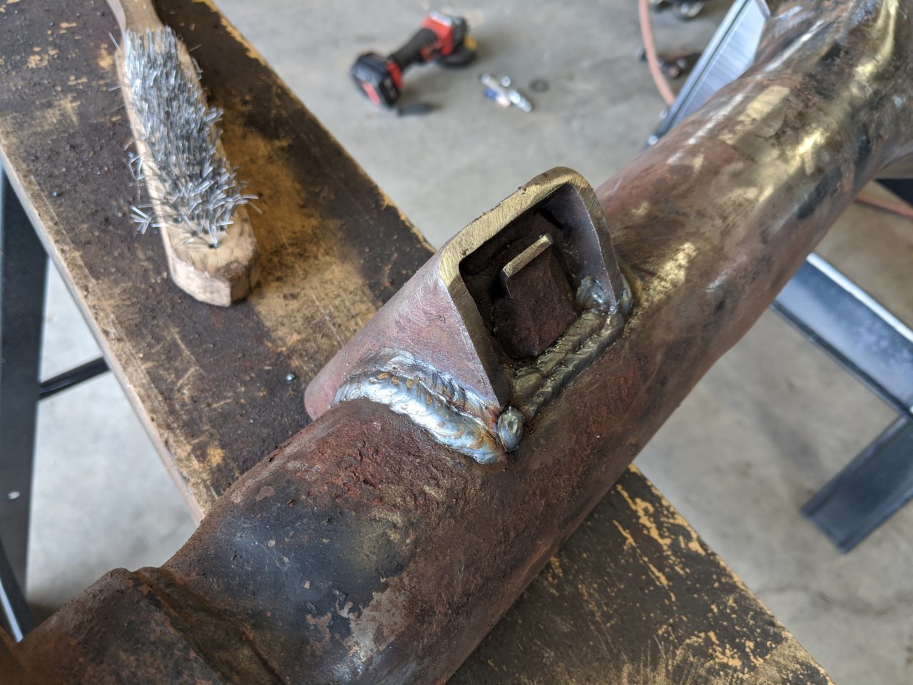

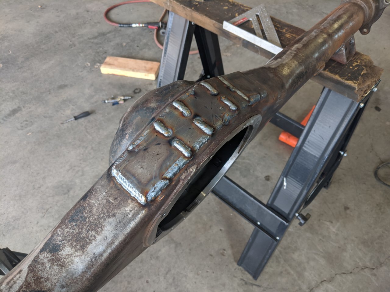

    Ground down and then welded the shit out of the perches.
    Then added some 3/16" to the bottom.
    Then back to the truss. Pain in the ass getting it fitted up around the perches and ubolts. Now that it's close to fitting, and did some measuring I need to figure out what the hell to do with the shocks. Gonna have to really hack it up to keep the shocks where they are, or move the bottom mounts further back. Or ditch the truss. Or get a truss for the top. Or I was eyeing if I can get the shocks in front of the axle. Would be a tight fit by the gastank.

    can't just notch the truss for the lower mounts?
