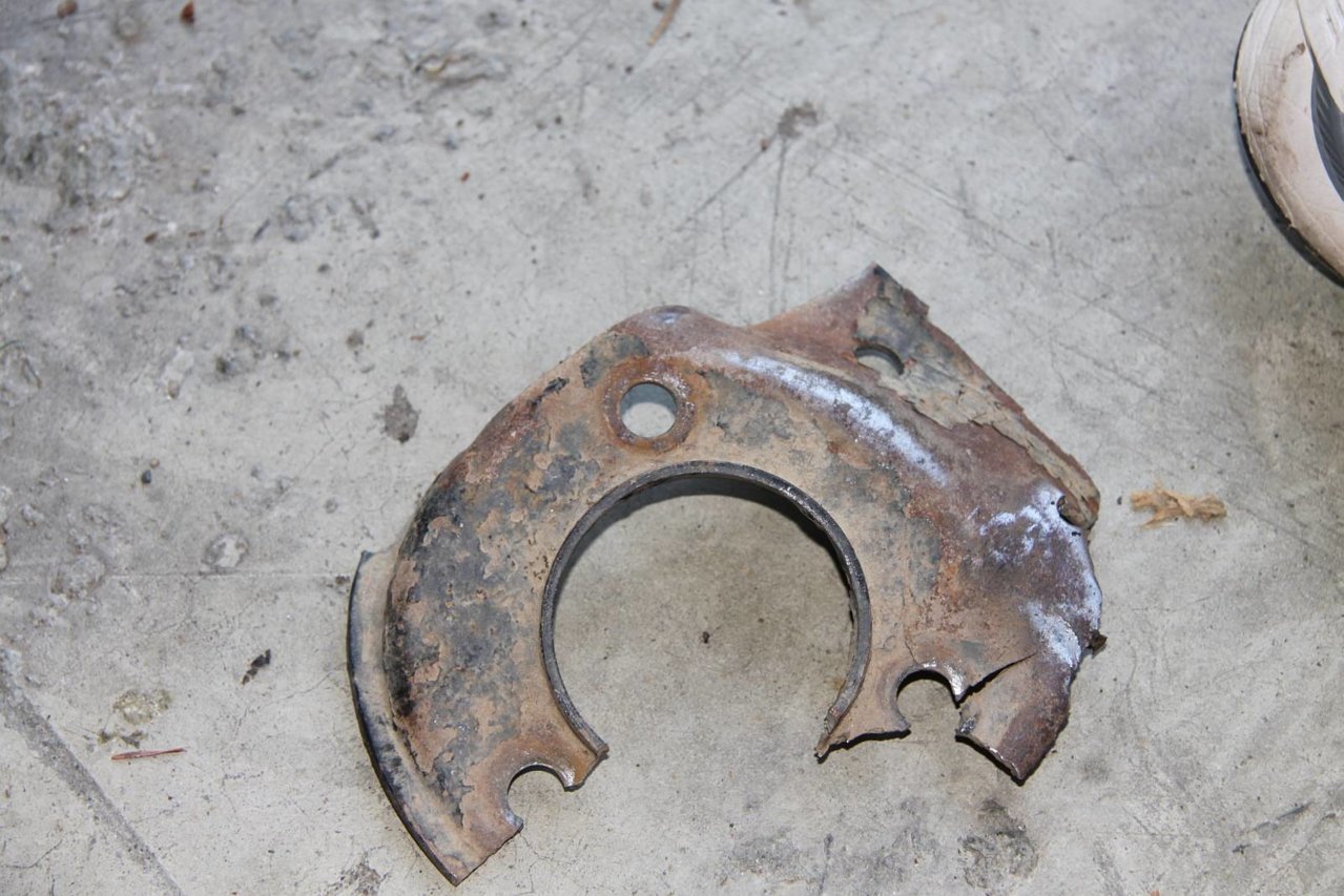

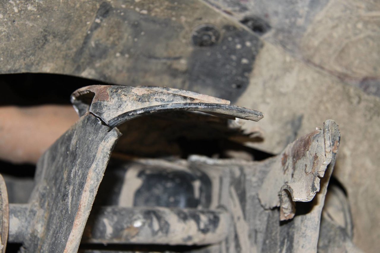

    Would you say the cracking on the coil bucket is largely due to hard topping out, hard full bump, or both?

    Just get the standard ones.
    Certainly not helping with it that's for sure.

    There seems to be a lot of contributing factors. Mine failed completely and I do not jump my truck but I have put on a large number of hard trail miles. Certainly more than most. For my failure, I suspect the shock yanking on the bucket at full extension is the biggest suspect. But there is ambiguity as well. Like why is this only happening to passenger side coil buckets.
    For visual reference...

    I figure it's a bit of both that likely contribute to the failure. Although I would think top out to be more aggressive on them than bottom outs since those have bump stops to help absorb the energy.
    I wonder how much the Eimkeith reinforcement helps to prevent this. https://eimkeith.com/buystuff/stk/
    It looks like a good amount of your coil bucket failure was at the sides though.

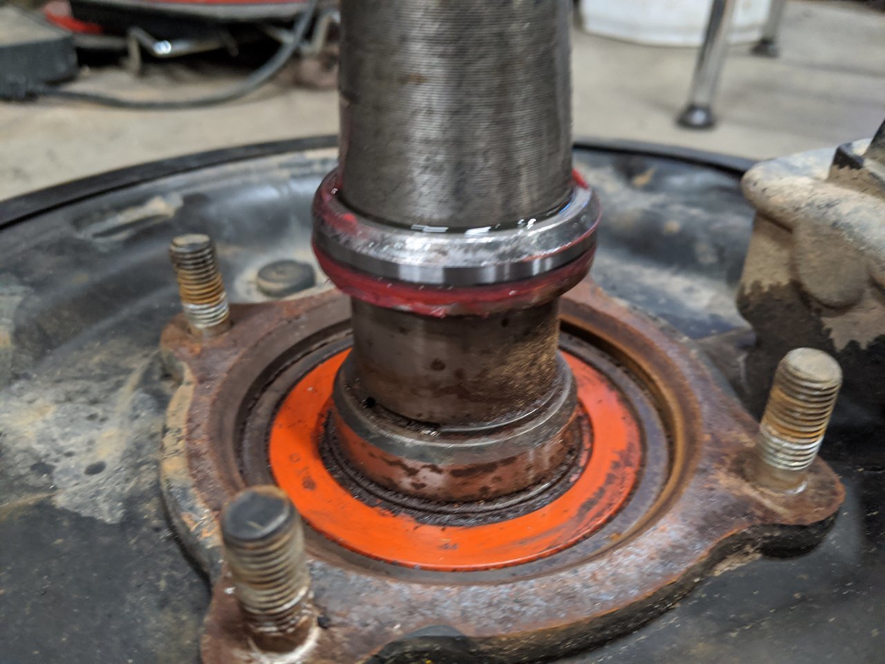

    Double checked the seals wouldn't give me a problem.
    And back together. Used some super cheap gear oil, going to flush it in a couple days.

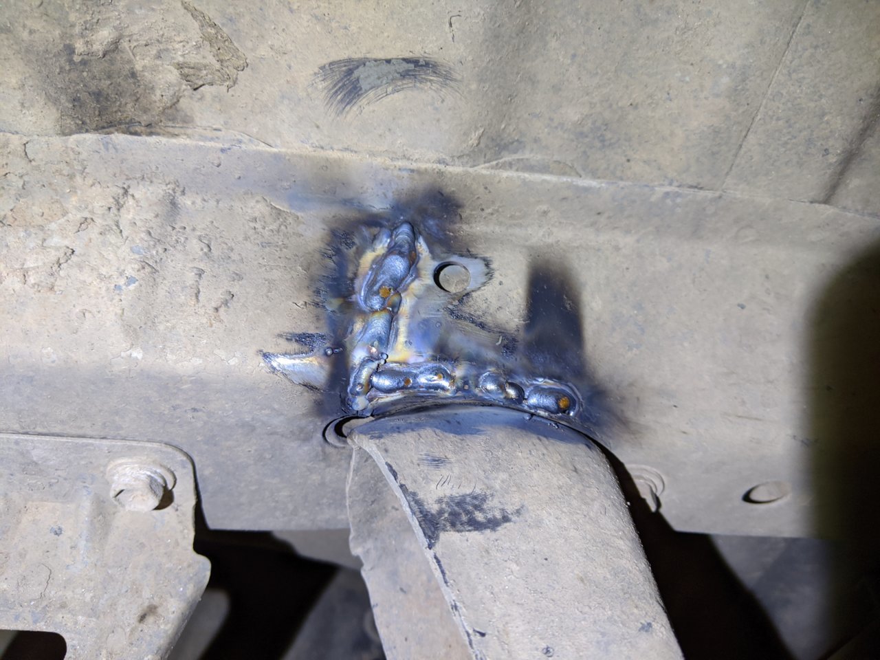

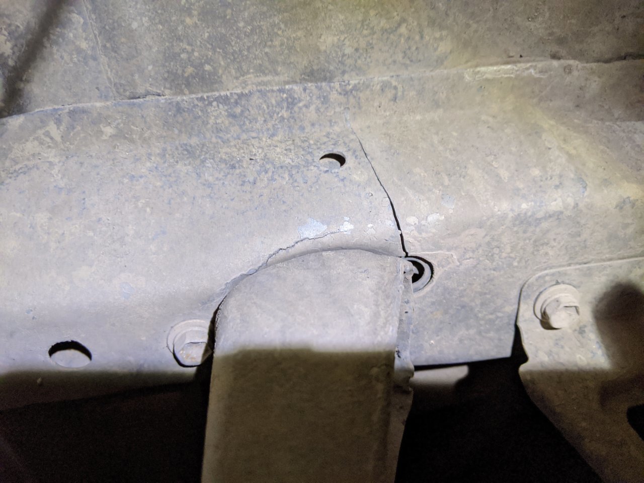

    And onto the bed, the cracks are getting worse, so I welded it up. Doubt this will buy me much time as my welds are horrible, and I couldn't get to them all.

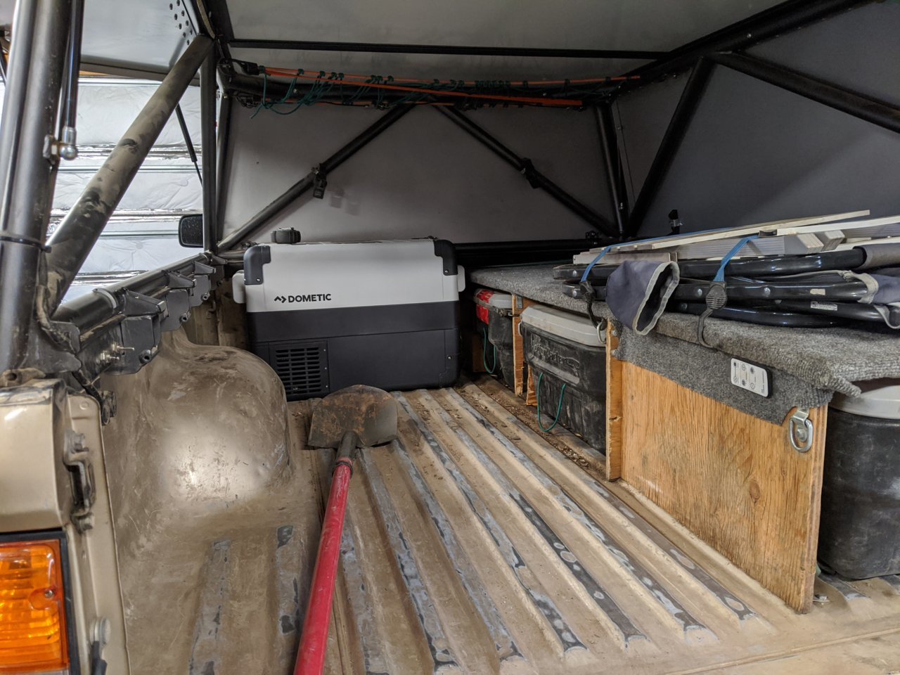

    Also, was going to mount the fridge up here, assuming I would access is from the side, but don't think that'll work as well as anticipated, so time to redo all the bed organization.
