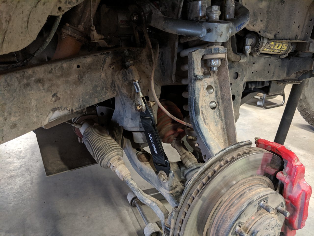

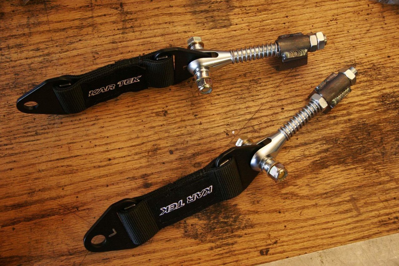

    I have some questions about what I am seeing in these pics.
    If I use a single strap can I remove the alignment spacers in the clevis and use a larger diameter bolt to hold the strap? And is a nut on the top and bottom of the clevis mount recommended with a 3rd lock nut on top?
    Also, I see you are not using the spring that comes with the clevis kit. I am curious why.

    You bought clevis' for 3 straps? Just cut the spacers down so they're tight. I bought clevis' for single straps so they came with the right sized spacers.
    I went without springs on the 8" straps to try to prevent rattles. I switched to springs when I went with the 7" straps as I was worried about the ends contacting.

    Ah! The money shot.
    Ok, that makes sense. Yeah, I didn't realize I could get them that way. These were advertised being for one, two or three straps.

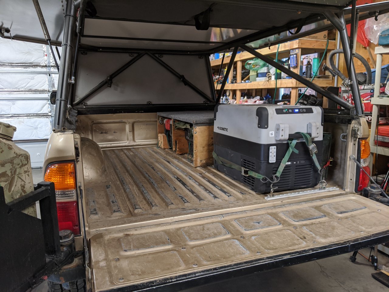

    We'll see how this works for the time being. Which means I'll probably never get to changing it. :rofl: Managed to keep some of my existing platform, and fit two action Packers and my CV under it. Have a couple front runner wolf packs coming to try out and use for my recovery kit and kitchen stuff.
    A fridge slide would be nice, but I'm going to see how it works without. Especially being I can get to everything in the fridge from the side.
