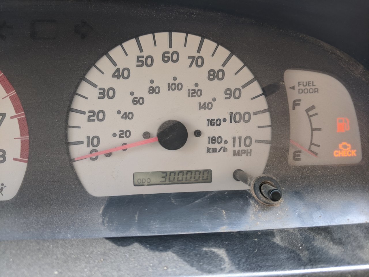

  17. Aug 29, 2020 at 7:30 PM

    300k on the Magruder.
  18. Aug 30, 2020 at 8:08 AM
    #4658
    Phessor
    Phessor Well-Known Member
    Feb 15, 2014
    #123156
    3,580
    Bob
    1998 TRD XTra Cab
    Stuff
    That is where I bragged and crap started breaking...

    Crap started breaking way before 300k for him. :rofl:
