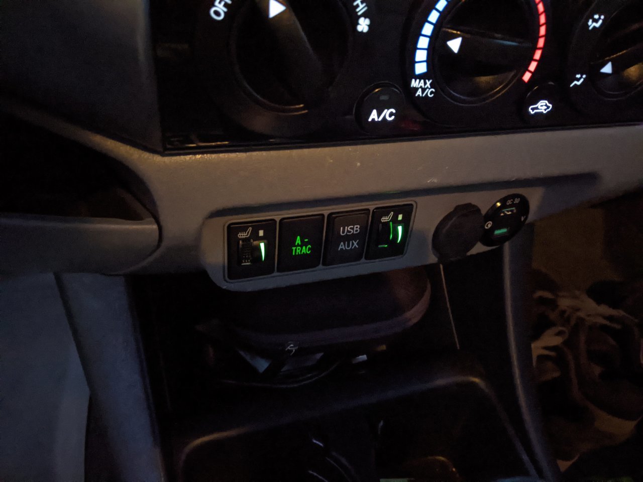

    All the bolt ons for the 2nd gen. Even one from a company with overland in the name. :rofl:
    Ready to swap over the GFC, and have some nice toasty seats in time for winter.

    Tell me more about the seat heaters…

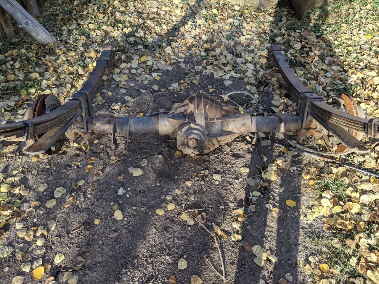

    So.... I bought a thing.

    1998 TRD XTra Cab
    Stuff
    That does not look like a Tacoma rea axle, just saying...

    Late model 14b?

    Yep. Factory disc brake so 2000+ I think.
    @Zizzle told me to do it so he better not be wrong. :luvya:

    Hurry up and find that Dana 60.
    I've still got the widened spring hanger, offset shackles, shocks, hoops and leaf springs from my 1-ton sas. Also have a truck power steering box. We can tap for hydro too.
    Start thinking about gears & lockers. If that 14b is open then just get a Detroit. Otherwise OX is working on a locker that is probably worth waiting for.
    I had 5.38s with both the 37s and 40s. Worked ok for both.
