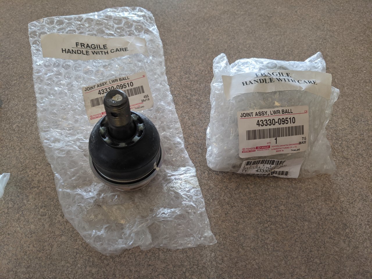

    OEM LBJs for the 2nd gen. Having owned a 1st gen, there's no other option than OEM. No idea why toyota doesn't let you buy them here, but they still got here faster from the other side of the world than anything USPS delivers :rofl:

    Got a pair of old lowers to rebuild too - you going with the white line bushings? OEM always the best but luckily MOOG doesn't make or break it as bad as 1st gens on 2nd gens. How much were the ball joints?

    $140 shipped. So more than double the Moogs, but worth it IMO.
    I'll probably go with whiltelines. I was also researching superpro, but that got a little confusing. I like the idea of adding caster at the bushing so I don't have to have the cams as crossed up.
    Also planning on adding grease zerks at the pivots, and welding up around the bushing eyes where they've been known to fail.
