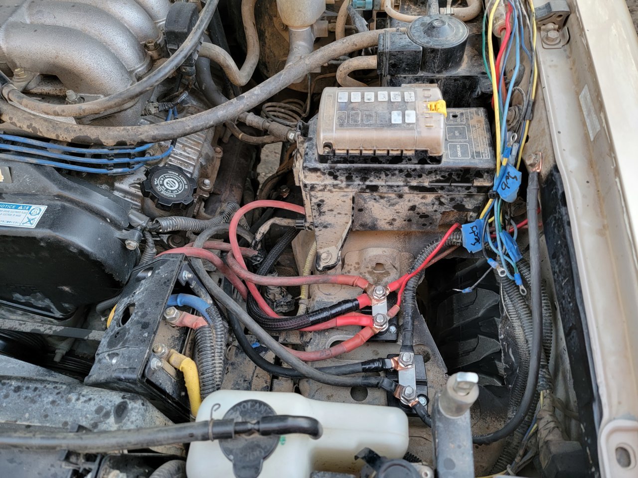

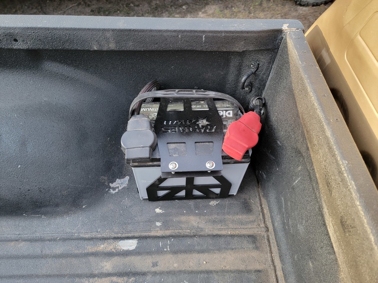

    Battery installed and made it out of the garage. Need to get a different busbar and clean this mess up a little. And cover my hole with something. :rofl:
    Lots more still to do this spring!

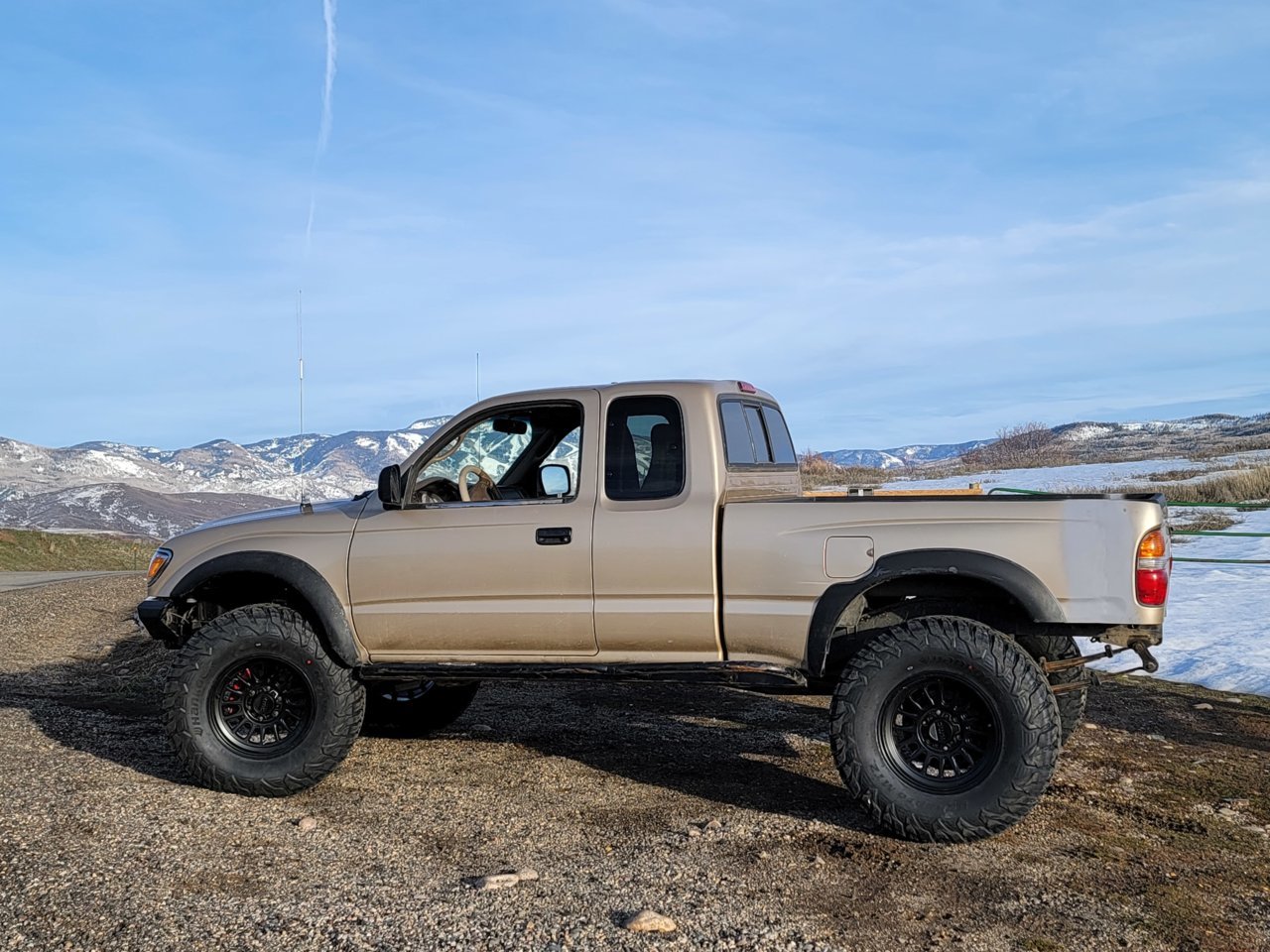

    what's the offset on those KMC's? Looks good!

    0 and running .75" spacers.

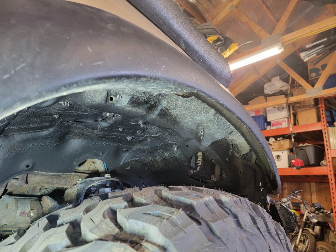

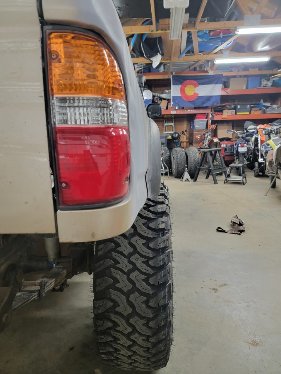

    Looks really good, Brett! It’s cool to see the next evolution of things with this truck.
    What kind of tire poke are you getting with this combo?

    Just the right amount.

    And you kept the flares because you’re obviously a man of culture and good taste.

    Y'all are making me wish I still had some. The tires just look SOOO much bigger with flares.

    Less visible gap between the tires and the body makes it look like the tires are filling out the fender wells properly. Unlike mine where 35's look like 33's because of how much I cut out of the body.

    yeah but dat tire poke :cool:
