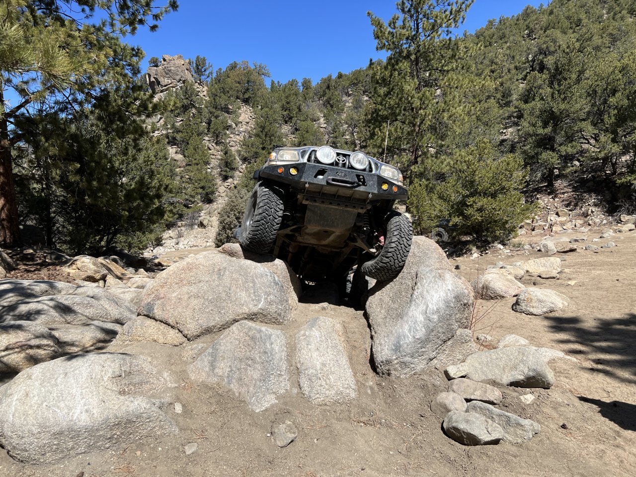

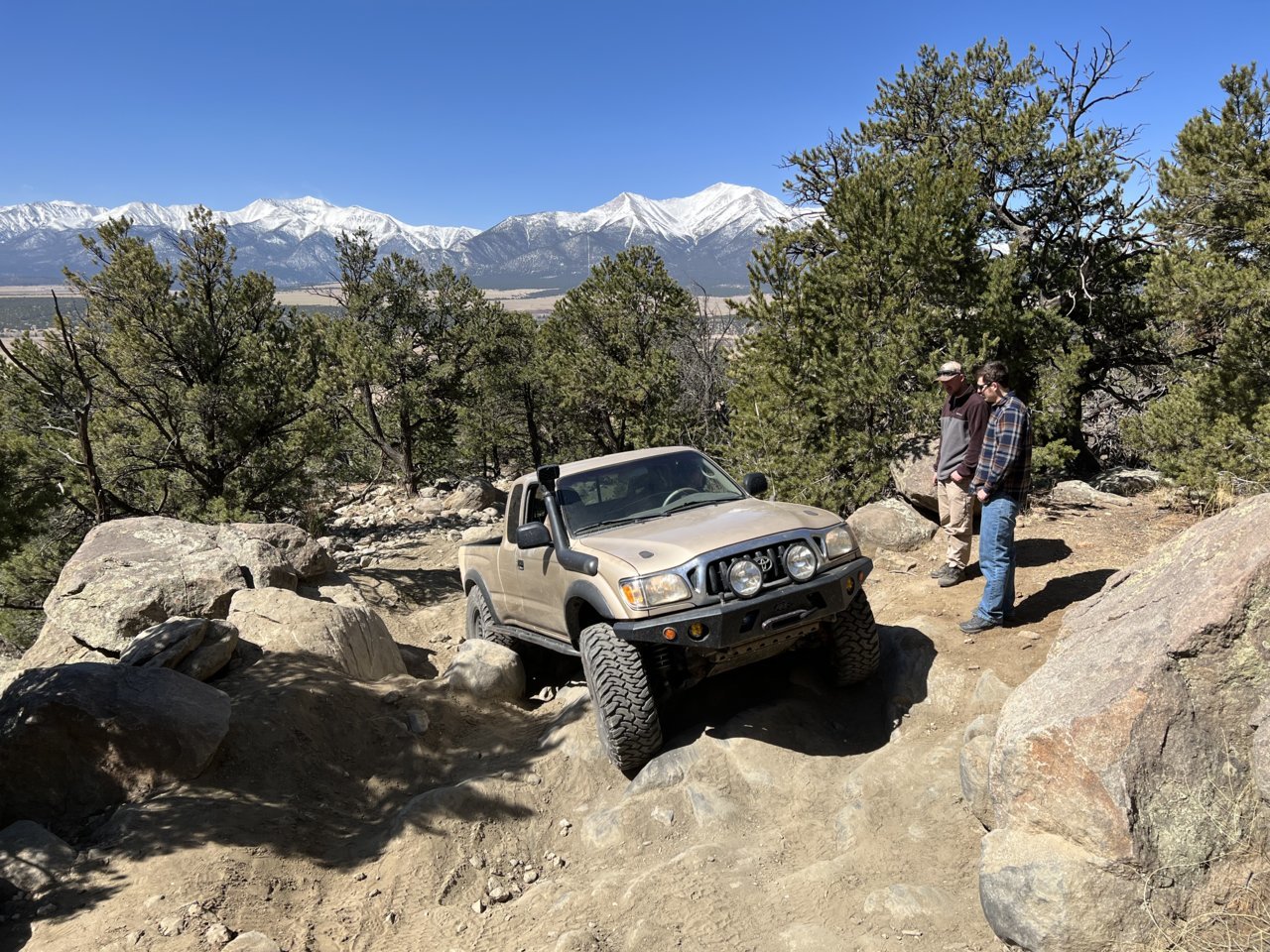

    How come the rock pile looks so underwhelming in the pics?
    But yeah, truck did awesome on the 35s. Did a little trimming in the back but otherwise clear everything 100%. Just need my NWF box to show up now.

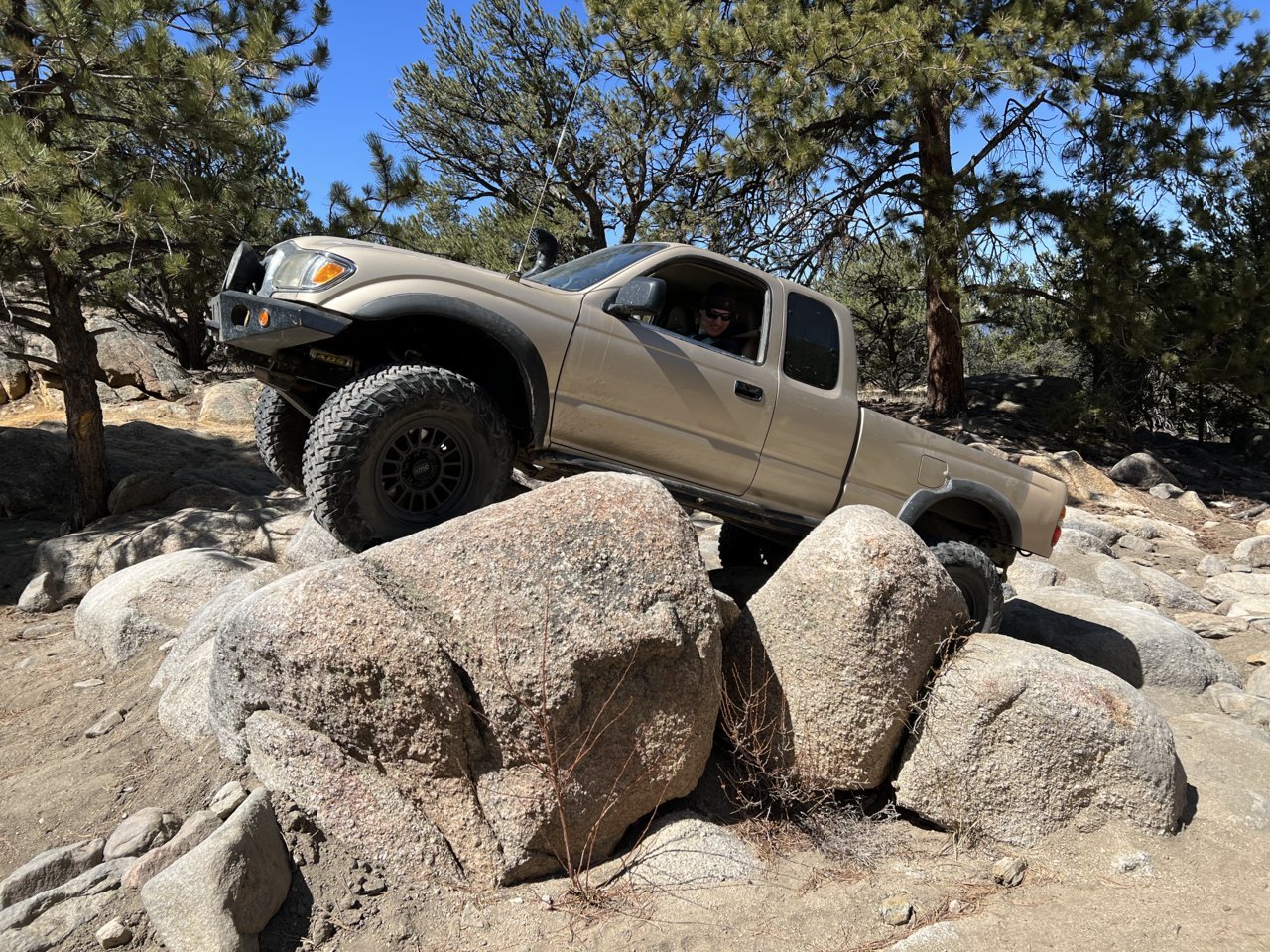

    I know, took about a dozen pics and that one shows the whole obstacle best. This angle provides a bit more perspective to its size.

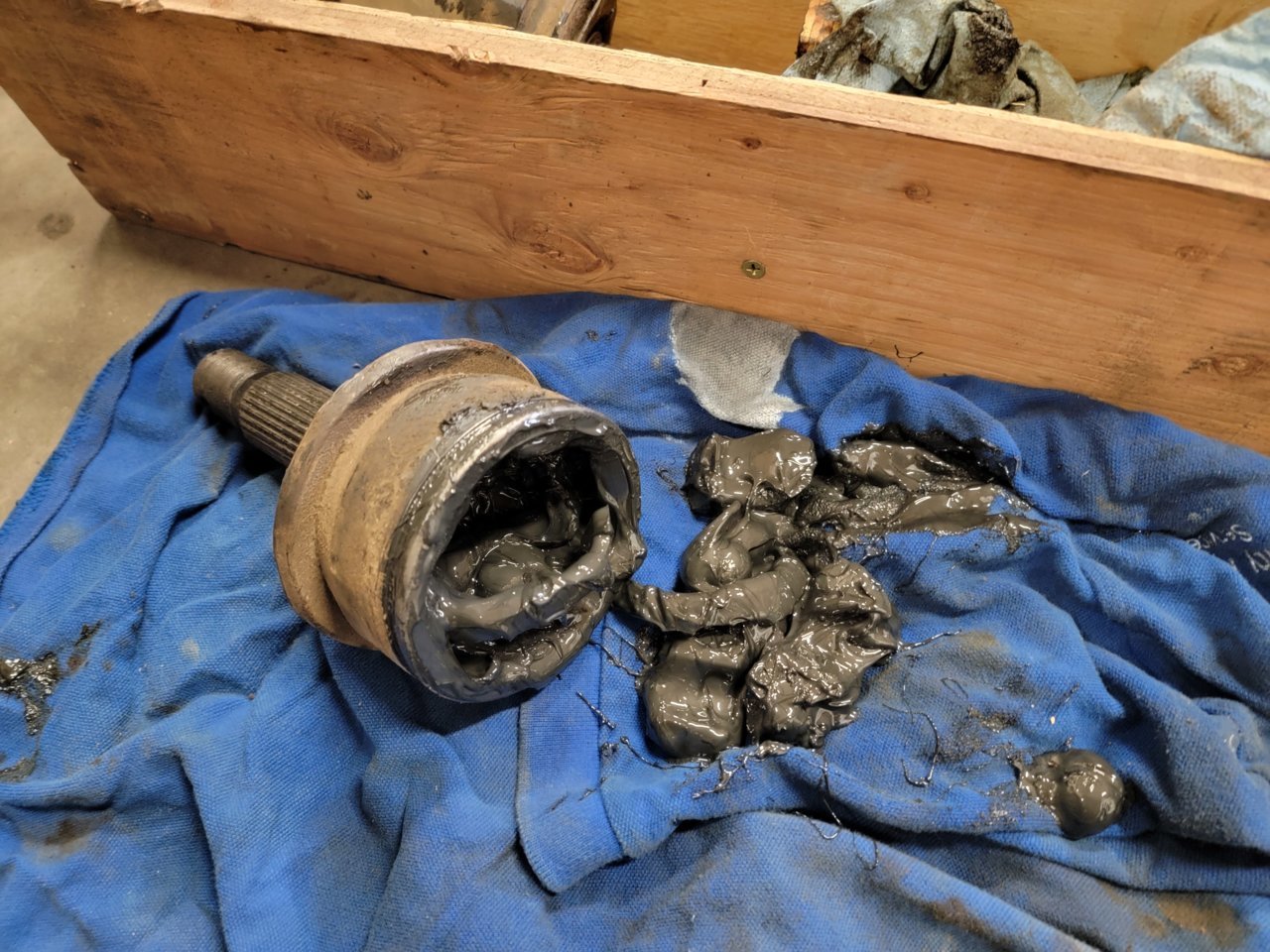

    Oops. Hopefully this isn't a regular occurrence.

    …looks at my broken longfield/inner axle shaft sitting on a shelf that exploded at idle on 37’s. Yeah that will be regular on 35’s lol

    Yeah, and it wasn't too bad to change. Need to research an aluminum floor jack/DIY pro eagle or something like that to make it easier to change.
    And not torque the CV nut excessively. :anonymous:

    The problem was last time I installed it I gave it all the ugga duggas with my mid torque. Yes I should've brought that with me, but only had the M12 stubby.
    I always assumed it wouldn't be too bad to remove with a breaker bar, but James guessed it was over 500 ft/lbs, and I believe it seeing him break it free with the cheater bar. I really don't think my mid torque should've got it that tight, but who knows. It's also been sitting outside in the snow for a long time.
    So what I really should do is actually use the torque wrench I own and torque those to spec going forward.
