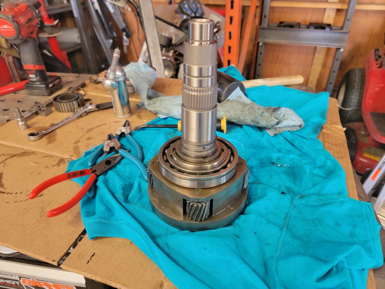

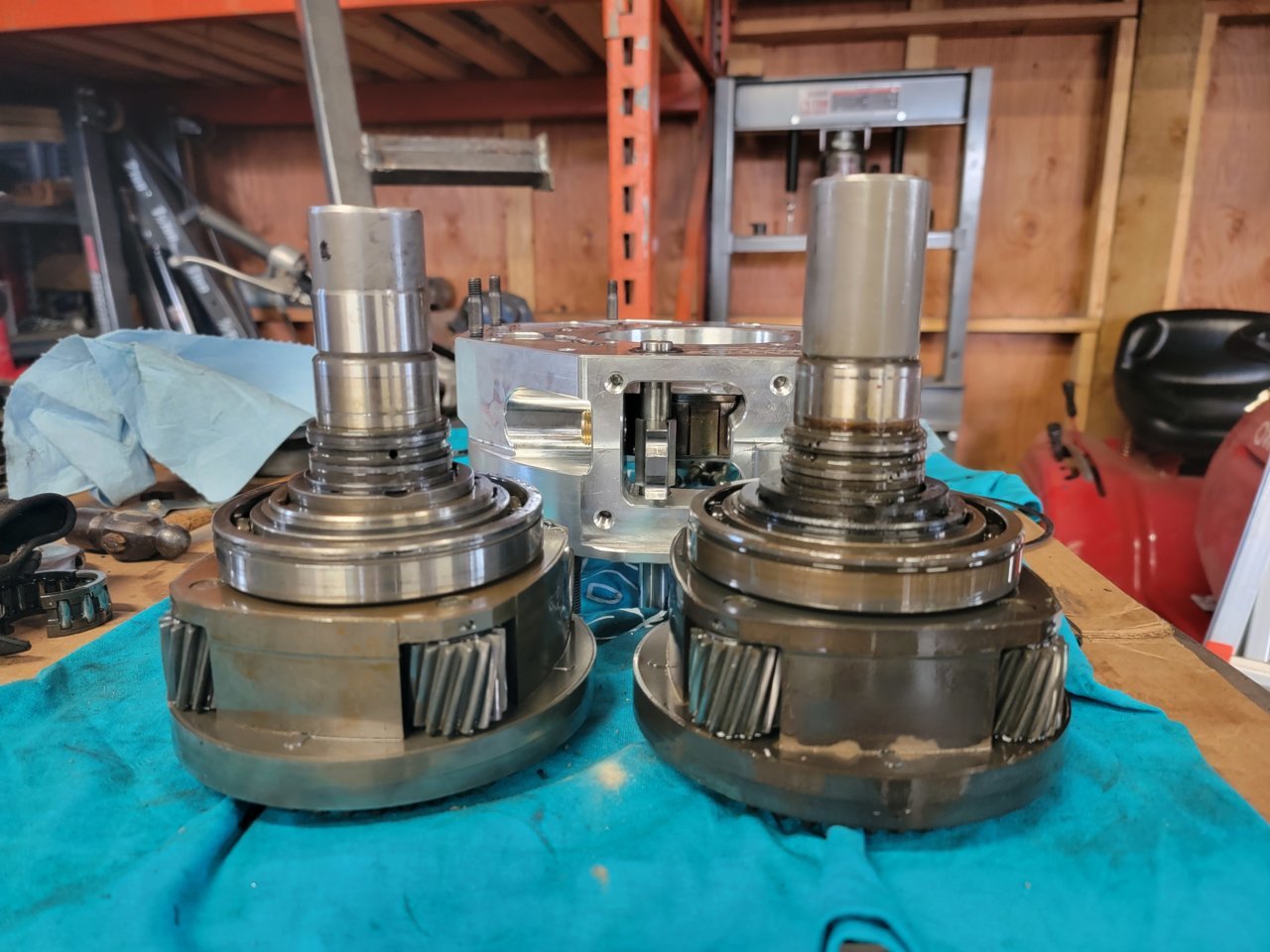

    Making progress. Decided to swap in the longer, manual tcase input shaft after the fact which cost me some time. Also may swap chains from the donor case as it's tighter than the one on mine. Should have it all bolted together soon, and then we'll see how it clears with the clocked case.

    Ready to test fit in the shitbox.
