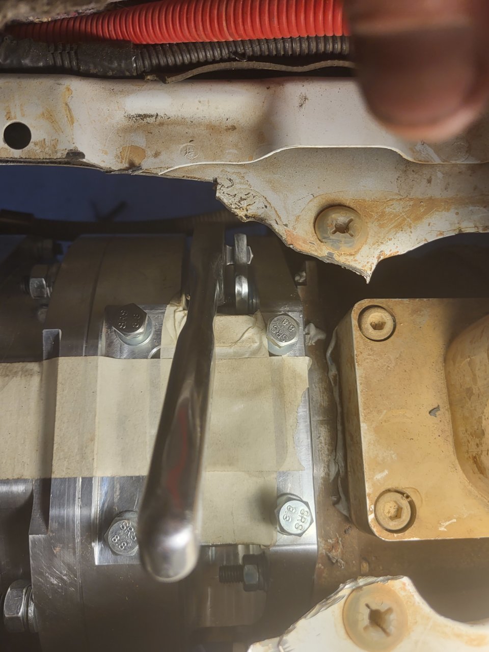

    Still needs to go up another inch....

    How fine are the clocking increments on the NWF box, Brett?

    You can do 4, 6, 10, or 16. It's temping to try it at 10, but I think I'll just get to cutting and make it fit.
    It's well above the crossmember as is, so might get the flat belly once it's all the way up.
  12. Jul 2, 2022 at 1:14 PM

    Yeah, you’re close. Nice work!

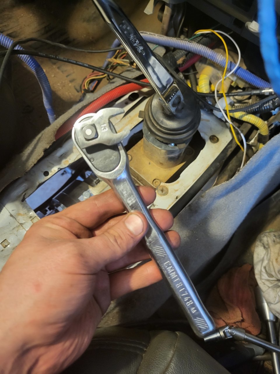

    Not sure if if you saw that post about using the crow foot wrenches for the top two studs, but it is definitely key. I never knew this tool existed and i'm not sure how I'd have gotten those two without one.
