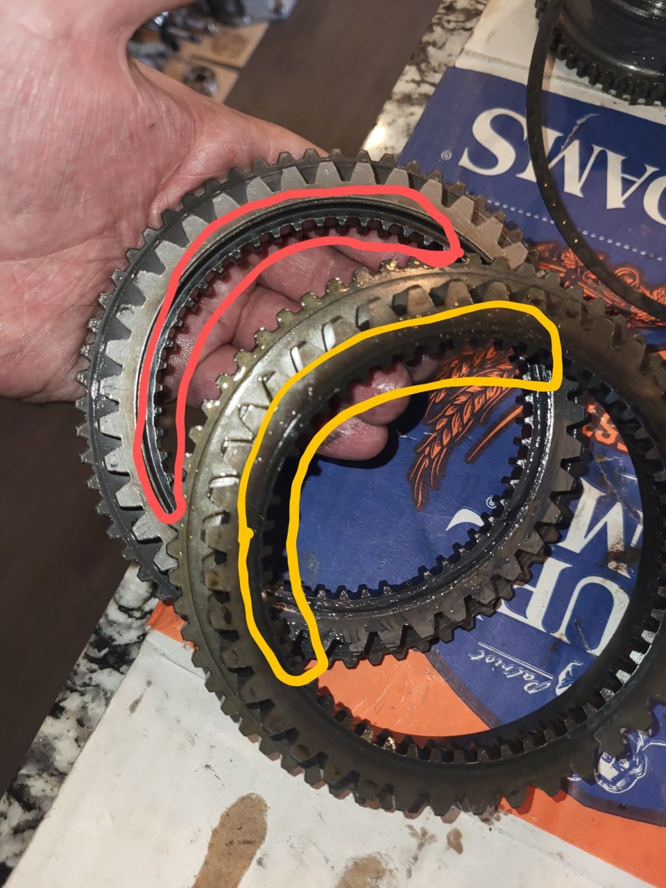

    Well shit, I used a push button as a donor. I would think with it being a manual shift for high low those parts would transfer over.
    Everything seems to be shifting fine, but I better figure out for sure before going forward. :notsure:
    I figured it was only the full electric ones on the newer trucks wouldn't work.

    Yeah, so judging by the parts diagrams for both AT and MT 1st gens with and without push button 4wd, that gear that Brian had to swap is the same between all of them.
    I'm nearly certain that whole 'electric case' info only applies if the case has an electric high-low actuator as well.

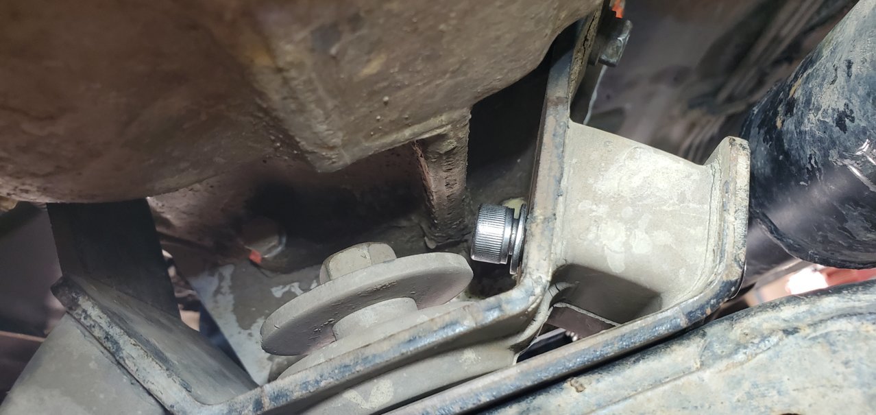

    One thing worth mentioning that I ran into. Cut more than you think you need to in the floor opening for the shifters and rear case. Between the cab mounts moving around and the torque from the duals, they made more contact than I expected.
    I also did the marmount mod on my trans mount to try and help cut down on the amount of twisting.

    I have solid engine and trans mounts, and poly cab mounts, so way less movement than stock.
    Speaking of which, I was going to mention that before, becasue between all that and my hacked up motor mount perches and mounts, I really have no clue where the trans is sitting compared to stock. But really, it doesn't look too far off your picture. :notsure:
    Well, let us know what you hear!

    Yeah, I'm still not sure on this one -
    Studied the parts diagrams again, and it sure looks like all the low range planetary parts are identical including the shift fork between the two cases. Given mine's assembled and working, I think I'll finish putting the truck together and test it. :notsure:

    I should have looked back for this sooner, but FWIW, from what I can tell that gear in your first photo does appear to be the correct one (right). Versus mine that was recessed on electronic shift (left)
    Edit:added pic
    I've been waiting to weigh in on this because I didn't want to be wrong, but now that @jstemp weighed in, I am going to jump on the band wagon here now and say run it. If it's shifting through the functions properly and not blowing past low, you should be good.
    Honestly though, it's like 8 bolts to take that apart and split the eco crawler to look at it. Take you 30 minutes start to finish. Just sayin.
