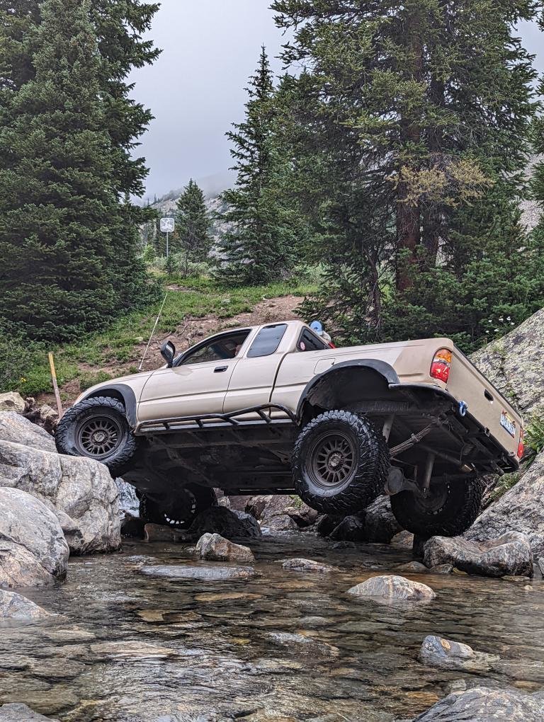

    I'm sure its posted somewhere... sorry for being lazy, but what FD ratio are you at?

    123:1

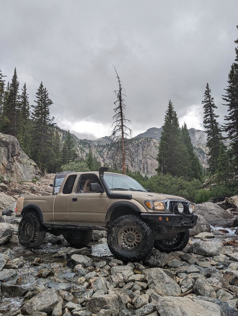

    How did you end up with 2 different colors on your bed? I thought you just hacked a section out and put the tail back on.

    I did, but then there was a welded seam covered in some of my finest hack job body work I needed to cover.
    The rattle can came out for a temporary solution. I'm still planning on bedlining the whole truck eventually.
