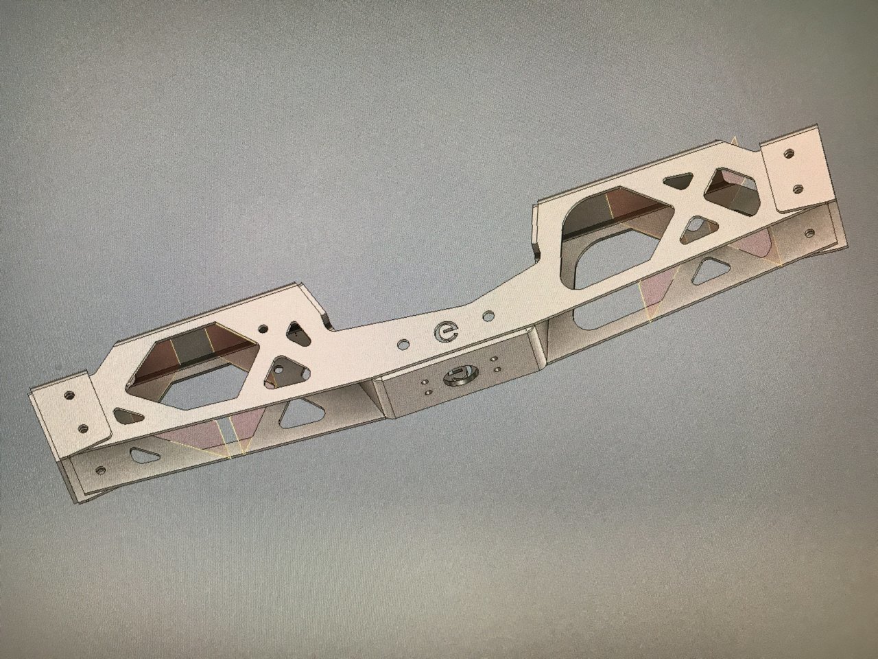

    let me look for a screenshot. I've been working on this in conjunction with my transfer case clocking kit - pair those with either the fuel tank lift (Taco) or fuel tank relocation (T4R) and you get a couple more inches of ground clearance/break-over without additional lift. :)

    '96 4Runner, '03 Taco
    here's the first screenshot I found - I just designed the crossmember to pocket the factory mount (like a hammock) instead of sit below it, picked up a couple of inches. The sides are flush with the bottom of the frame, so it's a very gentle slope to the transmission mount area.
    (photo does not show 6 additional plates that box the structure)
    Exhaust and front driveshaft pass through the crossmember (oh yeah, requires an exhaust lift - cut 2" out above the cat and the entire exhaust is now above the frame as well)
    Got slowed down on this one, because I have to make it suitable for both auto and manual trans, and both Taco and T4R, so lots of fit verification going on.
    It'll get its own skid plates, etc.
    BTW, don't share this with the Russians, already getting most of my catalog ripped off over there. :/

    Looks sweet! Having pass throughs for the exhaust and driveshaft seem like an awesome solution for that.
    Looking forward to your gas tank lift, wish you had this available soon too! I'll probably be welding up a simple tube crossmember for the flat belly, now that I have the clocked case and exhaust above the frame as well.
