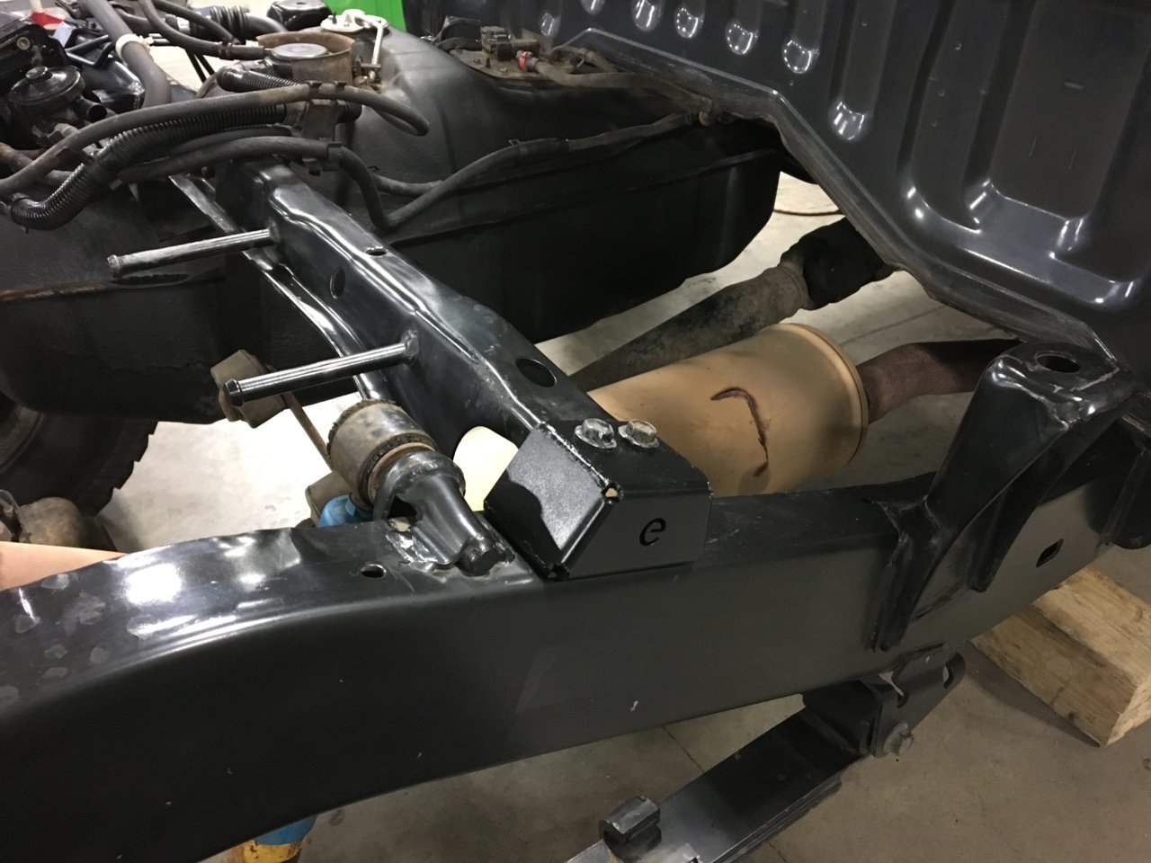

    OK, initial questions:
    Was you intention to bolt your frame brackets in and not weld them? I see the holes are all set for that, but might try welding the lower bracket in and reversing how the crossmember bolts in so I can still remove it. Or just weld the shit out of everything. :D
    Any measurement/reference on notching the bed support?
    Thanks man!
  8. Oct 1, 2022 at 4:44 PM
    #5248
    eimkeith
    eimkeith Well-Known Member
    Jan 8, 2017
    #206925
    452
    J Keith
    '96 4Runner, '03 Taco

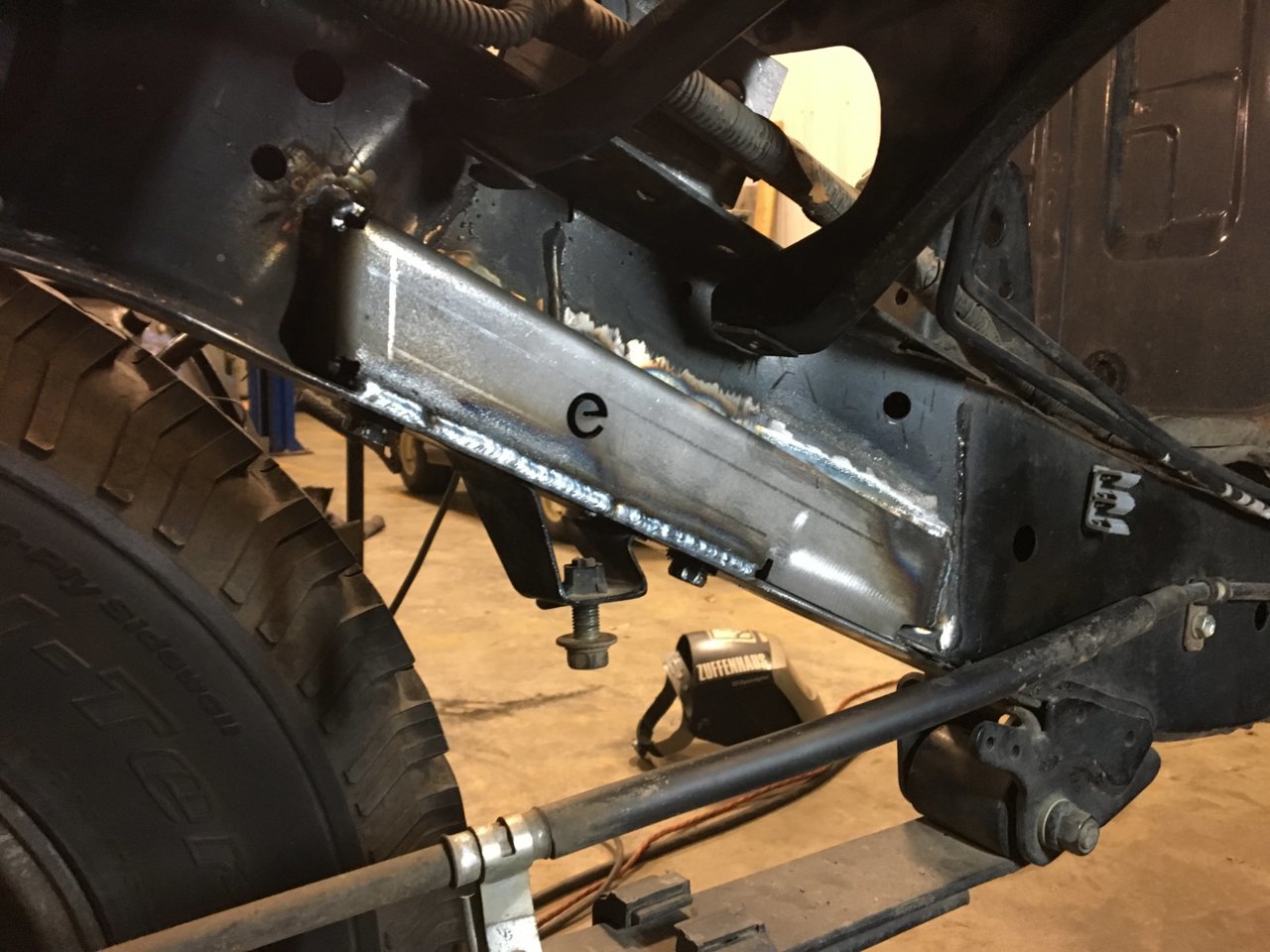

    I made it so it could be located with bolts for easy positioning. (I welded my lowers, too.)
    but bolted the top:
    the front mount is the tough part - cutting out the factory one is a bit tedious in tight quarters. should locate pretty easy after that.
    the strap modification should be more straightforward.
    Let me dig for those tomorrow - I measure everything, just need to find them.

    Thanks for the info! I'll weld those lowers in. There's some very slight interference with my TG frame boxing plates, but should be quite easy to make work together.
    That front mount was easy to cut off with a sawzall. I was worried about that when I saw you did it with the cab off, but it was no problem. That bracket locates itself surprisingly well. :thumbsup:

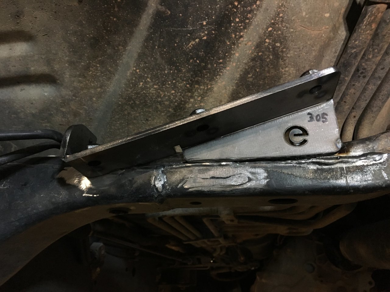

    I have a cut jig for both the bed cuts - and I can send the file, but need to ID someone local to print them. (or I send mine) - you simply position, trace, and cut on the lines with these.

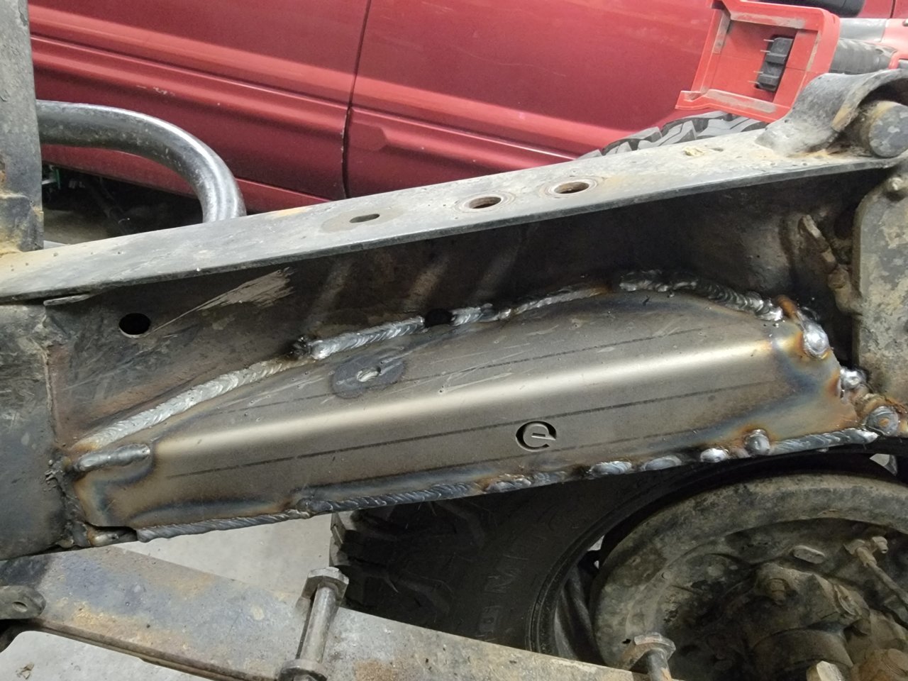

    Nice to get the last bit of frame sorta boxed in.
  19. Oct 6, 2022 at 12:02 PM
    #5259
    eimkeith
    Jan 8, 2017
    #206925
    452
    J Keith
    how was the fit over there on the right-hand side of the photo? I tweaked that end of the part after I installed mine to reduce the likelihood that debris would get stuck over there - and since mine are welded on, I couldn't test-fit the revised part. Your impression?

    I can see you were drinking while welding this on. Started out sober on the left.
