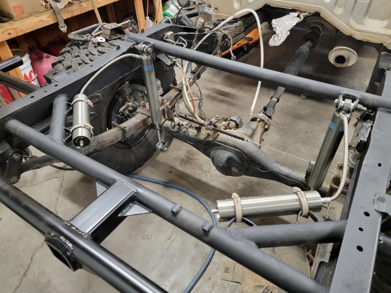

    Close to getting the tank back in. Shocks fit surprisingly well with no changes. Still want to cut off and redo the trans crossmember and various other things. Gonna cut it close to Moab next week. :goingcrazy:

    Nice, even painted a little! Did you get new bumps to go in there as well?

    No, but I cut the little bump stop strike plates off the frame. Should have about 2" more uptravel than before, and match well with the Deavers with the reverse front eye.
    It was some quality tape measure guess work. :rofl:

    No longer rocking the alcan's?

    No. They were too much after my truck went on a diet. Currently rocking some old Deaver J59s that I think have an extra leaf added.
    They're nice and flexy, but definitely not made for carrying weight.

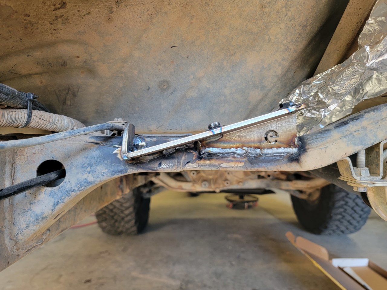

    so simple, right? - how was that missed before? (my constant refrain for this stuff)

    looks great dude! Thanks @eimkeith for always coming up with accessible solutions for our generation!

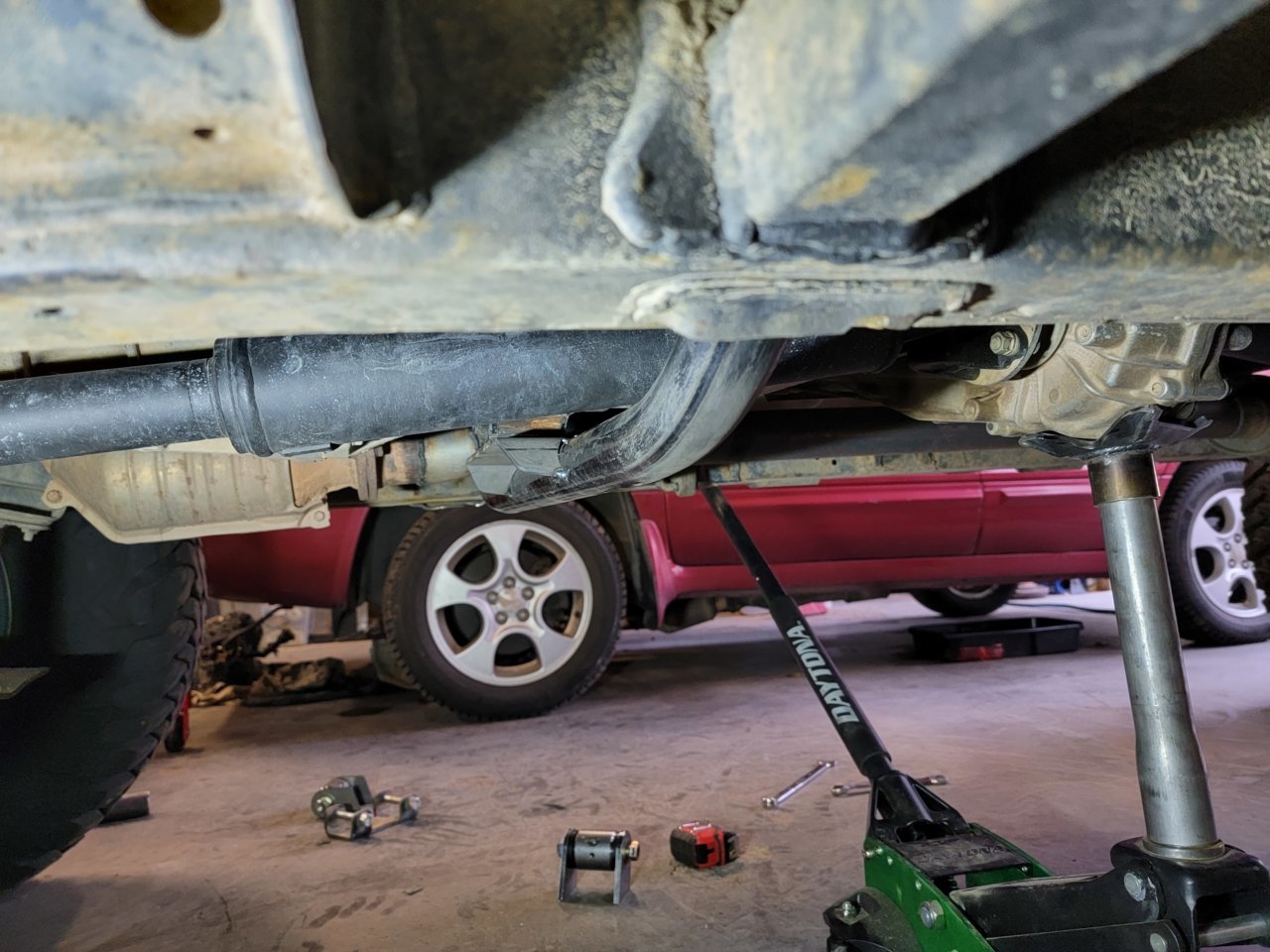

    Won't quite have a flat belly, but this is about as close as I can get it. Should wrap this up tomorrow and get the bed back on and hopefully be good to go.

    That’s a great idea. I just repaired the thin sheet metal yet again and have been contemplating what to do for the crossmember. If you don’t mind could you share a pic of how you installed the trans mount?

    How will you mount the t-case skid?

    I had an aftermarket trans mount I cut up and welded to my new crossmember. There will be bushings on the frame side though, and the engine is already solid mounted. No reason you couldn't just weld tabs off the tube to bolt your original mount back up.
    I'll take more pics after I hopefully finish it today.
    Haven't got there yet, but will probably build a similar crossmember behind the tcase, weld some tabs off the tubing, and then can make a simple skid between them. Or just weld the shit out of everything and tie it all together.
