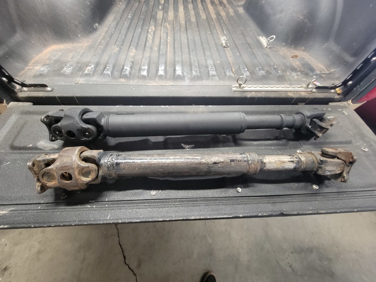

    Retubed shaft back in.

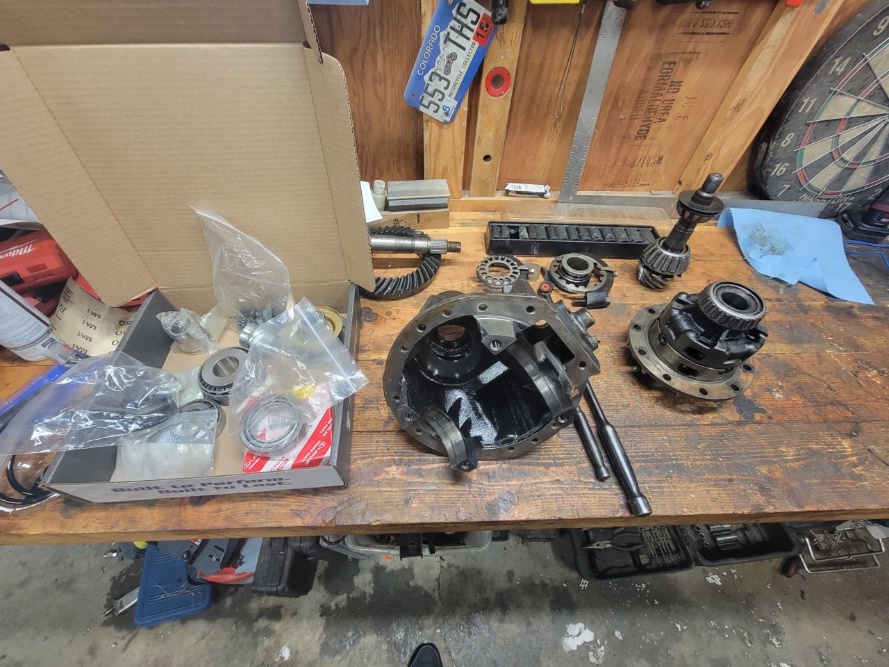

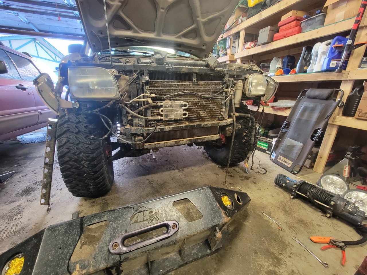

    Truck's back in the garage. Hoping to have it dialed for summer and not stuck working on it like last year. 1st order of business is building a new front bumper to try to improve clearance a bit. Going to start by raising the winch up a bit and build out from there.
    Also in the process of setting up a spare diff.
    Other than that, just need to give the front suspension a once over, and button up the interior that I never finished last year. :anonymous:

    Bumper from scratch or modding the AP?

    From scratch. Planning on a hybrid.
    AP is for sale.

    Did you weld a nut inside the diff in the rear for the "drain bolt" when you welded over the drain plug on the bottom?

    No, I just removed one of the bottom 3rd member studs, and use a bolt from the outside.

    OK, so just back into where the stud threads into the housing.

    Correct, I figured if the stud was threaded in there, it's enough for a bolt. I guess a nut on the inside wouldn't hurt though. :notsure:
