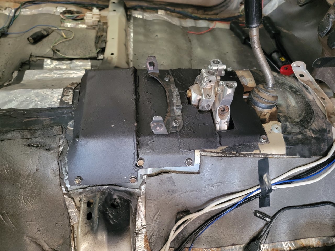

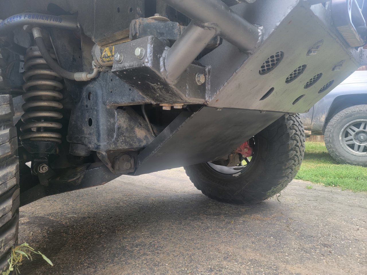

    Got burned out after the bumper, but actually need to get this thing ready..
    Built a new skid to match the new bumper/radiator.
    And this looks too familiar...

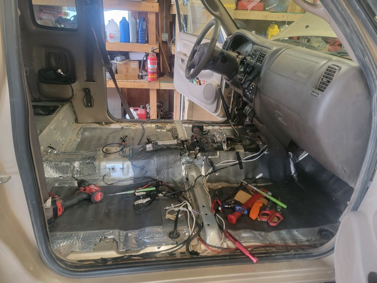

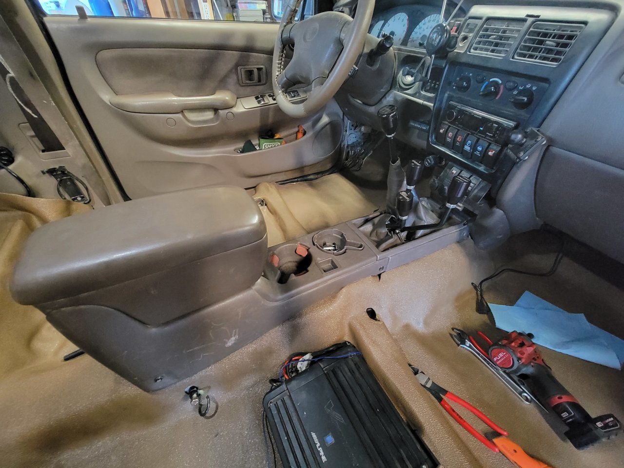

    Going to better seal the trans tunnel, fix some f'd seat mounts, and finally put the interior all the way back together for the first time after the crawlbox install. :anonymous:

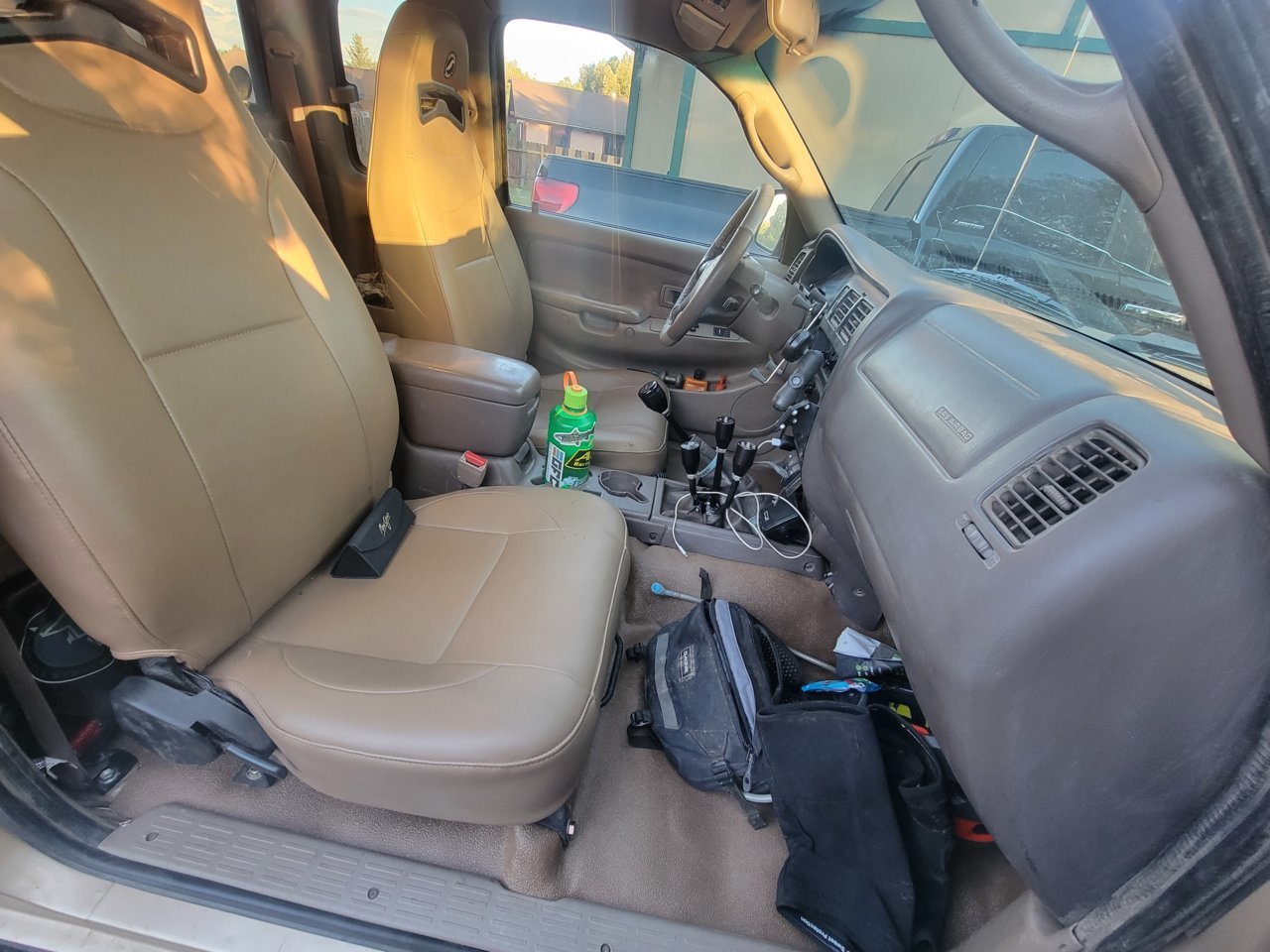

    My sheet metal work is questionable at best, but this should be a huge improvement. Only had to trim a little more on the console. Also got the shift levers painted and the black knobs from NWF. And fixed all the seat mounts by tapping them out to 7/16" fine, minus one of the front ones that needed a new nut welded in, which was a major PITA.

    All back together and much quieter than before. Real test in a few days.

    Nicely done! Looks a lot better than the first go around.
