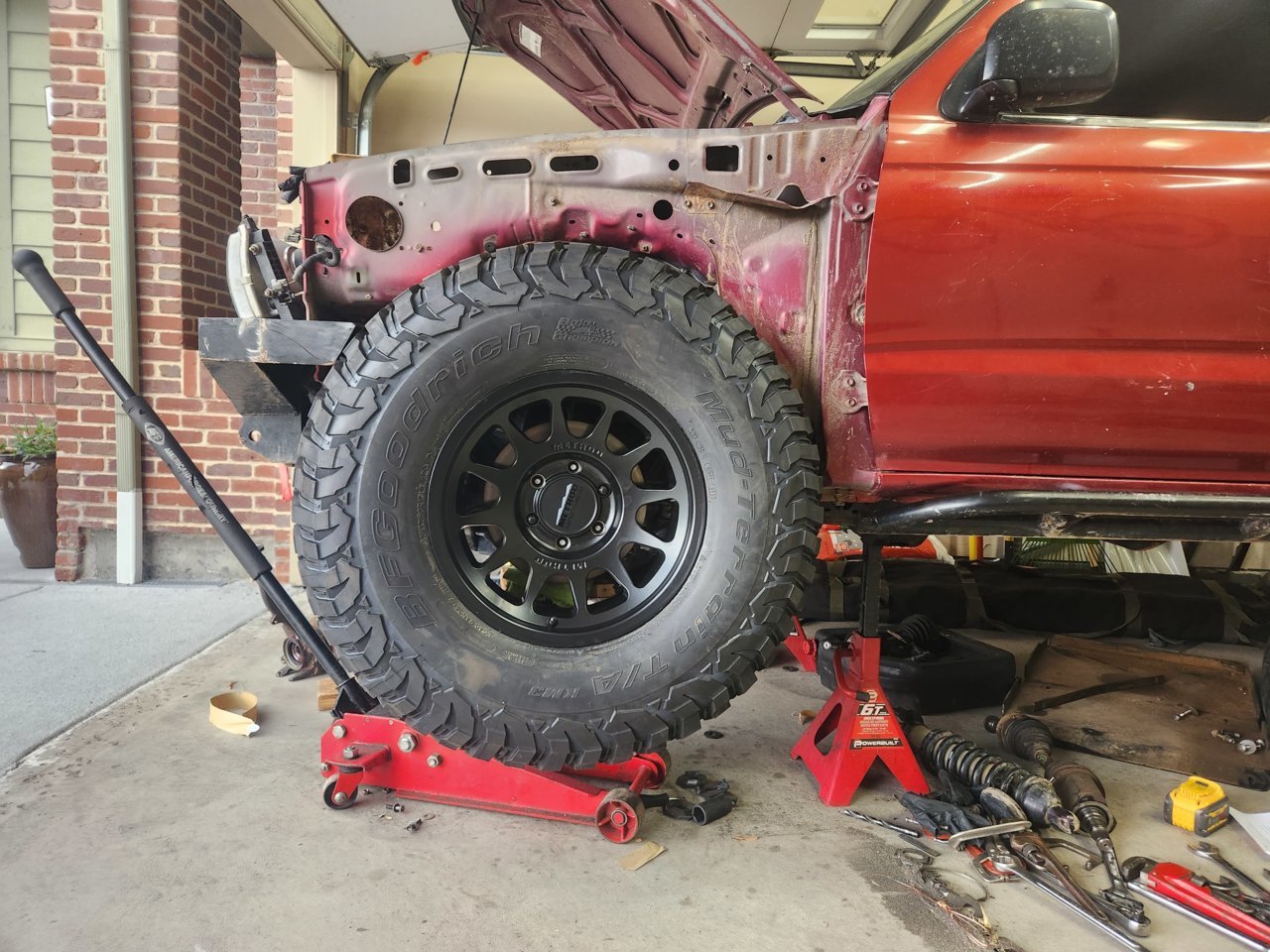

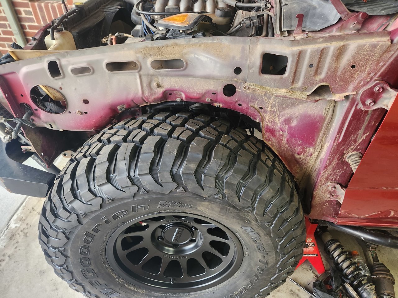

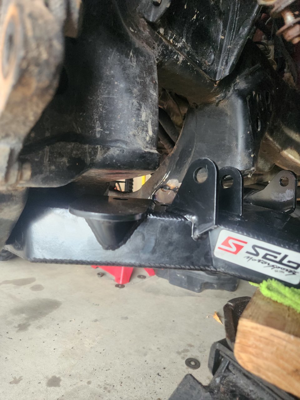

    That's the plan! She needs to be done in October for Pritchett. This is where I'm at as of now, holes cut on the driver side, the battery box is about gone.
    Here's a question- I have about 1" or so before the LCA hits the strike pad. I can't get closer than that because the gusset on the spindle hits the coil bucket of the frame. I assume I should be good at this point? 20230910_171319.jpg

    Firewall clearance looks good with those Solos!! Battery will need to be moved for sure. Looks like you're just about there for full compression, but I would want to go up just a bit more to make sure. I had to clearance my spindle gussets and edge of the coilbucket just a touch for them not to hit. Make sure you check it from lock to lock too.

    Firewall work is manageable, im hoping I can bang out everything by the end of the weekend. I do have to give props to the guys doing this with stock LCAs, that a good amount of chopping.

    It's less Tacoma and more mod
    It was a ton of work just for 35s... but I chopped a lot, so with the solos I think I'd be set for 37s.

    me too on Frank. hell i cut part of the door hinge mount lol.
    Although the MCM LT kit also pushes it forward.

    that ain't gonna work with that box in play. So problem solved. Don't get one!

    Should be, aside from all the cutting you'll have to do at the front of the inner fenders after moving things forward. :p
    It was kinda a one or the other situation, so I won't be getting one!
