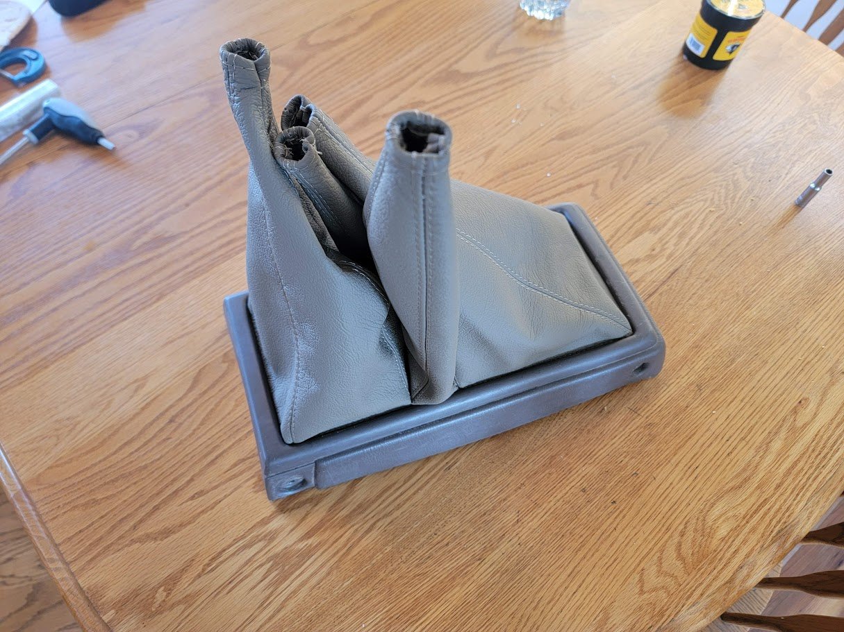

    New shifter boot from redline. Must have been a little off of my measurements, but way better than the cut up stock one.

    Nice! Really puts the finishing touch on it. I talked to redline as well, the price made me hesitate but I’ll probably go that route eventually.
    Do you mind sharing your measurements and where you think redline was off, or where the measurements should be adjusted?

    It's still a shitbox, but with a nice leather shifter boot now.

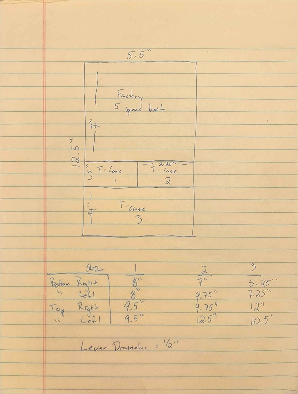

    So I sent them a overhead pic, and video of actuating the shifters, and this half ass drawing (ignore the width mistake I caught on shifter 1 and 2, as they are the same).
    They made the trans shifter to factory specs, and then I measured each shifter from all 4 corners. These were taken with the levers furthest away from each respective corner when measuring. I'm guessing I just measured these all a little too long/maybe I should've measured a little further down the lever. Everything fits quite well, it's just all 3 tcase boots seem a little long. I wonder if they added in some extra to account for the offset shifters. :notsure:
    Yes, wish the fit better like the trans shifter. I guess overall its pretty good given how cramped everything is.

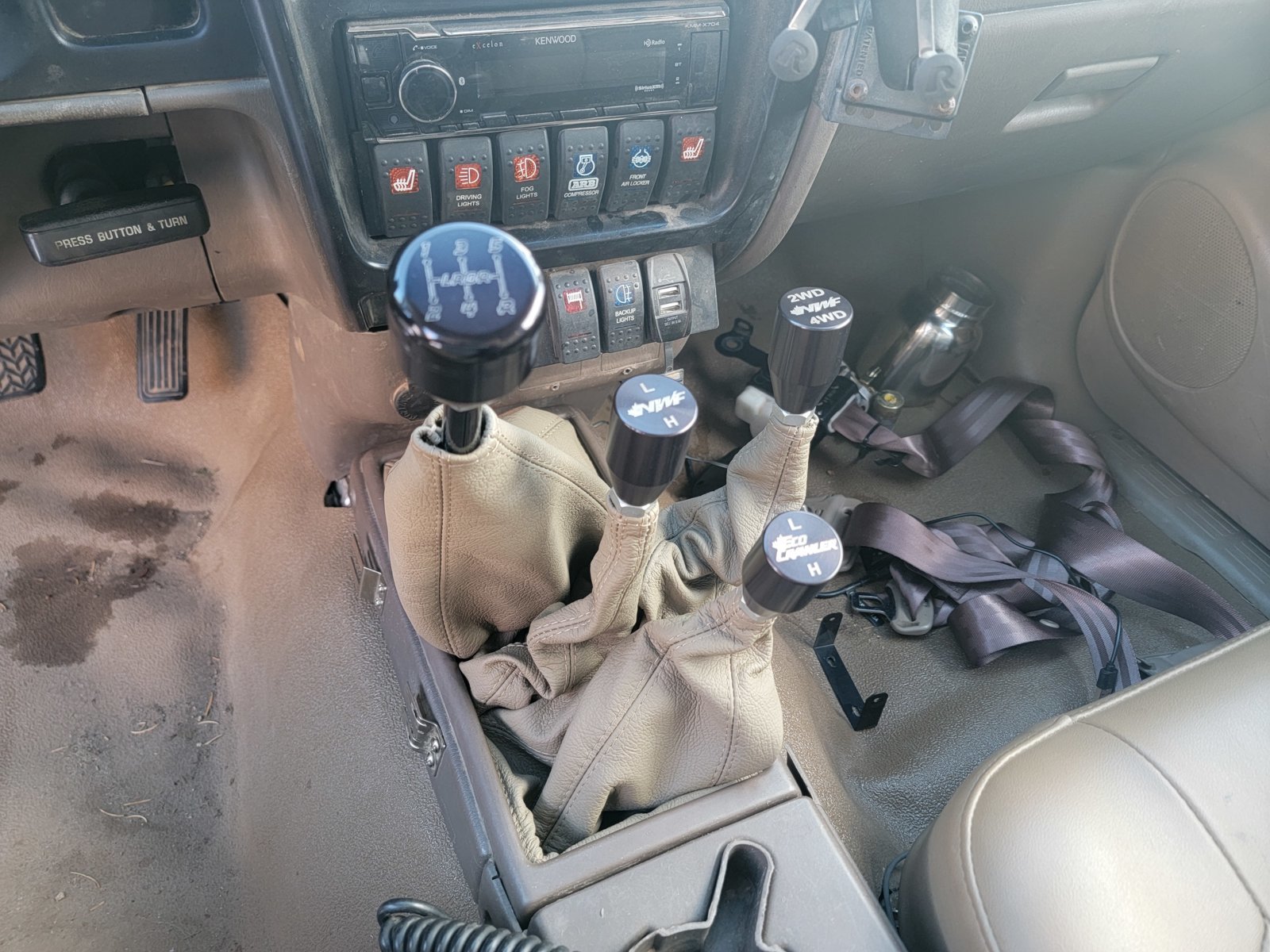

    They did better with yours than they did with mine. I had similar, but different fitment issues with my redline triple stick boot. I don't think you did anything wrong, I just don't think they properly considered the height of the individual shifters when cutting and measuring for the height of each individual section of the boot. It looks like they made them all as if they were the same height as the trans shifter, despite those shifters being several inches shorter. They realistically only need to be about half as tall.
    I actually folded the tops of each leather cone down into the boot on the tcase shifters to deal with the extra material. I also can't get mine secured to the console because the base of the opening for the tcase shift boots is to short front to back, and the shifters pull the leather away from the opening at the back. Surprised yours doesnt do that. So my $200 plus custom leather shifter boot fits like shit and just sits there in the opening not connected to the console. Personally i wouldn't use redline again, but I'd don't have a better recommendation.
    @Squeaky Penguin are those numbers at the bottom your diagonals from the corners of the console up to the base of the knobs, I assume?

    Mine fit the console well, but getting the factory metal piece in was a PITA!
    Yes, those measurements are to the base of the knobs. I figured they would get the height correct based on that. :notsure: Does look like they made them all the same height. The back one on the shorter shift lever is the worst.

    Looks like they probably took the longest measurement for each diagonal, and made that the height of the boot, which makes sense if you start from the right corner.
    I think the problem with the extra material is that they tell you to measure from the front corners of the console to the knob for the tcase shifters, but they should be having you measure the diagonal from the corners of the rear seam of the trans shifter to knobs 1 and 2, which is midway down the console. For the #3 shifter you would measure from rear seam of shifters 1 and 2.
