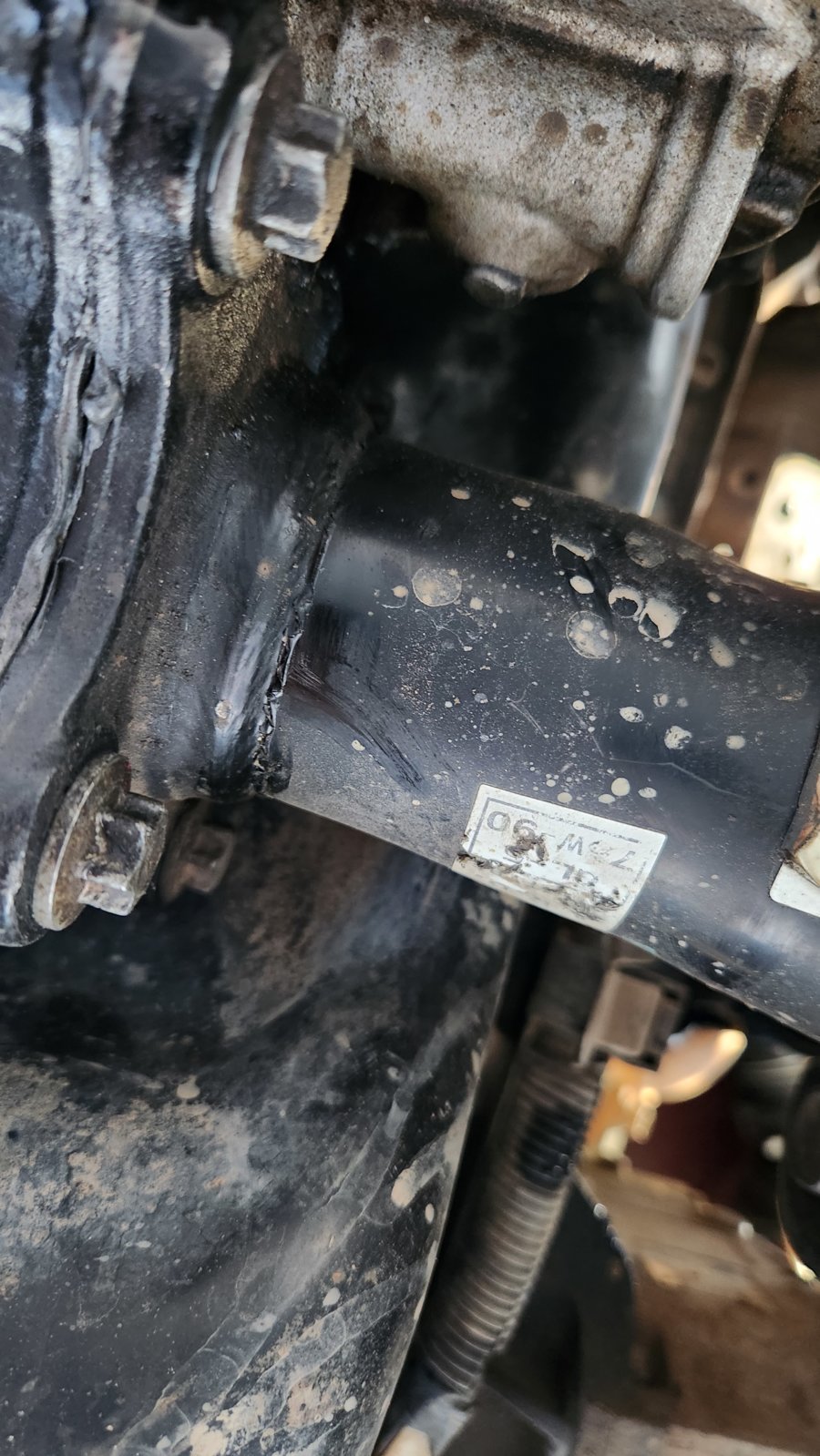

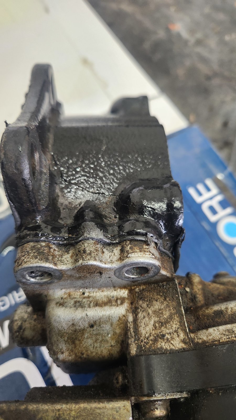

    I was ready to burn the truck to the ground.
    I'm going to dive into it this week but my ideas as of now-
    -The inner joint had slipped out of the tulip and the binding twisted the mounts upward
    - Maybe a diff drop will help? Seems that it just rolls the front forward and doesn't help the rear mount.
    - Get rid of all CVs not OEM

    So what are we looking at in the pics, anything bent?

    The L mount looked fine. The ADD tube looked liked it twisted at the weld. I'm going to try and pull it tonight to compare it to my spares. Something is definitely twisted.

    Dang. Never seen the outer tube twisted like that. Failure always seem to be from the shaft/internals.

    Is that a manual tube or an actual ADD tube? Regardless I feel like the intermediate shaft snapped and it's trying to rotate on the snapped chunk, hence separating the tube itself. Just a theory.

    Actual ADD. I'm going to try and pull it tonight and I'll report back on what the internals are like

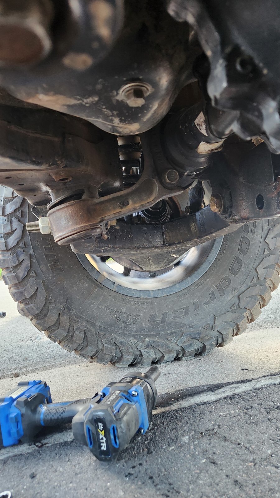

    So when you pulled the bolt the mount rotated down like that? Crazy it would've twisted that much.
    Sucks it ruined your day, bud!
    You didn't happen to check if that CV was binding previously? I've heard some do and some don't. :notsure: Don't think a diff drop would've helped much. I am curious about those CVs with a slip joint, but not sure I want to test.

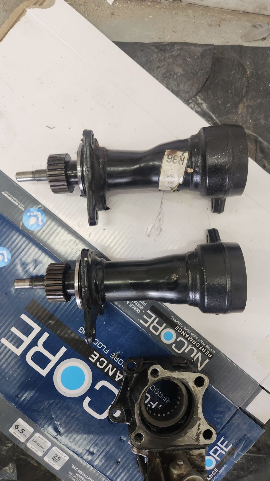

    I need to make my own thread of drama one of these days, but until then your thread seems to be a good place for it.
    Stub shaft and intermediate shaft still in one piece. The same cannot be said for the housings.
    17144336701753269060608912359221.jpg 1714433687460993585783310519949.jpg 17144337044938029463296233963862.jpg
    Still have a twist in the front. I suspect a rear mount next.

    :eek:
