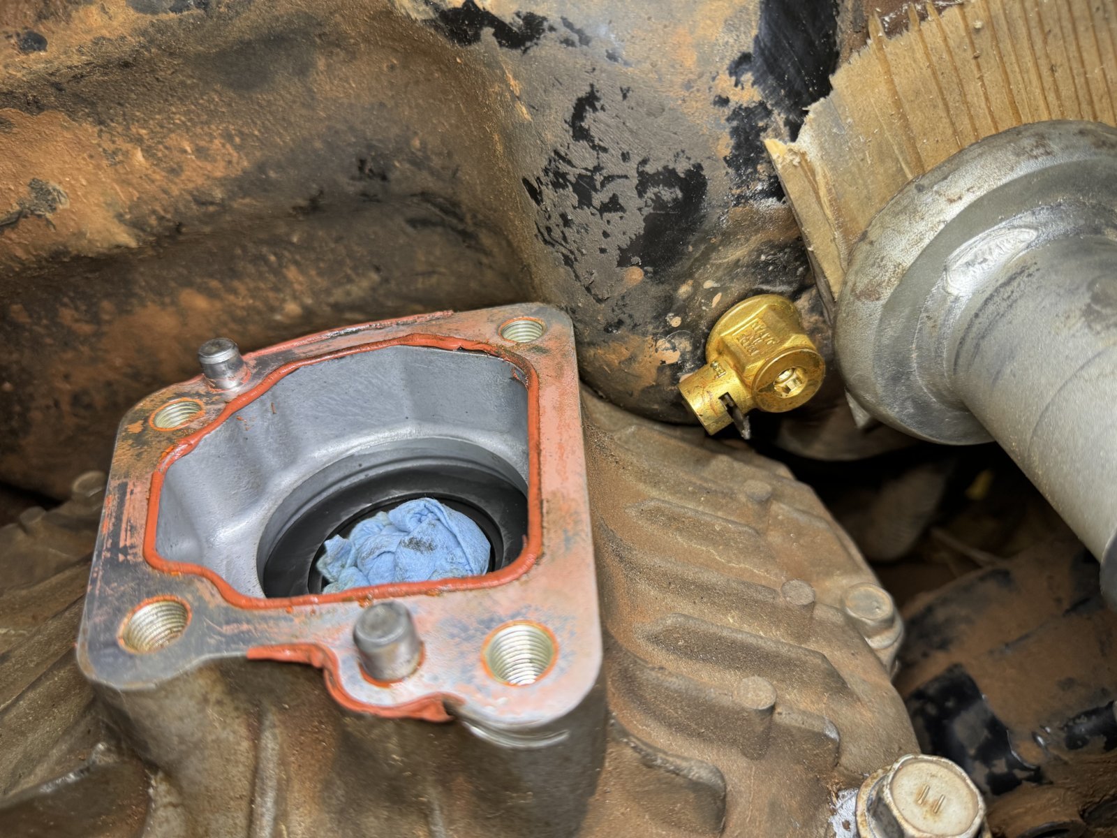

    Suprised all that happened without breaking the stub.
    My add housing cracked when the stub broke, but I think it was damage because of the stub breaking. @theesotericone bent the passenger side tube but I think it bent up?
    If you want a different spare I have a few sitting since I swapped to manual hub extensions. I haven’t broken any of those housings, but the internals still break.
    Why stop at the 8” front when you could lift the motor a couple inches and cram in a 9” haha. I think if you are doing the work it is the better option, unless you could get away without shortening the 8”

    Mine did bend up. Still have no idea how it happened since the skids where fine. It went up far enough to put a small dent in the oil pan. Then since it was rolled up my passenger CV had more droop then normal which led to me breaking 4 CV's on the Dusy Ershim. My personal record for a single trail. lol

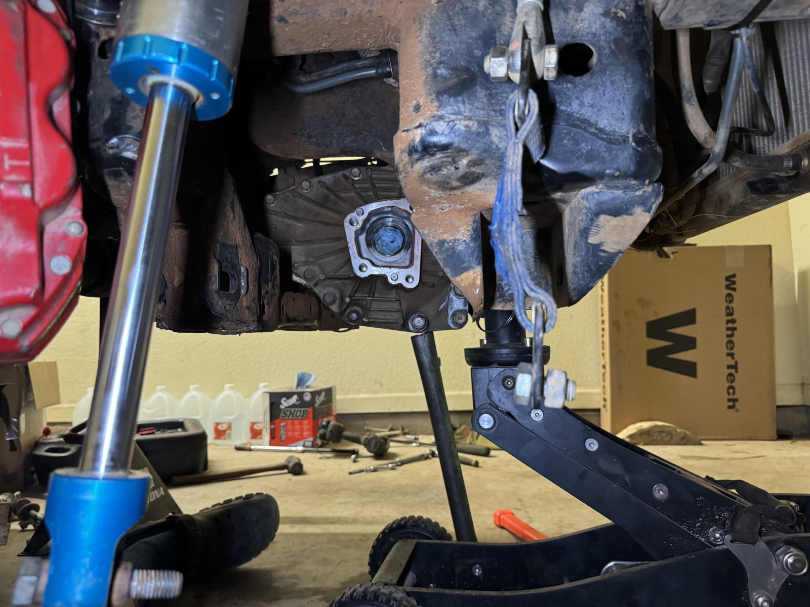

    Tundra. Just test fit it for now since I want to wheel it.
    with motor raised 1.5-2” I just need to clearance a little on the oil pan, probably doable with a hammer. And maybe a touch of grinding on the rack. Bell housing is clear which was my big thing.
    Next step is buy tundra spindles to see if I can figure out a way to adapt the lbj to work and maybe shorten them and inch or two. Really don’t want to have to fab spindles.
    passenger side shaft there seems to be just enough room to shorten and respline the add style passenger side the right length to turn it into a solid shaft, then use oem tundra cv axles with a 3.5 kit like the other guy that did the swap.

    2nd gen tundra yes. No body lift and it is close at the tunnel but doesn't hit. hood hits the intake and TB but trimming the webbing out could make it work.
    I think keeping the oem tundra cvs would be nice since they seem stout, if it doesnt work them go to RCVs
    or figure out what insane price RCV would charge to make me a tundra size inner spline with a cup that will fit the cv joint on my current RCVs
