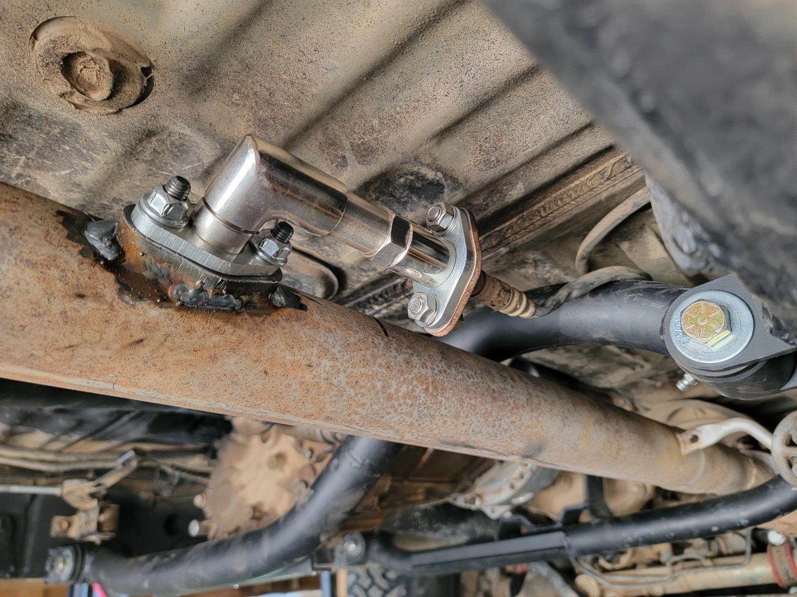

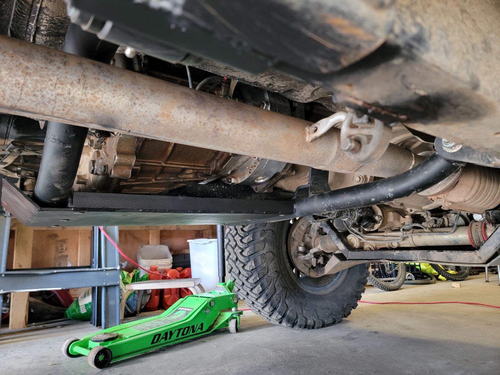

    Well, I tried to make it all in one go, but I'm not good enough at bending. The joint is sleeved with some 1.5" tubing.
    Anyways, All wrapped up today.
    Would've liked to get the drivers side mount higher, but didn't want to completely redo the ebrake bracket. As is I had to flip it over and modify the spring.
    Also, finally did something with the rear o2 sensor that's been stuffed up under the heat shield for the last 2 years.

    Nice, but why not just get rid of the O2 if it hasn't been doing anything :rofl:

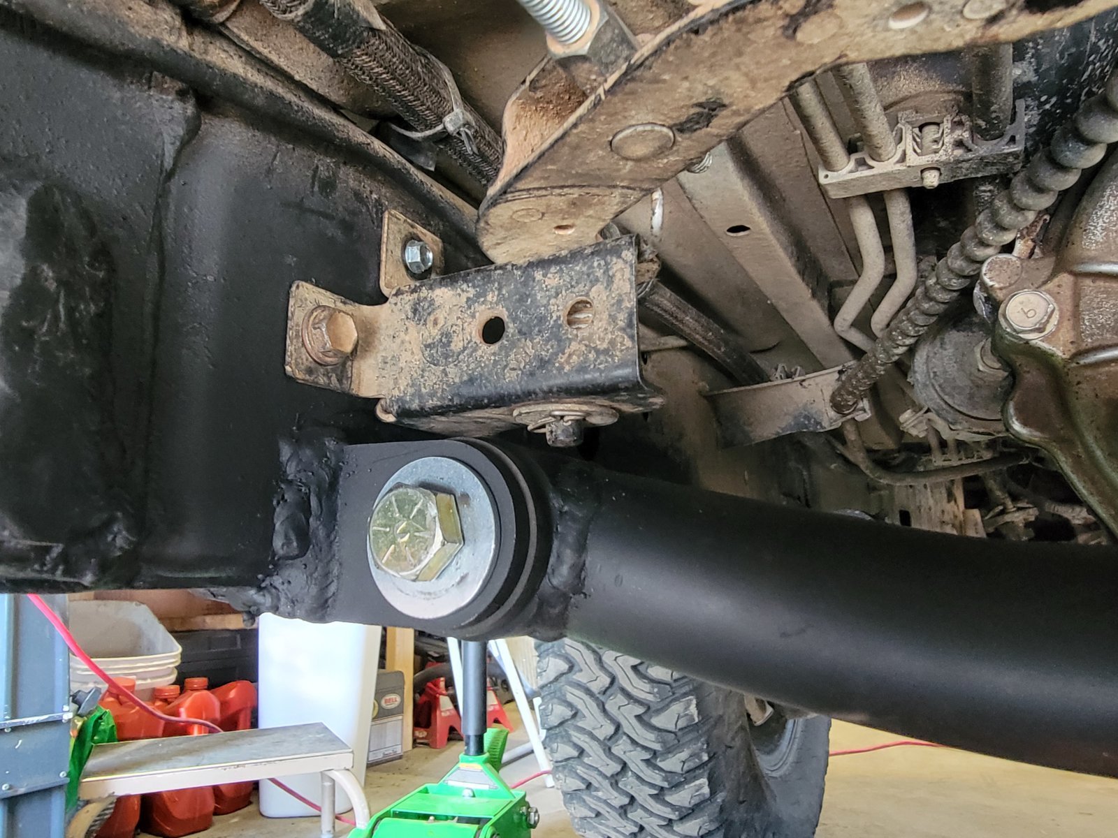

    Did you use bushing joints for the connections to the frame tie ins? Or solid? Got pics?

    I don't want a constant CEL, and this seemed easier than a simulator. Hopefully...
    These plus whatever tabs work.
    https://www.tmrcustoms.com/products/poly-bushing-dom-housing-assembly

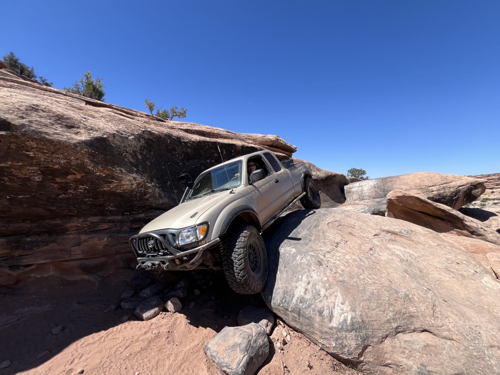

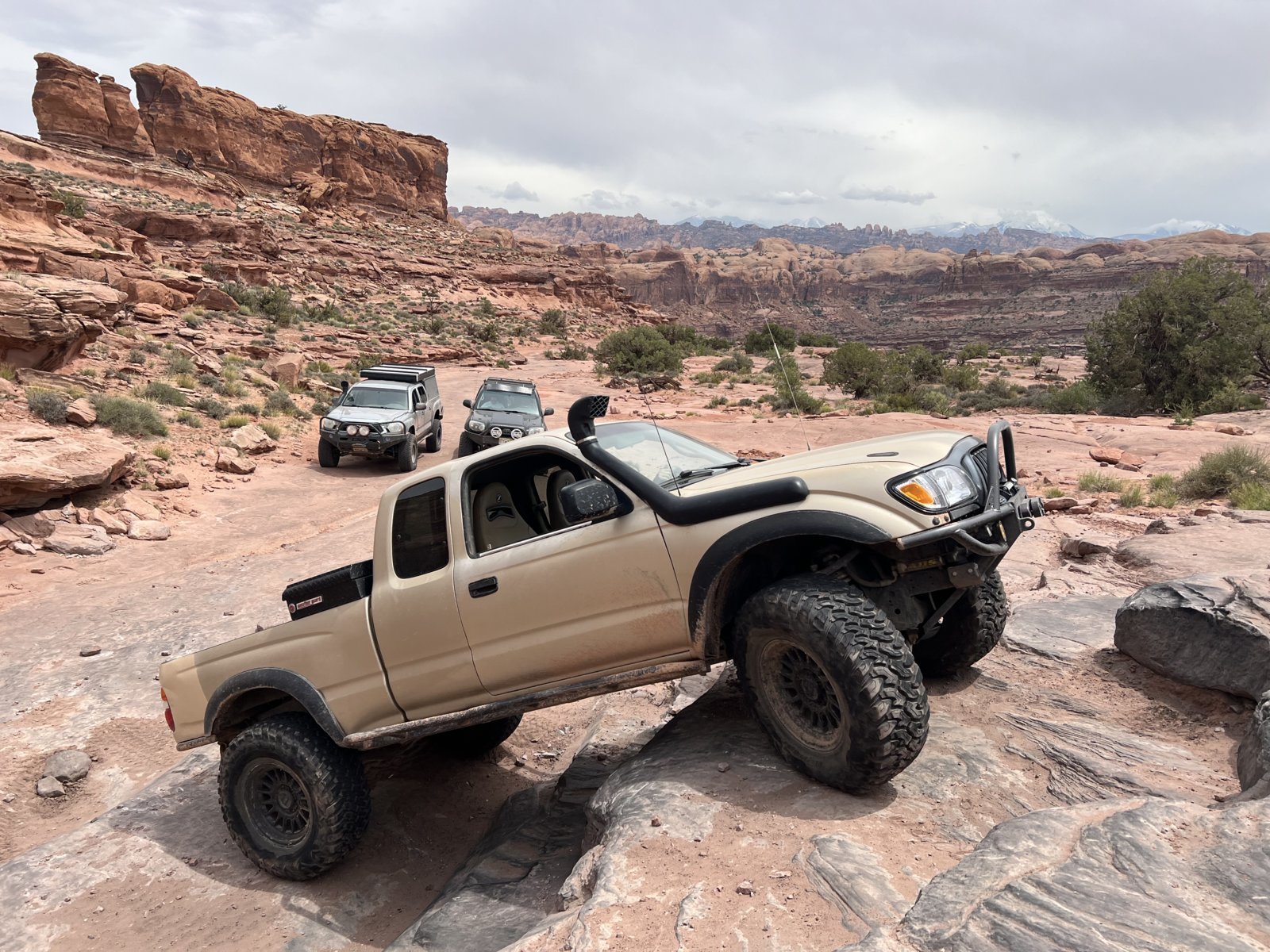

    Very pleased with how the shitbox performed in Moab. Ran Wipeout Hill-The Pickle, Cliffhanger, Rusty Nail-Goldbar, Hells, and Poison Spider. One broken CV trying a big optional ledge that I probably had no business on. Also realized I have a shit ton of axle-wrap going on, so need to decide what to do about that. But otherwise cruised through some very difficult trails, and drove home without issue.

    They're an old set of Deaver J59s. The truck is working really well so I kinda don't want to mess with it too much.
    I noticed some vibes when the truck is under a lot of load going up a steep obstacle. I suspect it's the ujoint operating at a severe angle. :notsure:
    Then I let @Reh5108 drive it up a super steep ledge and watched the pinion rotate up a shit ton, and the leafs between the hanger and axle bend upwards.
