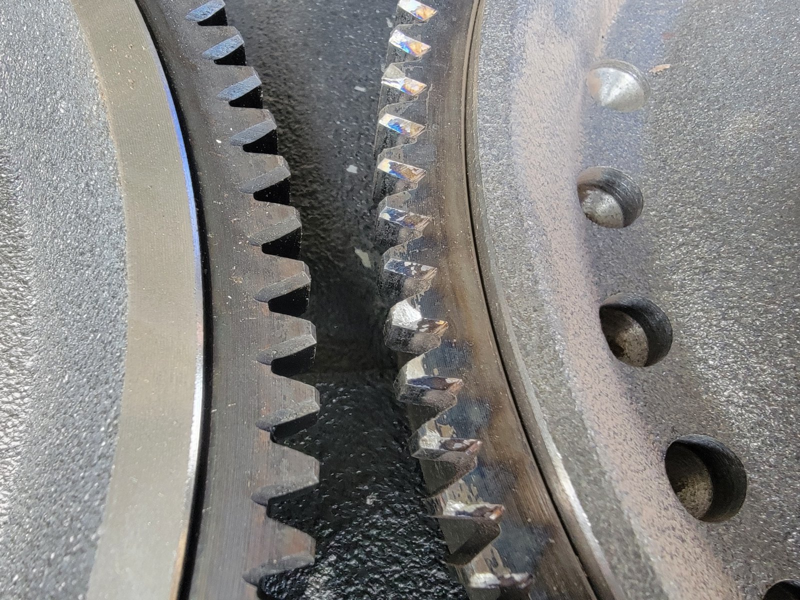

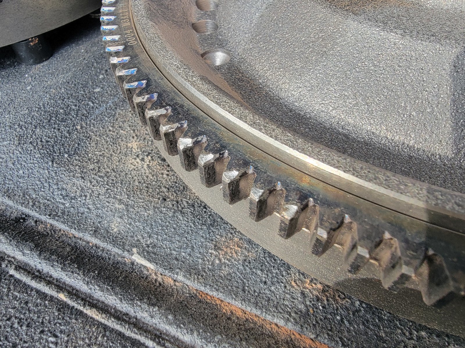

    Gotta love doing very labor-intensive jobs twice. Hopefully the Luk doesn't give me any issues like the Exedy.

    Damn, so it was doing exactly what you thought. Is that old different dimensions somehow? Or was it not engaging the starter correctly and not plunging into the teeth?
