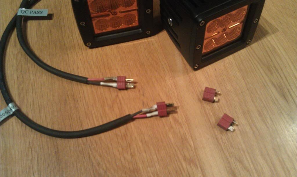

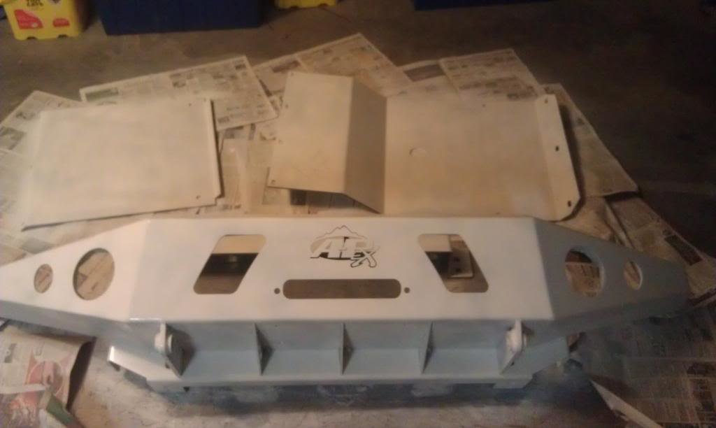

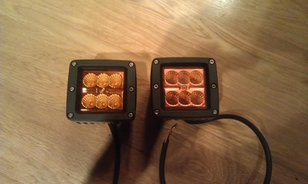

    Couple cans of primer down:
    Also, used a few of these Deans plugs I had laying around from another hobby. Want to make it as easy a possible to remove the bumper if I have to (i.e. installing a winch.....)
    And a crappy pic of my new switch setup. With a little work I was able to get the lower lights to turn on with the dash lights and dim properly:

    Which wire did you tap into for the lower light positive only when your dash lights are on?

    In order to get it to work, I pulled both the positive and ground straight from the dimmer. It would not work with a common ground between the switch. I would have to take apart my dash again to tell you exactly which wires they were, but there are 3 wires comming from the back of the dimmer, and a combination of two of them made it work.
    I do guess and check wiring....:D

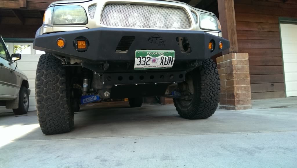

    A couple pics I took tonight. I'll try to get some actual pics of the bumper tomorrow.

    A quick front shot. I promise I'll get some better ones. Also, I took before hub to fender measurements, I'll get some after measurements when I get the skids on.

    Uhh, what do you have my bumper? That is my bumper? Why did they ship it to you? Yeah, hint hint, I like your bumper haha.

    much better :thumbsup:
    dig the amber LEDs too!

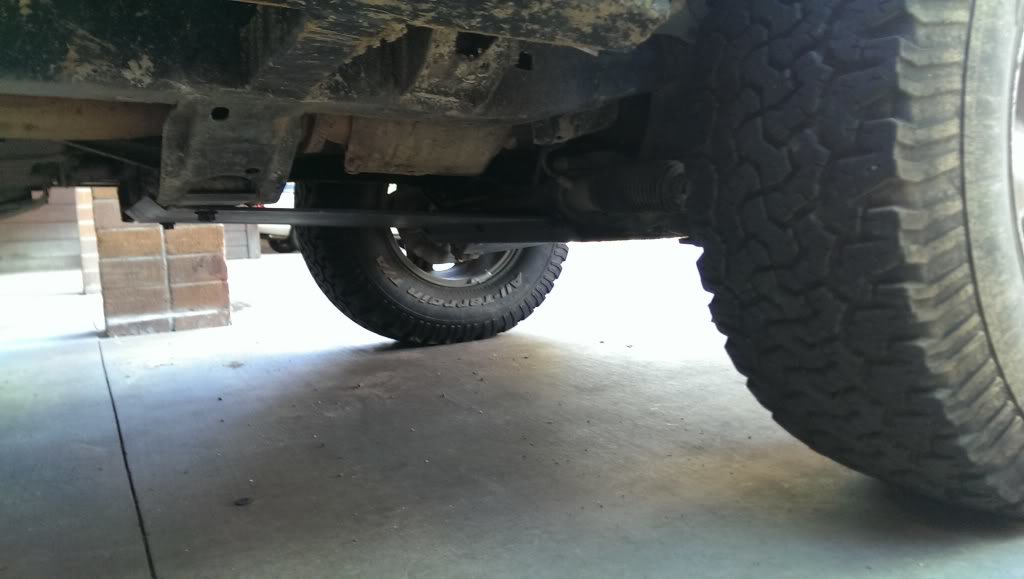

    Got the skid plates installed this morning. Can't wait to test them out!
    Gotta say I'm impressed with the 881's. To be as fair as possible, the before measurments were taken with a full tank of gas, and the after with about a third. I don't know how much this affects the front, but who knows....
    Before Hub to Fender:
    Driver: 22 5/8"
    Passanger: 22 3/4"
    After:
    Driver: 22 1/2"
    Passanger: 22 5/8"
