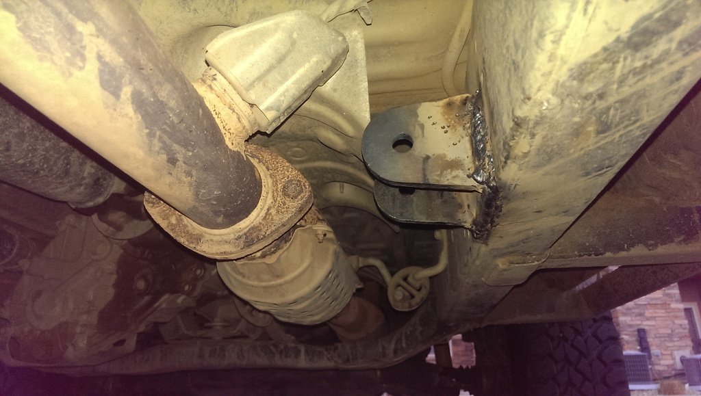

    Anyways, big thanks to Ray today for helping me start in on the mid skid project. Was going pretty smooth, until we found a bit of an oversight on my behalf. With where I positioned the Ruff Stuff brackets, there was not enough room for the 2x2 tubing. Of course we realized this after we had the other piece cut perfect and tacked. Oh well, need to pick up some 1x2 and start over.

    Are those mounts for a custom crossmember?

    Yes, we were most of the way into the custom crossmember using 2x2" .25 wall.
    i.e. it wouldn't bend. :p

    Yessir. Tip #1: don't place the mounts directly in line with the flange on the exhaust. Tip #2: a 48" piece of steel is not enough to go from the IFS skid past that flange on the exahust.

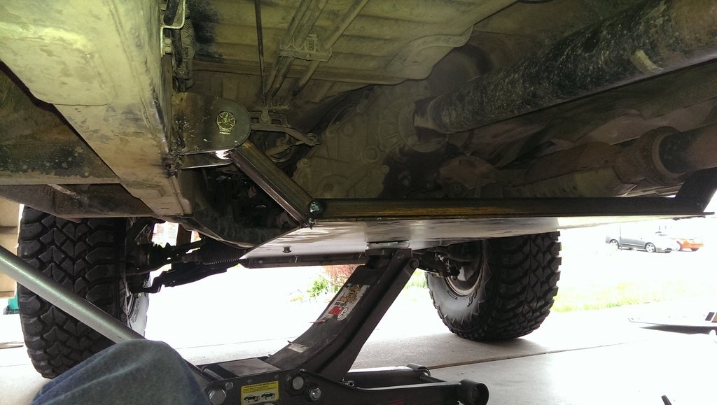

    Made some progress on the mid skid yesterday.
    Played around on a loading ramp yesterday and determined I need to follow your advice and go buy some nylon lock nuts for the shackles. At full droop without the shocks, I could stand on the tire and get a little more droop out of it, because it's binding in the shackle. So, I'll go pickup those nylocks and tighten them up and loosen a half turn or so.

    Looks good Brett. I guess now I can move forward with my jack stands now that you don't need that longer piece of 2x2 anymore. Im glad it worked out for ya.
