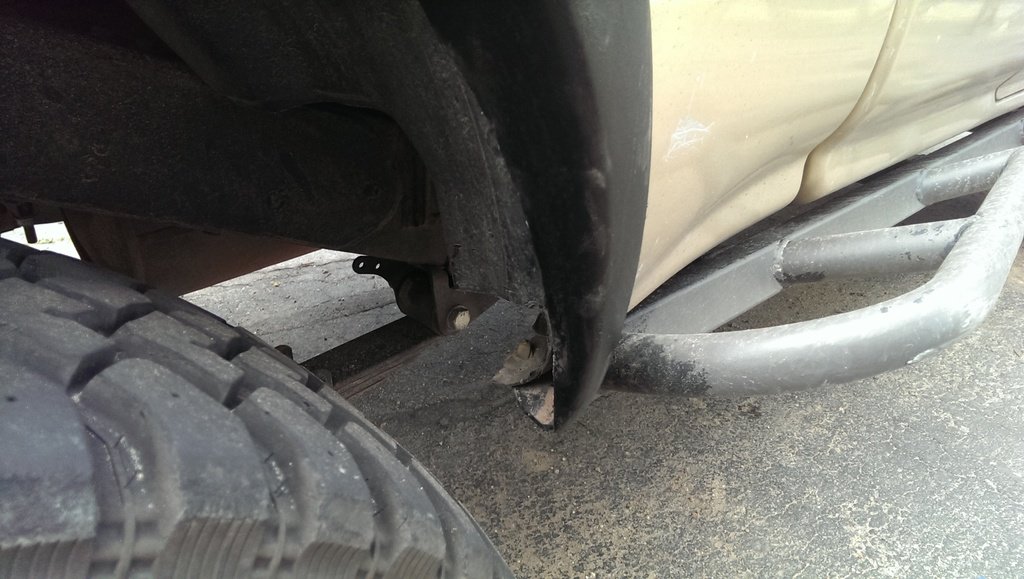

    At the end of my week in Moab, I was really tired of hearing my tires digging into my fenders, and extending bump stops seems like a terrible solution to that problem. So, out comes the grinder and the BFH. Lost a bit of sheet metal on the front of the rear wheel wells, as well as the back of the fronts, along with some more of the fender flares. Picked up a tube of seam sealer, so I'm going to clean up any excessive metal in the firewall area, and then will be going to town with the hammer, and seal it all up. If I can't get rid of a lot of the rubbing, I may look more seriously into tubbing. Would be nice to not have any rubbing, and the possibility to move up to 35s at some point in the future.

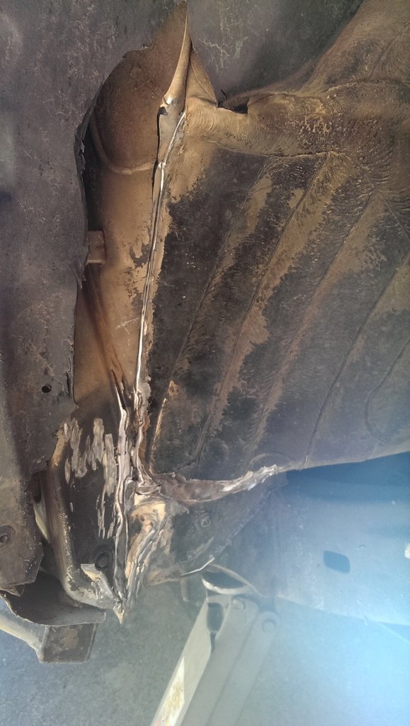

    I think I gained myself quit a bit more firewall clearance today.
    So, here's what my firewall's looked like before hand:

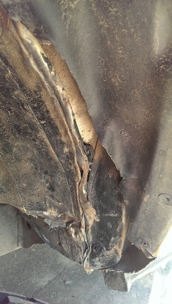

    Hacked off all the flaps of folded over metal I could, smashed it back quite a ways more, and then hit everything with a flap disk:

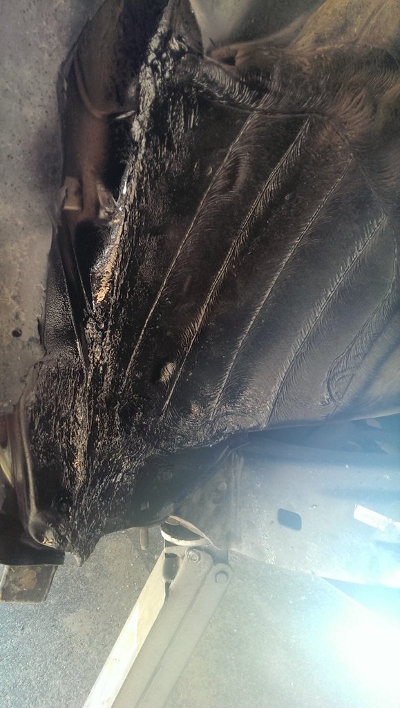

    Seam sealer to smooth and seal everything off, and a quick coat of paint:
    And what I took out of the front of the rear wheel well:
    We'll see how much rubbing I still have.

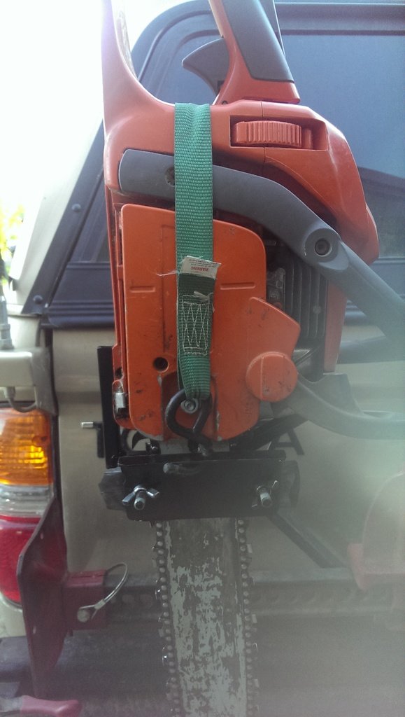

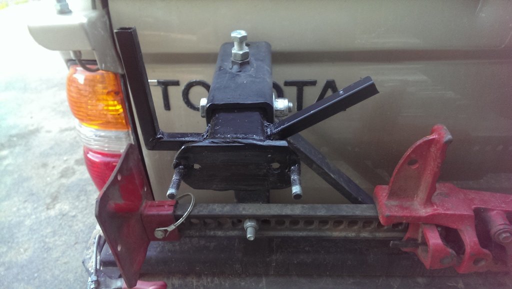

    Made use of what was left of my rotopax mount, some random hardware, some inner tube, some scrap steel, and my Brother's 110V HF welder to made a quick chainsaw mount for my swingout. Needs some modifications and some paint.
    Then went and tested it by doing what I do best trying to get stuck in a snow bank. Didn't succeed at getting stuck, but did clear a dozen or so trees from the trail.

    Chainsaw mount, now that is pretty sick. :thumbsup:

    Better pics of your shitty welds and this contraption please.

    X2. Was looking at a chain saw today. Curious to see how much Gorilla glue you used.

    Didn't grab any pictures of the mount itself. Really quite simple, and made a 60 mile trip with it yesterday with 10 or so miles of dirt and pulled it off a dozen times with no issues. Most the weight of the saw sits on the 2x2 and receiver tubing that was already there. The only structural thing I welded was two bolts, the bar sits between them and a plate captures it with some wing nuts. A cam-lock strap finished it off. Similar in concept to a mount I use with the dirt bikes.
    No gorilla glue, that probably costs more than the HF welder after some coupons anyways.

    Looks pretty sweet hanging off the back there, with that being said, I will only ever run it when I know I need it. Love the simple receiver tube setup on the swingout.

    Added some side support, shitty welds and all:

    Looks good, other than the welds. Haha. I will have to take a good look at it when I am up there this weekend.
