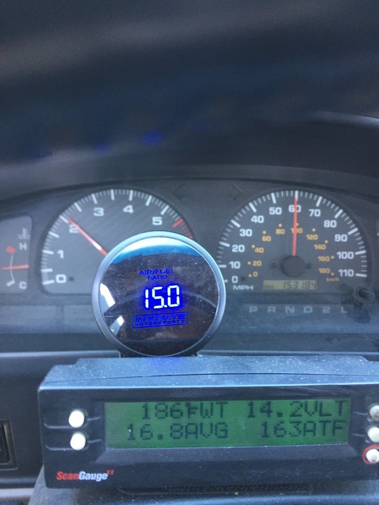

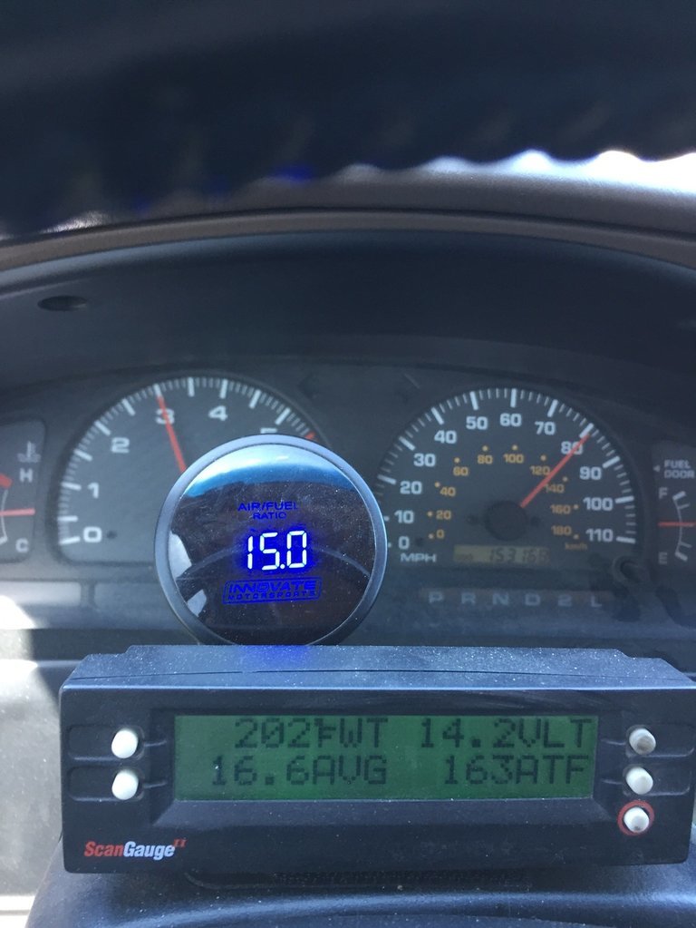

    I've got some real life experience here maybe shed some insight. I think you've seen my truck. I have 2000 4Runner auto with J shift, ecgs and ZUK built 4.88's and front locker. Currently am running 285 st maxx but I had a set of 295 hankook dynapros MTs like you. I do have a SC so there's a small difference there. Oh and my truck had come with 4.30's.
    Now with the 285 and these gears the truck runs great. I can't burn out on pavement but I don't ever try to, it's not happening at 6500 feet. When heading into the hills, I can easily maintain speed go over the speed limit 10-20 if I want. I click the overdrive off and let her sit right at 3000 rpms and 60mph up the hill she goes. Engine temp will sit at 190 and the atf 150-165. If I stab it and the sc kicks in the afr will drop and then your passing ppl going uphill in a loaded 4Runner. When I'm out on the open road with the OD off it will sit at 3000 rpms and 80mph.
    Overdrive on-if I turn it off rpms will jump 1000.
    Overdrive on-running a little hot b4 all new cooling system.
    image_347_9d3f4bba4791c24e5df574e09660742a77ba8959.jpge
    In 4 low it is very noticeable as well. I can get out of the truck and walk next to it. Not through an obstacle or anything like that. Big improvement ofroad as well.
    When I had the 295's, I never wheeled with them except one snow day. The tires were ok but made a noticeable change in the way the truck accelerated and felt. I knew right away that I would be sticking with 33's having 4.88's. I feel they are perfect for that tire size and make the truck a joy to drive. If I had 5.29's then I would be wanting the 35's. To me though after all the wheeling I have done, not once have I not made a run or an obstacle bc of 33vs35 when a equal truck w/ larger tires did.

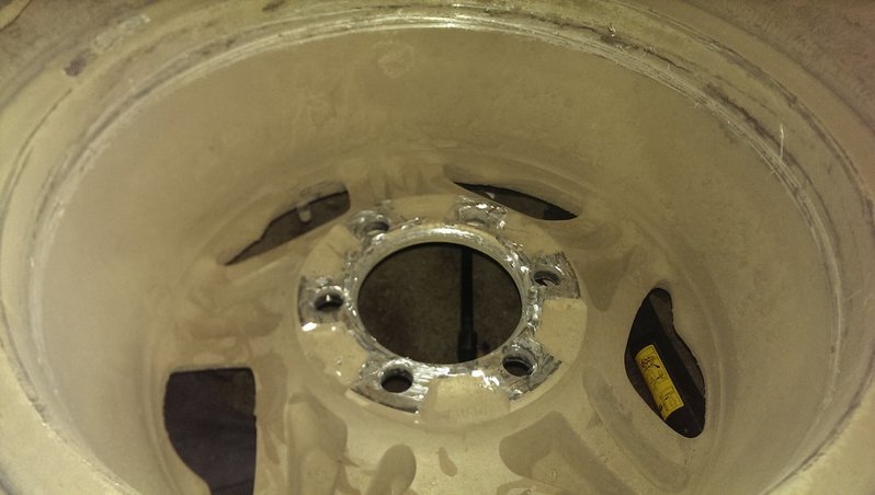

    Was doing a tire rotation due to bad wear, so was just moving tires around in no real pattern. Started by breaking the lugs on the rear axle, and putting it on jack stands, but ended up only swapping one of the rear tires. Forgot to tighten the lugs on the one I didn't touch. Had a slight new vibration that I attributed to the poorly worn mud tire I moved to the rear. Like 3 miles later the lugs decided to leave the truck and the wheel came off the studs. Miraculously, the wheel did not fall off completely, but rode on the drum while I pulled over. This is what caused the damage to the wheel. No damage to the studs, found 4 out of 6 lugs on the road, and also lost the center cap. I think the wheel is OK.
    Live and learn. I've always said the hardest way to learn is the best. Now I know the vibration you get when lugs aren't tight. It was a bit disconcerting though when the wheel hops off the lugs.

    ^^^ yeah I was looking at the scratch marks on the wheel making me trying to figure out what happened and just thought to ask. From the sound of it. It could of been worse and I'm glad it wasn't. We all try to over think projects and get distracted it's just one of those things. Don't be to hard on yourself. Just a simple lesson learned. Glad you and the truck is ok. :thumbsup:
