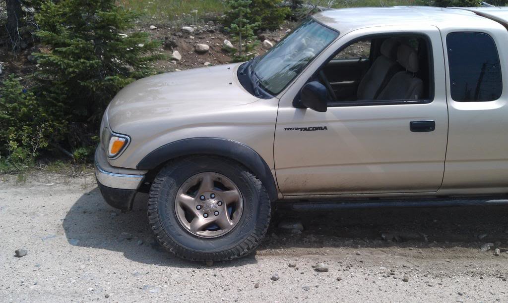

    Thanks man! I don't beat myself up about it, but my brother was riding along and hasn't missed any opportunity yet to give me a hard time about it. Those stupid mistake will get you....
    Story of my life. In the meantime, I'm hoping my luck won't catch up to me or I can learn not to repeat such stupid mistakes. I was going like 35mph, no traffic, big shoulder, I am still incredibly baffled that the wheel didn't come completely off. Especially because it was the left tire, going around a right corner, and pulling off to the right.
    Had this one happened going down the interstate at 75mph my truck might have been totaled 2 years ago.
    Again, all my fault.
    You saying such a stupid mistake could only be brought on by a woman?
    Unfortunately, this one is all me.

    Bolts. Lost two, sheared the other two. Fixed it there and drove home. Not without leaving my mark in the road though!

    :eek: that sucks! At least it didnt do too much damage! Actually just checked the torque on my front suspension today for that very reason!

    I really don't consider it a problem. Replace LBJs with OEM every once in a while, replace bolts with OEM while you're at it. Loctite the bolts, torque them properly, and paint pen them so you can tell if they moved. Like I said loosing the bolts was my fault, similar to how Monte loosing his LBJs more than once was all his :p
    In all seriousness Monte, having a ball joint fail and not replacing the other side was a dumber mistake than me not tightening lug nuts... :luvya:
