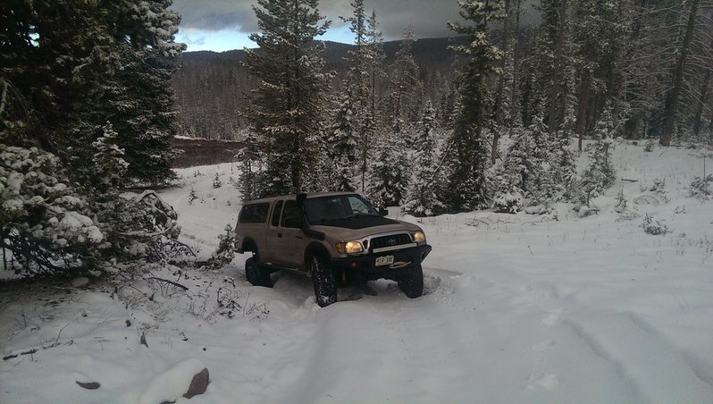

    Truck is driving great after an alignment, still didn't manage even 1 degree of caster though. Oh well, Feels better than it has in a long time.
    Also got a really good deal on a set of 265/75 Dynapro ATMs to run this winter, and tested them out a bit today. Look a little small and goofy, but not bad.

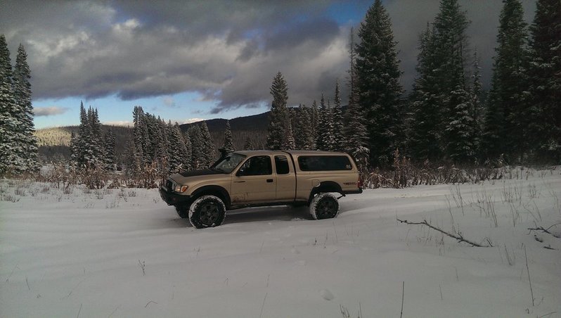

    Are those 295/75's in the first pic of your OP?
  16. Nov 17, 2015 at 8:55 PM
    #896
    Squeaky Penguin
    Squeaky Penguin [OP] Nothing Ventured, Nothing Gained
    Apr 5, 2012
    #76340
    10,082
    Brett
    Steamboat Springs, Colorado
    '01 4WD, SR5, TRD & '13 TRDOR AC
    Lots of dust and custom dents, Check Build
    This picture?
    Yes, those are my 295/75s
