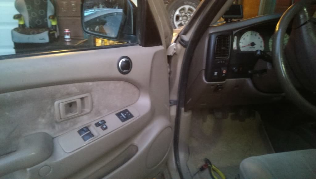

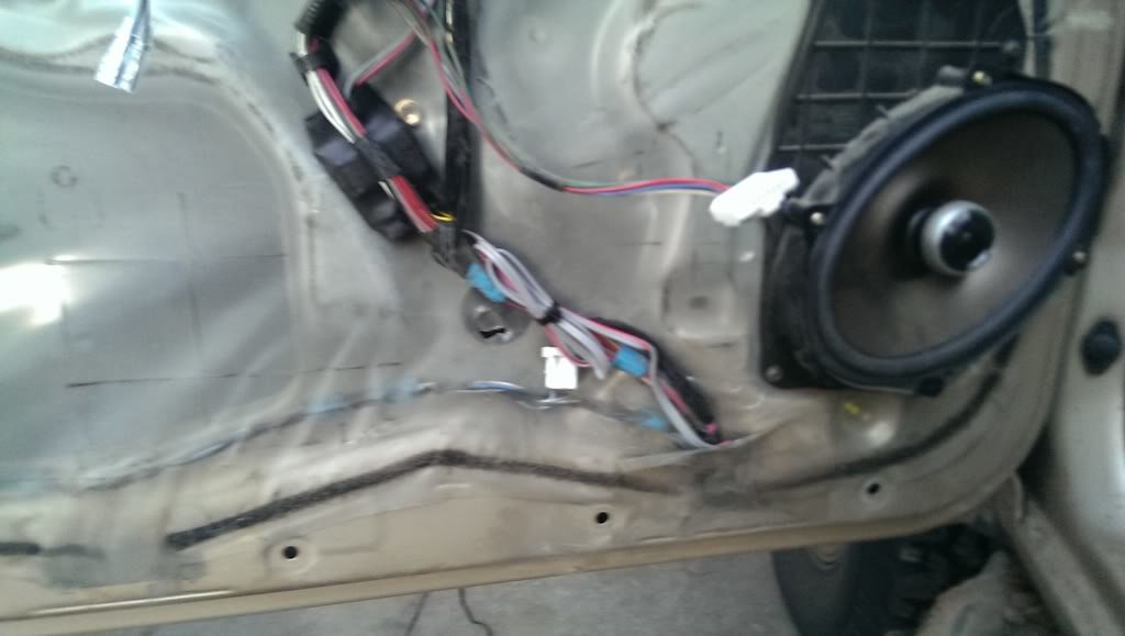

    Tweeters installed. Too lazy to improvise a snazzy mounting bracket, so I just flush mounted them. The little shell thing they include actually fits perfect in the hole with no trimming, meaning I can possibly change it in the future if I want the stock cover.
    My super delux wiring:
    And how it looks:

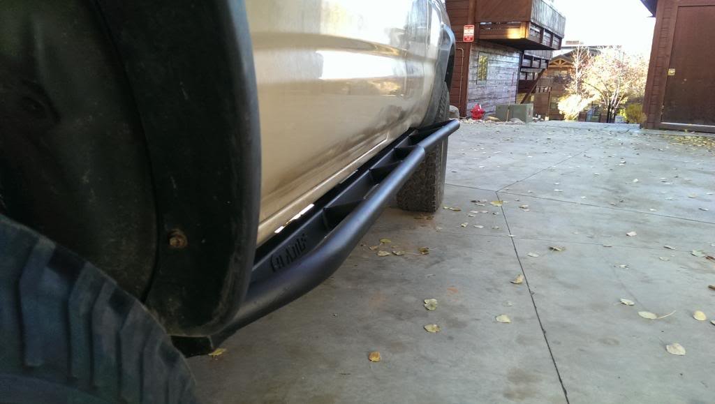

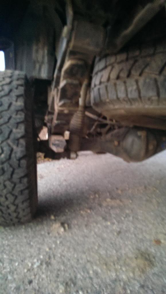

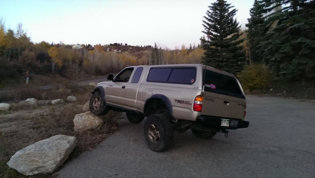

    Did some touch up painting on the skids and sliders today. While doing that, I decided to do my rear bumper too. I don't hate chrome like everyone else on here does, but it just looked a little out of place after the front bumper.
    Mall crawling pic for the rear bumper:
    Also started to make me wonder if I'm beginning to push the 5100's length wise:

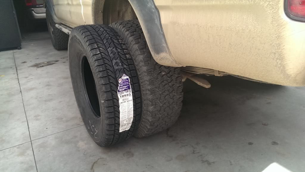

    After a bunch of time searching craigslist, I got an amazing deal today on a brand new set of 245/75/16 BFG Winter Slalom's today. I'm thinking the perfect size for a winter tire would've been 235/85, but I got the set for $400 + a 3.5 hour round trip drive to Meeker. Hopefully will be able to get them mounted on my set of 2nd Gen TRD OR's this week and toss them on. Great timing being were up to about 6" of snow tonight :eek:
    They look a little small though:

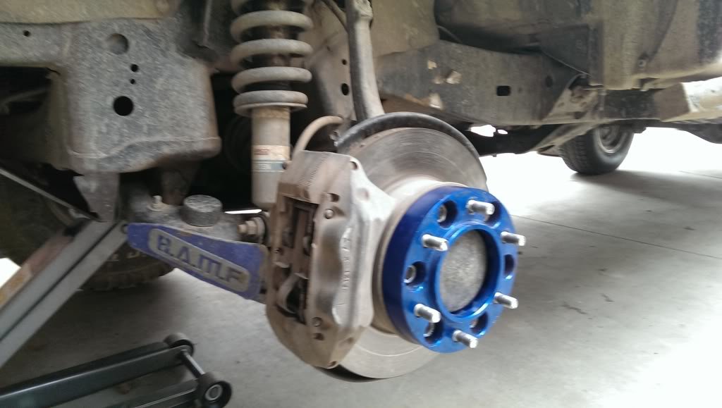

    Set of 4 spidertrax spacers went on today to help with rubbing issues with my BFG ATs, and make my winter tires look less goofy.
    Good thing I never took a picture of the truck with the little tires on the 2nd TRD ORs and no spacers. Looked goofy as hell. Summer tires back on for the last wheeling trip of the season tomorrow, and then going right back to the winter set.

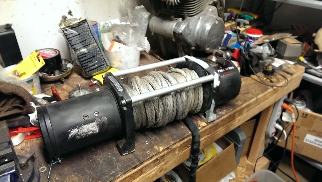

    Got this today. Used XRC10 w/synthetic line. It came with extendent power lines to mount the solenoid under the hood, and wiring to mount a permanent switch. Gonna be spending some time cleaning it up before it goes in the truck.

    Id look into tearing it down and repacking it with grease. Think its common that the grease from the factory for these isn't great..
    i have an XRC8 and has worked great so far. guy before me repacked it.

    Already pulled the drum, and the grease is as tacky as hell. I plan on cleaning it the best I can, repacking it with good grease, and making sure its sealed up nice.

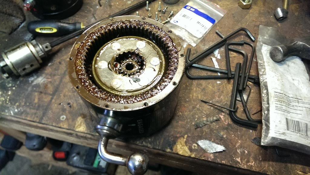

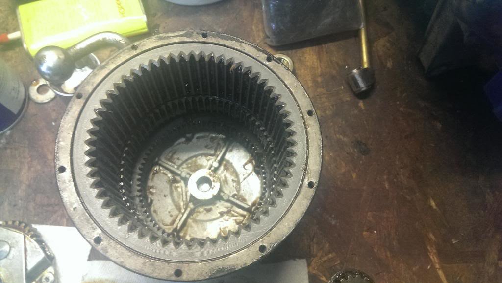

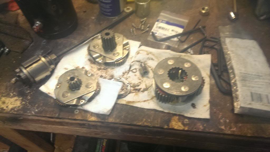

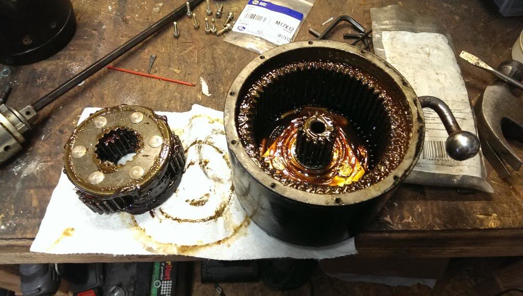

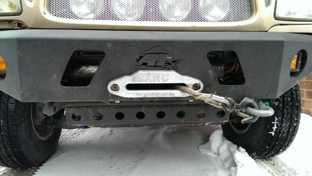

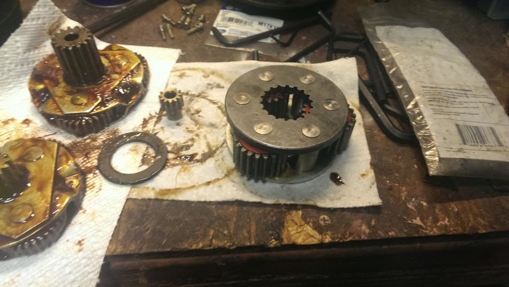

    Spent the weekend cleaning up and installing my winch.
    Started off by opening up and cleaning all of the synthetic line.
    Then it was off into the all the gears. Glad I did, that grease was in need of replacement.
    One Clean
    All cleaned up:
    As good as I felt like getting this:
    And installed:
    Slashaar likes this.
