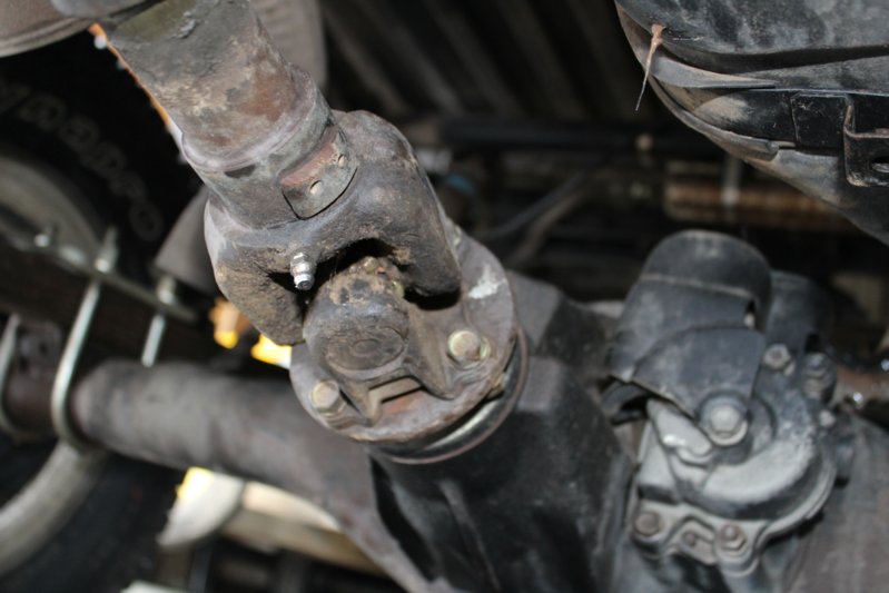

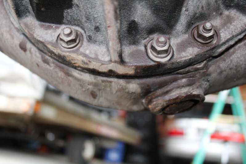

    So, while it Moab I hit my diff once on Kane Creek. Forgot to check it until the next morning, and of course, the plug was finger tight and I had lost 1/4 quart of diff fluid. So, before I really forget to check it one of these times and blow up my diff, I finally got around to doing something about it. My solution cost less than $1. Just need to weld up around the plug when I have access to a better welder and it isn't 20 degrees, but this should prevent it from happening most of the time, and will provide a nice sacrificial piece to grind down for a few years to come.
    What I started with:
    Little diff slider:
    Cut a second one and thought about adding it, but don't know that it's necessary.
    Also replaced the slip joint zerk for like the 3rd time and greased it. Need to find a better solution to this as it's just too vulnerable.

    4.88's will solve that, your driveshaft will have a different rotation to it and as such the zerk will always be at the optimal position for clearance. :thumbsup:

    Throw some needle zerk fittings in there. You'll also need a needle grease fitting for your gun, but they shouldn't get ripped out as easily.

    That's the only zerk that's exposed on my driveshaft. Unlike the 2nd gens that have the zerk on the end of the U Joints, all my other zerks are recessed in the joints. I could go with a needle setup, but seems like it would be a bit of a pain for one zerk.

    Are you looking for to the length thus exposure of the zerk? I replaced my zerk with a bolt. It's slightly lower profile and in addition to my low profile gas tank skid it no longer rips off.

    Bolt could work. I'd be pissed when I drag one against a rock and round it out though. The only good thing about zerks is that they're really easy to drill out. Should just grab some extras for the time being. Need to fab a gas tank skid too. Hit it a few times this past year, although never enough to dent it again.
    And yeah, that's like the 4th or 5th time I've caught it leaking after hitting a rock. I'm quite lucky I haven't lost the plug completely. Needed to do something about it before I do.
