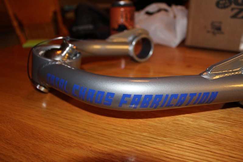

    Just got these in. Really excited even though I won't be putting them on for a bit.
    Going to hold off installing them until I get my other set of spindles ready. They already have the ball joints removed, just have to weld up the gussets and press the slug adapter in. Also thinking about picking up a set of coil bucket gussets to install at the same time for the hell of it. @Wishbone Runner going to have to spend a weekend in your garage this spring.
    Also got Wheelers superbumps for both the front and rear, and some wheelers front brake lines. Parts pile is growing properly now. :cool:

    ^^^^ NICE!!!!:)

    :jellydance: I don't have decals on my uppers.

    So I thought you were not going to get uniball uppers because colorado is so rough on joints. But any ways I like the growing list. I got a second set of spindles on their way here.

    What are you Jelly about with your LT? Although, those stickers are probably good for 5hp or so.
    At this point, it's a price I'm willing to pay for performance. I'll probably have to learn how to swap uniballs soon though.

    I really like the contrast of the blue decals on the uppers.For some reason TC doesn't put decals on the LT kit.:notsure: But hey I still like the boxed lowers.

    Maybe using the right lubricant will extend the life? :luvya:
    At least I'll have advice from a uniball changing expert when I need to swap them.
    Keep in mind there's other issues you'll start running into with 315s on stock wheels. First, you probably end up at a sketchy tire shop on Colfax trying to find somewhere that will mount it to a 7" wide wheel. Discount might not do it as they are out of the acceptable range of tire manufacturers. I had to fight them a bit to get them to mount my 295s. Also, even with 1.25 spacers, I rub my frame at full lock with the 295s. You could get away with it, but I would image you would want a little more offset.
    In regards to 4.88s and 315s, obviously, they would be a big improvement over 4.10s and 285s, just not sure that they would be as good as 5.29s. Better, clearly. Best, not entirely sure. I would just hate to spend that much money and not be entirely satisfied. And trust me, I know the feeling of going up I-70. I spend 10+ minutes at a time pulling 60mph in 3rd at close to 4K RPM to get up some of the climbs.
    Did you bring enough for everybody?
    They'll probably send you a set if you ask :notsure: They're just vinyl decals, so we'll see how long they last given my application.
