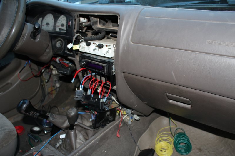

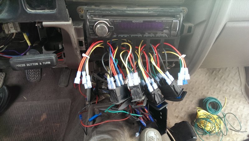

    You guys may not be impressed with the slider tank, but I'm quite happy with how it turned out. Project took the better part of a day and a half, but that including cleaned up all my wiring in the cab.
    This looks messier than it actually is, prewired the other two slots while I was at it:

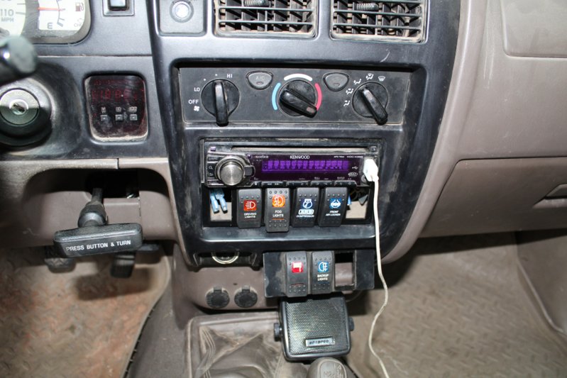

    Need to pick up some blanks, or some seat heaters, but this turned out very clean. Might eventually buy all matching switches, but doesn't bother me enough now. Even with the ARB compressor switch.

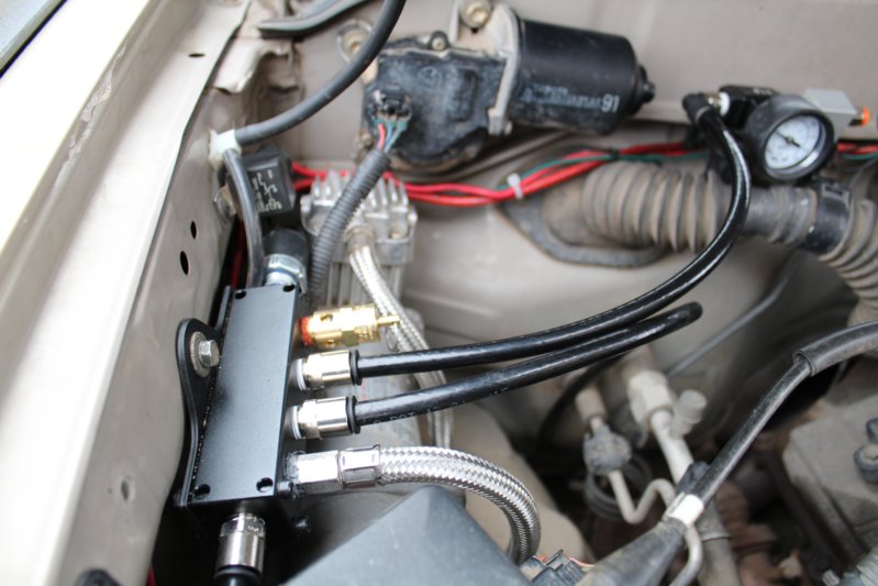

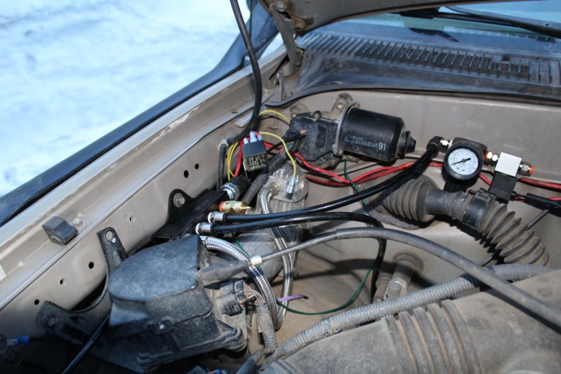

    Manifold with lines going everywhere. Locker solenoid is wired and working and just waiting for an air line to be run.

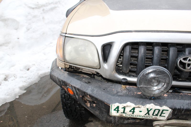

    Quick connect on the front bumper. Complete with flaking paint, missing headlight filler, and cracked light lens. Winter's been rough on my rig:

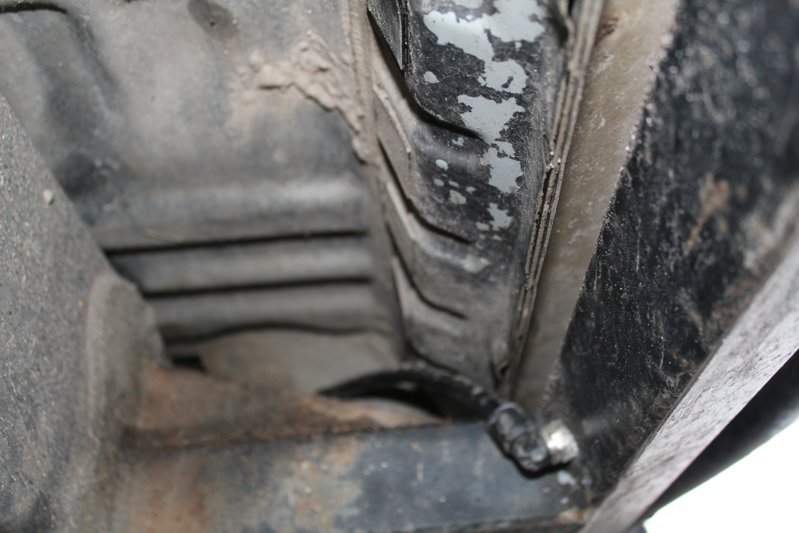

    Line going into the slider is pretty high, and right behind a leg. Don't think it's too vulnerable.
    Pressure switch is 90 on 120 off, and it takes like 20-30 minutes for it to kick on when I'm not using it. Don't know if that small of a leak is worth tracking down. Overall I'm quite pleased with how it turned out.
