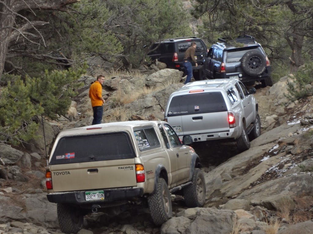

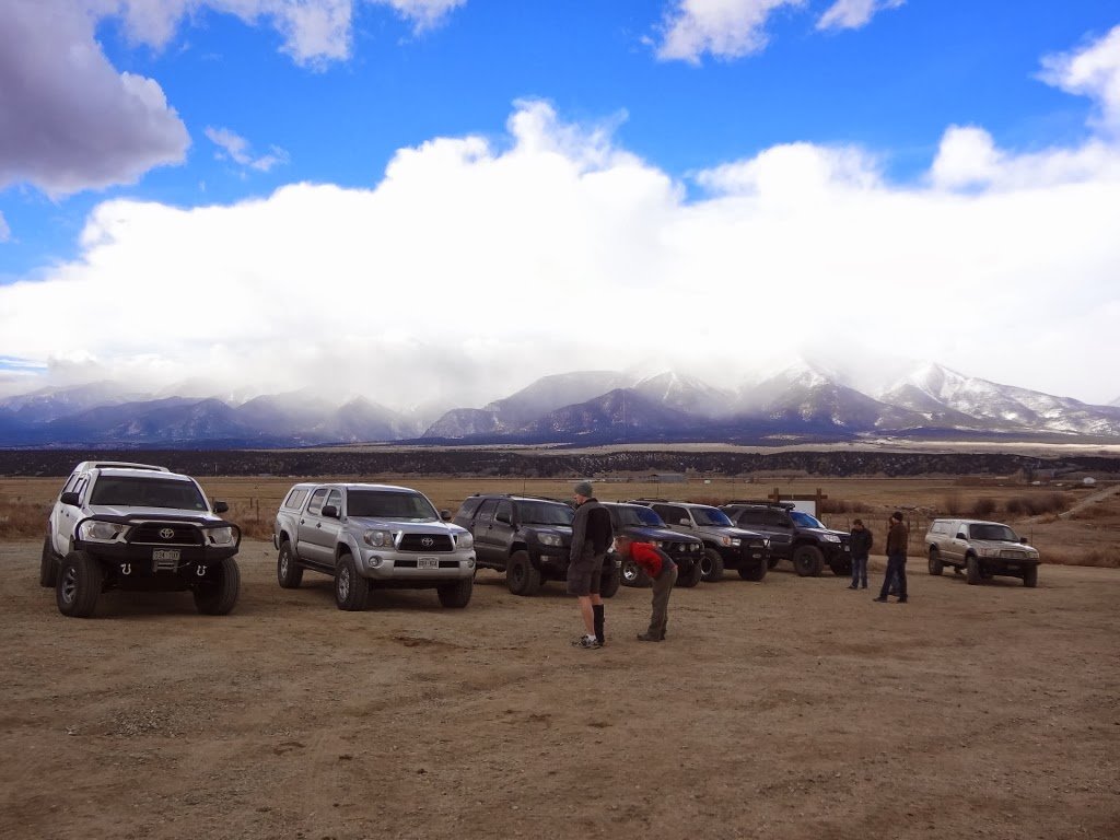

    I guess I never posted this either. Had a lot of fun last weekend at Chinaman's Gultch. Probably about the hardest trail I've tackled with my rig. Report starts about here:
    http://www.tacomaworld.com/forum/south-west/250254-colorado-trip-reports-22.html#post7720292
    Not too many pics of my rig, but I stole a couple from Eric (teamhypoxia).

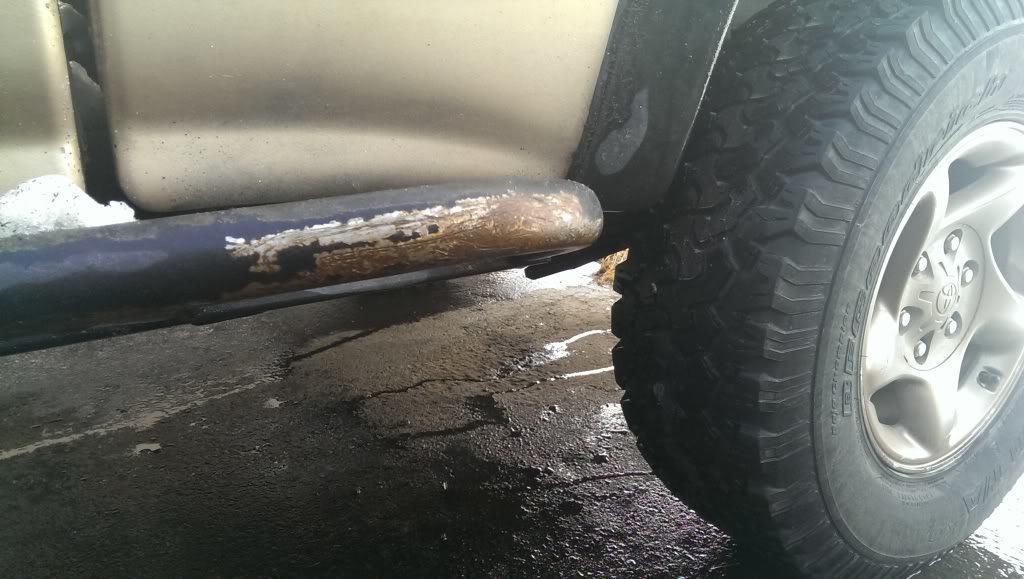

    And my kickout sliders saved me, rusted up real quick on the drive home in the snow though:

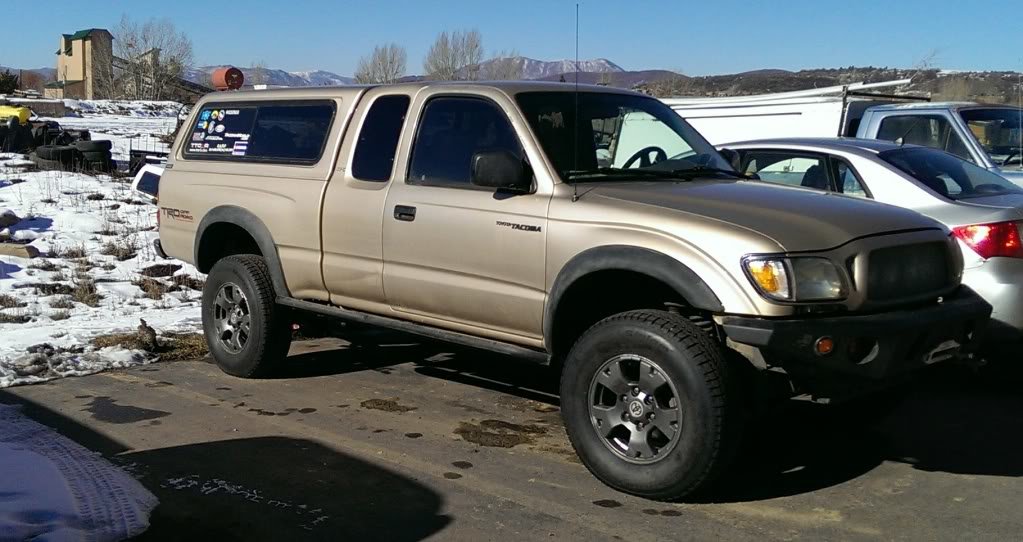

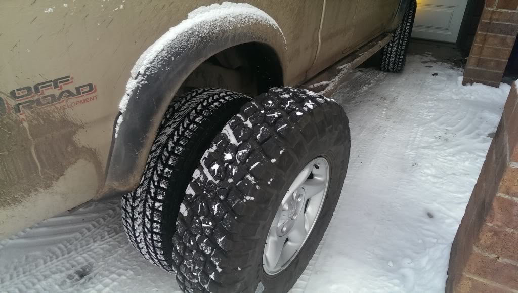

    Winter wheels/tires
    Little tires look a little goofy, but man are they amazing on snow and ice!

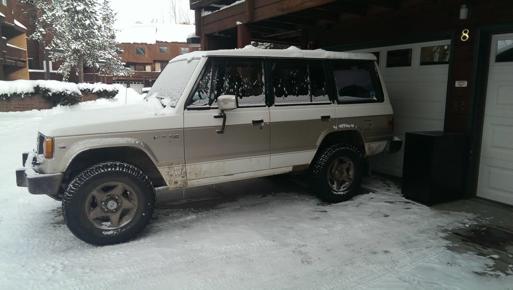

    It was -10 this morning, but I still got you guys a few pictures.
    255/85s compared to my 245/75s
    265/75s got donated to my Montero:
    And compared to the 265/75s:

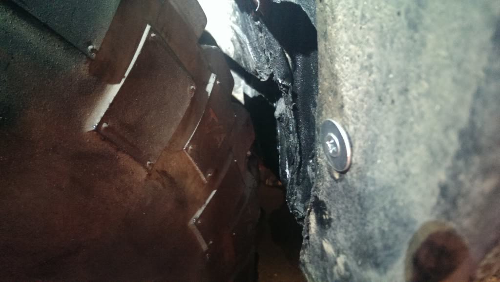

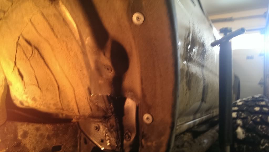

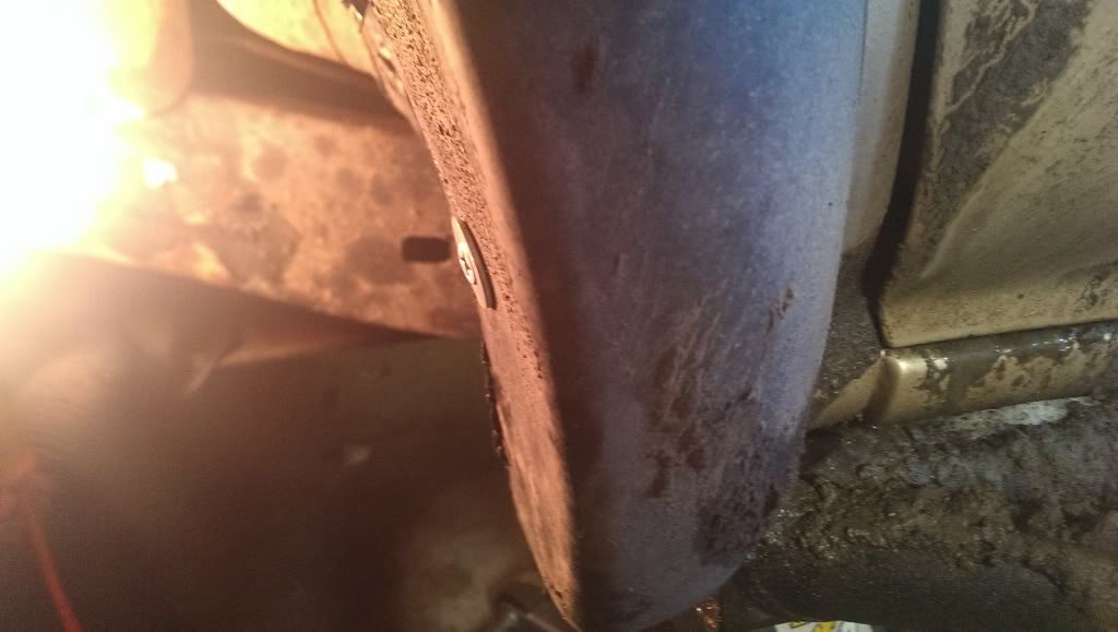

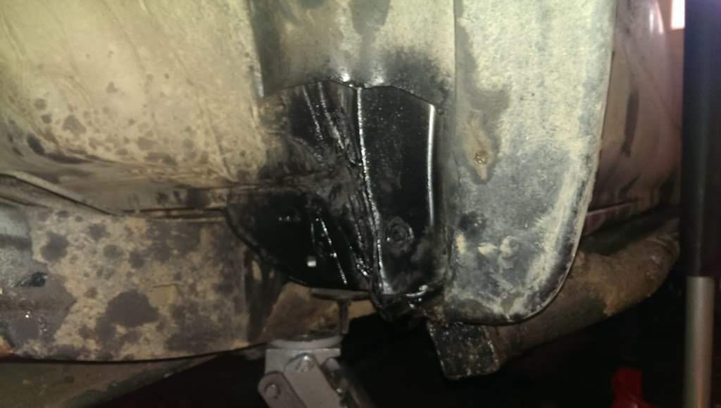

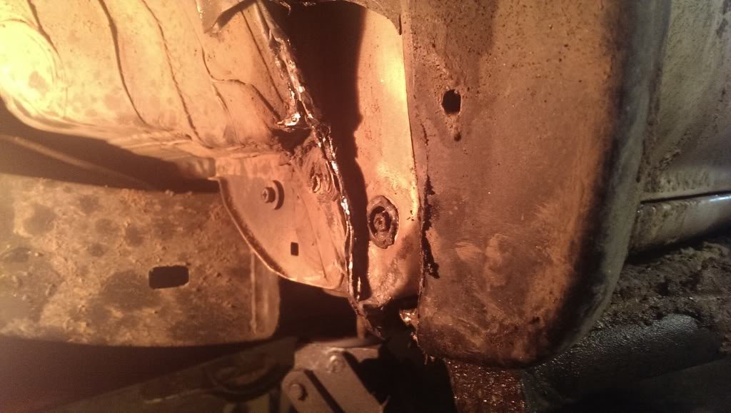

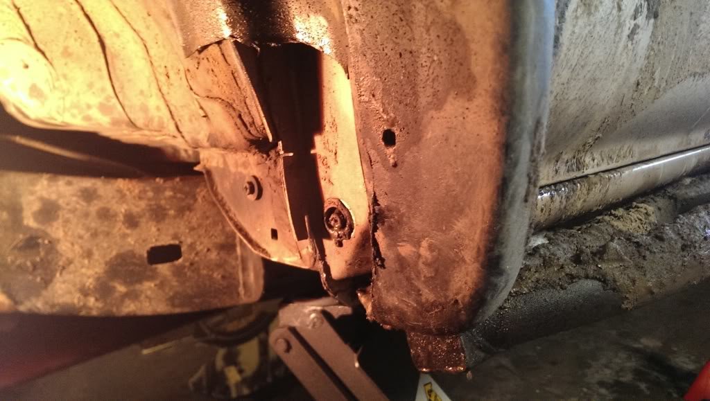

    Well taking a quick break from hacking up my fender and pinch weld. I've got one side down. I probably did more than I had to, but that's less clearancing I'll have to do later.
    Decided to cut off the majority of the pinch weld, versus just hammering it:
    After finishing it off with a BFH:
    Quick coat of paint:
    Replaced the flare screws with these so they sit more flush:
    Its a tight fit:
    Finished the side off by taking out the corner of my flare and a bit of the fender behind it:
    Should be able to finish it up this afternoon, so be prepared for pics :spy:
