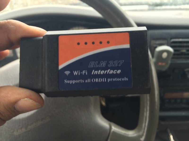

    Which one specifically? Just ordered the wireless OBDII .

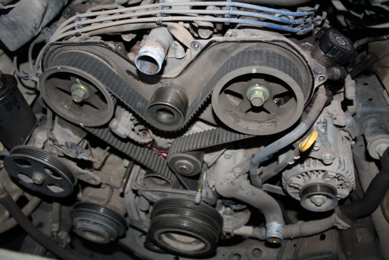

    So you did just the belt and pump? I guess all I really did was the pump besides the HG and all the gaskets on the way in.

    Timing belt, water pump, thermostat, t-belt idler pulley, t-belt tensioner, and all 3 accessory belts. All OEM parts. Kit I bought also came with cam seals and a crank seal, but I didn't bother replacing them. It was preventive maintenance being I've put almost 60K on the truck since I bought it, and I was unsure when the last one was done by the previous owner as he told me a few different stories when I bought it. Seeing it though, I think it was done at 190K when he said it was. Belt was in good condition, with no signs of cracks or dry rot, and you could still read 'Gates' and the part number very clearly on the belt.

    Good deal, I just went back and did the thermostat and the radiator hoses, should have done them with the HG, but it wasn't too much extra work as a standalone repair.

    Haha, no problem, I got one of those, which app are you using?

    Engine link on a 5s phone

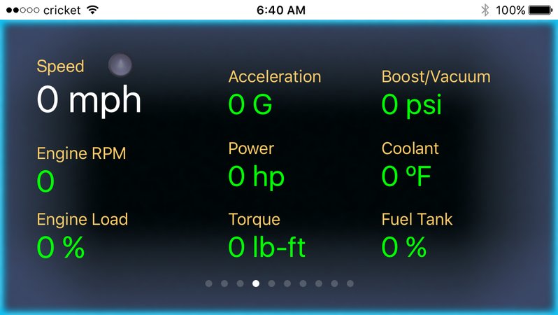

    Ray did you have to write a PID to get the tranny temps or did they show up right away? On Torque I had to add 2 PID programs to get the 2 tranny temps. I enlisted Michelin man for help on that on one.

    I don't have a tranny temp so I would have to write a PID to see it. I just follow the coolant.
    I could add things to this screen to watch if I need to. I added these when I was adding a sim to my 2.7

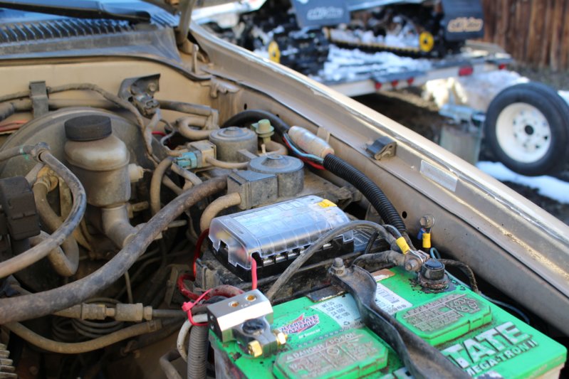

    Cleaned up the electrical under the hood. Have some more to do, but overall it's a huge improvement.
