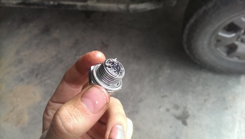

    Anyways, pulled the 3rd again today to fix the slight oil leak. Just wanted to take care of it right away. Drain bolt didn't look too bad after the heat cycles yesterday:
    Spent a lot of time to make sure the 3rd member doesn't leak again, hopefully it holds out this time. At least pulling a 3rd isn't too difficult, especially compared to the front.
    Found a IR temp gauge, measured 120 degrees after a light 15 minute drive, so I'm happy with that.
