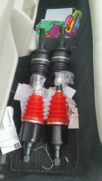

    Not for a few weeks I would say. Need to rack up some miles on the diffs. Also concerned about putting highway miles on until I get this vibration figured out. Seems like it picked up after the regear, so not sure what that's about. Hoping it's just that u-joint.
    Also think I have a front wheeling bearing issue that's picking up that will be addressed when I swap to the other spindles. Which requires getting the gussets welded on. And being I send the spindles with Leo, that requires a trip to the Front Range.
    Long story short I want to get everything buttoned up. Then it should be ready to crawl all summer long.

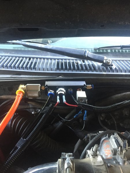

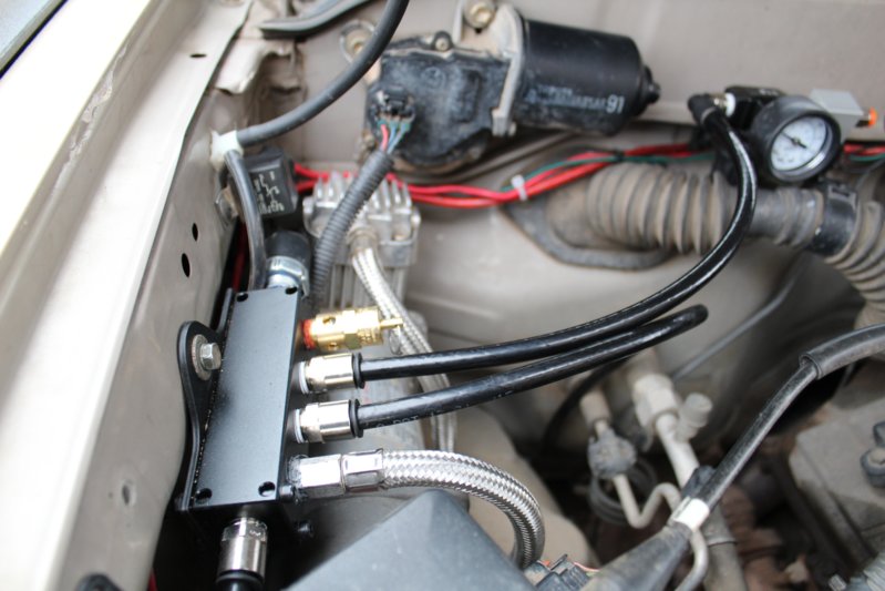

    So you didn't use a regular gasket? I'm about to install my arb
    You used the viair manifold?
  5. Apr 5, 2016 at 6:03 PM

    Yes. There's no paper gasket. Just ultra black RTV. Have no idea what would be the ideal method though. :notsure: No leaks thus far.
    And yes. I recently finished up and OBA install using a Viar manifold:

    No air leaks?? I used the same

    I've got a 90psi on 120psi off pressure switch. It takes somewhere around 45 minutes for it to leak down enough to turn back on.
    Haven't bothered tracing that small of a leak down as it doesn't seem big enough for me to worry about. And I'm using my slider as an air tank, so I wouldn't be surprised if it's leaking out of there somewhere.

    My leak is around the same lol
    Think I should just use rtv when I put my 3rd back in?

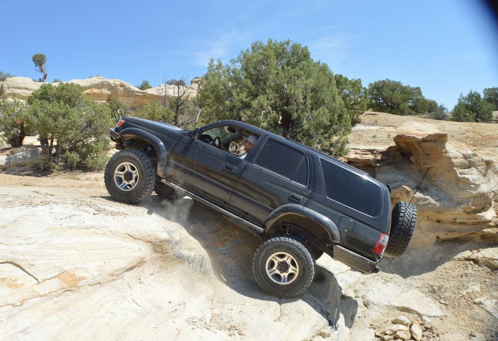

    This past summer, there was a far left line that looks like it's been closed for years. But there was still clearly two main lines. The right one that was fairly wide with a few options, and the left one that was a gnarly v-notch sort of deal.
