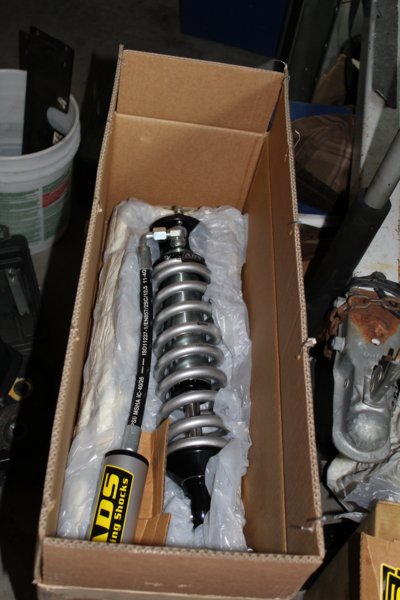

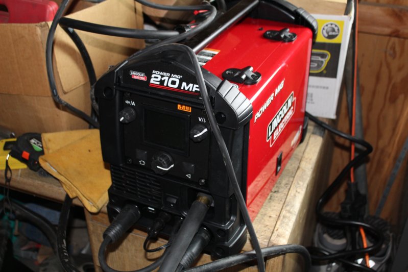

    A couple steps closer to getting this thing where I want it:

    On board welder?

    I love my 210mp, did you get the TIG kit? I'm going aftermarket for mine, I got my welder before they some them as a kit with the machine.

    Save your pennies. I've been waiting for these mods for a long time.
    No. Just a regular welder, but a good one that will allow me to tackle some fab projects I need to get to.
    Good to hear :thumbsup: Didn't get the TIG kit because I didn't want to spend the money right now and don't know when I'll need it. Will definitely be adding it in the future though.

    #junkyardparts
    A couple of tips with mig. You could either use a cursive e or j motion to get clean welds that penetrate and fill well. Just figure I give you a tip since you gave me some with other things.

    :thumbsup: I've got a lot to learn, just need to get some hours logged. But first I need to get some gas, as there's no welding shop local to me. Also need to get the garage wired up properly.
    I used the one's cut for the axle diameter, but they weren't paired. The paired ones are much more expensive, but worth it in the time it saves you to fab it up. Just make sure they're the right width. Those look like 1.5" width, which is pretty standard, but I believe different shocks might be different.
