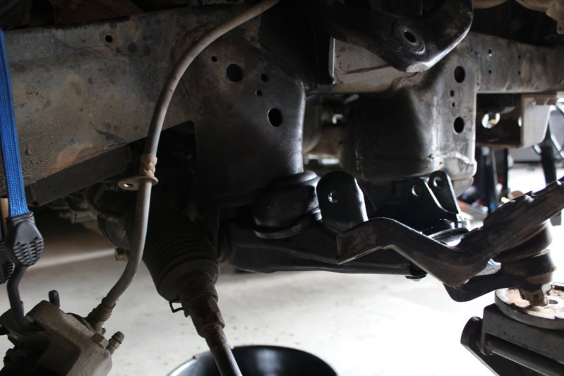

    Well, I decided since I've got other vehicles to drive, I might as well just rip this thing apart. A bit different then mine norm of tossing everything together really quickly without taking the time to do things properly.
    Testing bump with my existing bumps. Got a whole 8 5/8" of travel between bump and maxing out the stock UBJ.
    Mounted the Wheeler's Super Bumps to the stock rear location. I've read this is the better location for it as it's a bit further from the LCA to the frame. Hit's it a little sideways:
    Thinking about trimming a bit of an angle to it so it hits straight, but I don't know how much that would help. It does compress all the way down to the other bump, with a decent bit of resistance. So it should do it's job.

    Do not cut the bump. I did that with my first set. It didn't work well. I ended up ordering new ones. The bump will do its job without the angle cut. You won't gain much if you do.

    :thumbsup: I'll leave well enough alone.
