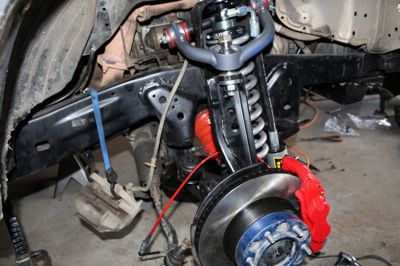

    A couple more steps down. Going to have a busy week at work, but hoping to have it driving in a couple days.

    Looking good:thumbsup:
    You know you're going to have to run a soup can tailpipe extension with those bright red calipers right?:D

    So did you end up welding the spindles yourself?
    :eek: you have cvj's nice!

    I'm not so sure about the soup can, but wondering about my ability to weld thin wall exhaust tubing. I would like to have an exhaust that actually make it to the back of the truck again instead of dumping in front of the axle.
    Nope, @sbchero welded them up this morning. Super thankful for the help, and quite envious of the shop!
    And yes, new CVJs in there too. Might end up having to move the clamp on the high angle boot in just a bit though. It's very close to the coilover. Thankfully, they supplied an additional clamp for this reason.

    Cool! Yeah he's a real cool guy. Very helpful. Those red boots can be moved. They put a small plastic tube between the shaft and boot. Push your boot up to where you want it then get a needle nose pliers and pull the plastic tube out then the boot sits tight and won't move.
