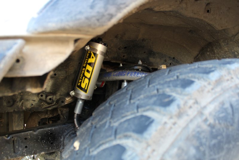

    How's it ride? Welcome to the ads club :cool:
    Think timmy just has his strapped to the frame vertically...he should be on enough to show a photo though. He also has the benefit of running a skinnier tire then yourself.

    Need to get some more miles on it to get a better feeling. But so far so good. Don't have a local mall to mob, but I did find some speed bumps, which I hit hard, and it felt awesome.
    You should take a picture a little further away from the subject matter. I can almost make out what we're trying to look at...

    I'll keep that in mind next time :luvya:

    Anyways, mounted the resis like Timmy. Little unsure of having them mounted to the body, but I think there's enough play in the hose that it won't present a problem. Cut some sheet metal to try to get them on top of the frame, and that didn't play out either.

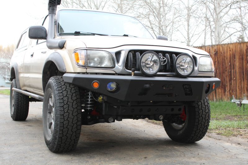

    Rigs lookin good man! Looks like you're about due for some new shoes!

    Yeah. Thinking I'm going to smoke whats left of them in Moab and then decide what I want to do about replacements.
