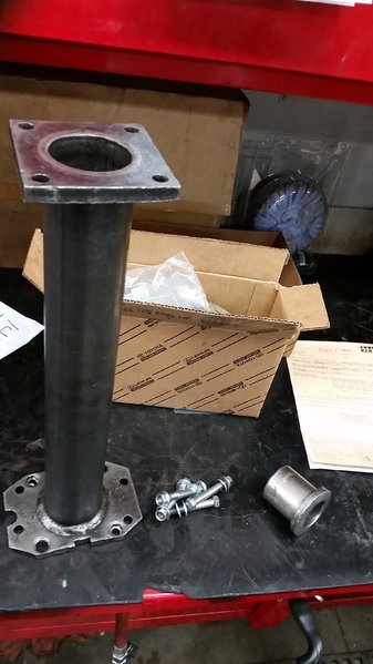

    Got everything on order to do rear axle seals and bearings with OEM parts. @lotsoftoys or @thefatkid, can one of you get me a pic and maybe the length of the SST for pressing the axle bearing? Want to try to make a tool.

    I have an old axle housing I cut up. The whole shop loves it because you don't have to cut the ABS rotor off. I has no pics at night

    I've heard that's a good way to do it. Wonder if I can find an old axle housing cheap. I imagine that axle flange bolt pattern was the same across all the trucks/4runners?
    Already ordered new ABS rotors, so I'm prepared to cut those off and replace them. Seems a bit ridiculous to be replacing those when my truck doesn't even have ABS.

    Here's the Toyota tool. No cutting required either. Do need a thin set of snap ring pliers. Did a set on a 4runner first day back from moab;)

    :thumbsup: I'll see what I can come up with.
