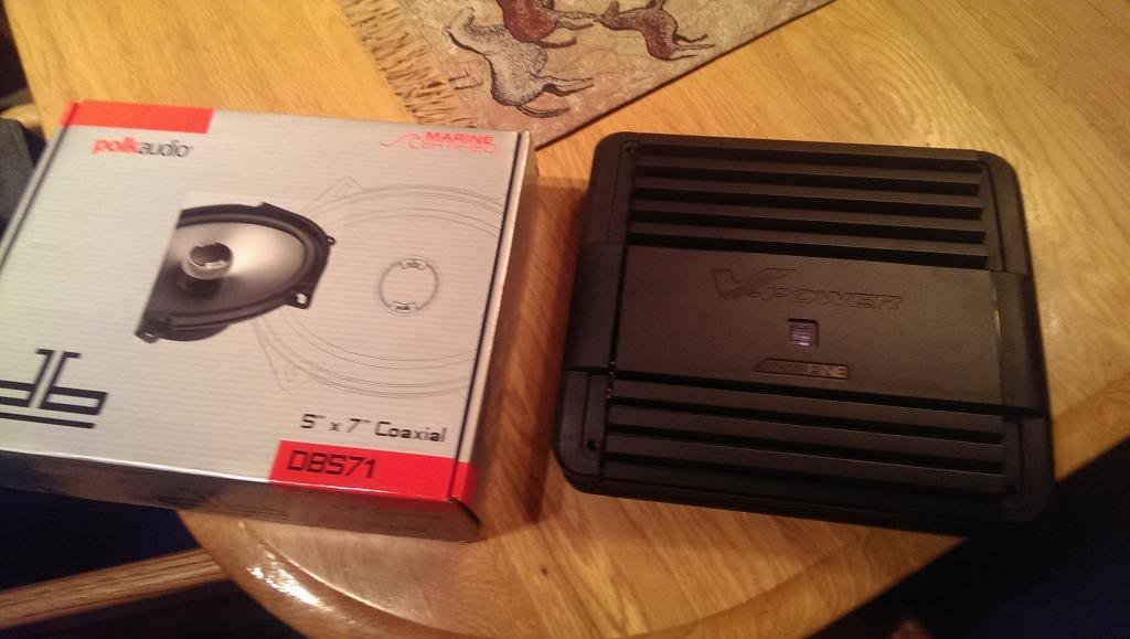

    Got a couple things today.
    Switching out my 2 channel amp to a 4 and got another set of DB571 for the rear. We'll see how much of a differnce it makes. I just decided I needed a little weekend project. Haven't done anything to my truck this winter....

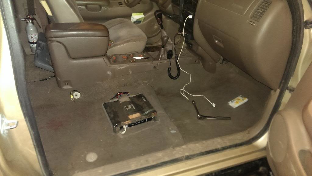

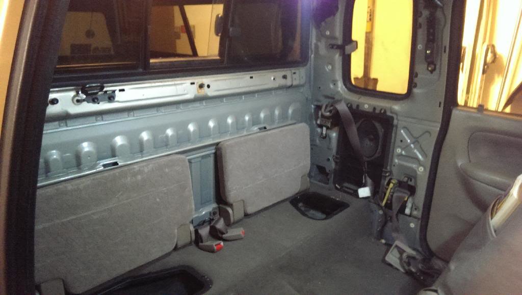

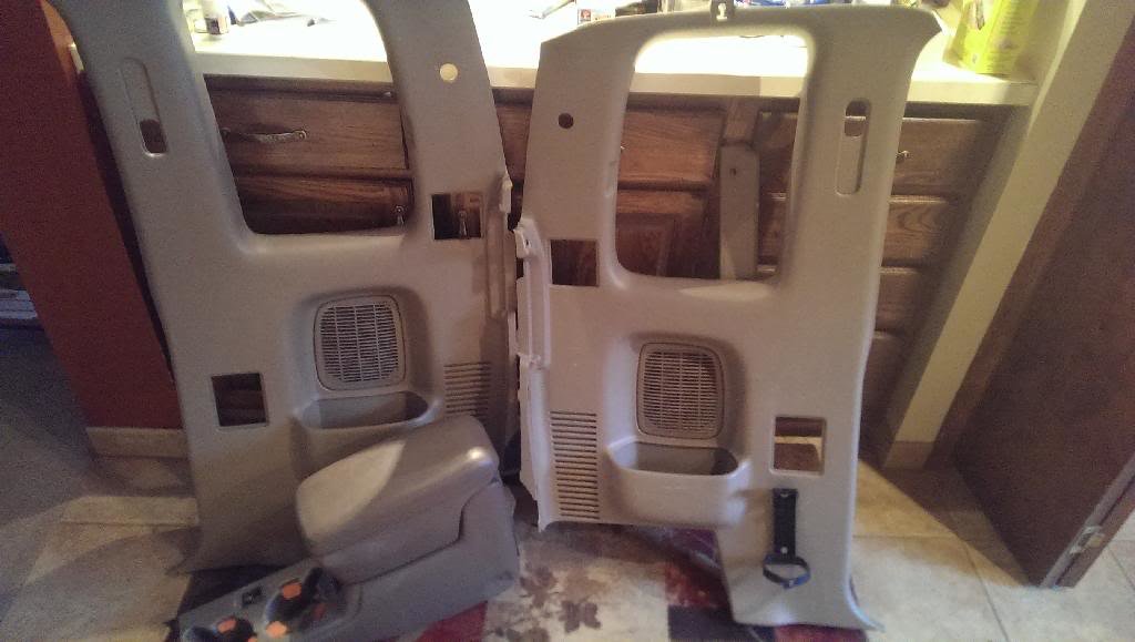

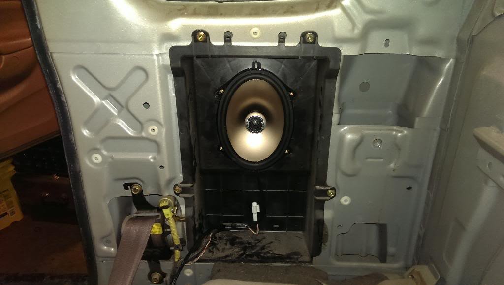

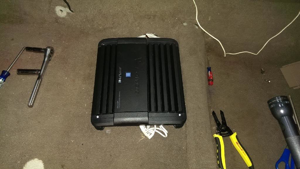

    Spent last night and this morning installing my rear speakers and new amp.
    Seat out and old amp:
    Back all taken apart:
    New speaker installed:
    Decided to clean these plastics up they were out:
    New amp (Alpine MRP-F300) all wired and installed:
    Reassembly went smoothly, with the exception of the passenger side panel not wanting to cooperate. Spend a half-hour screwing around with the clips and not getting anywhere. Just said screw it and left it with only about half the clips snapped in. I've got some work to do to get everything tuned in perfect, but so far I'm loving it.

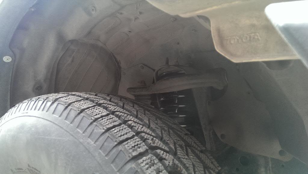

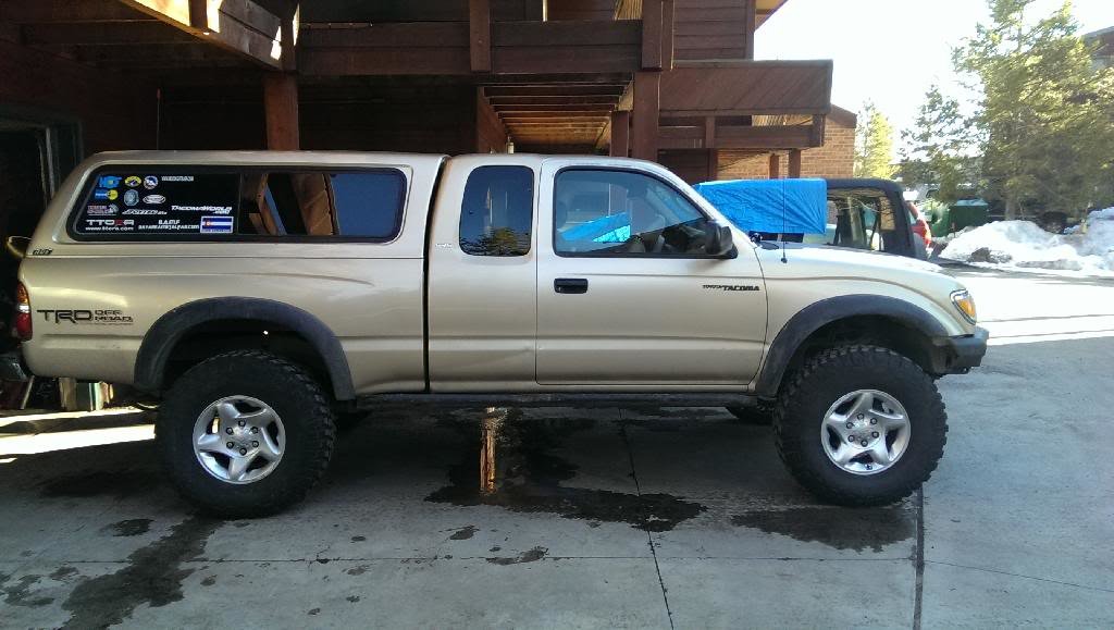

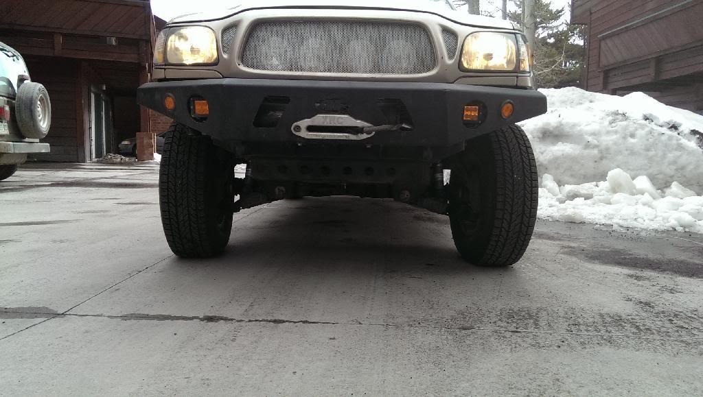

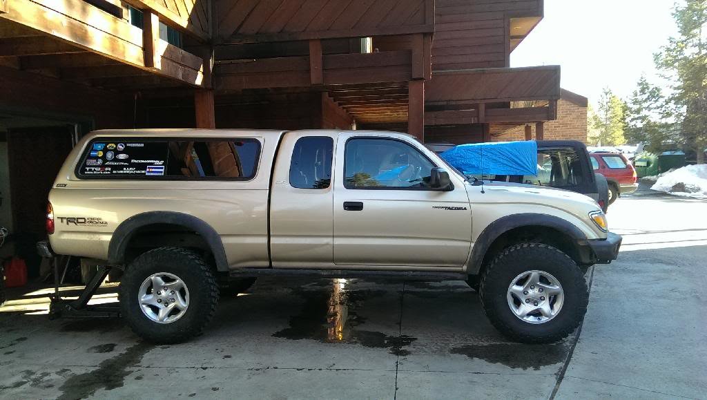

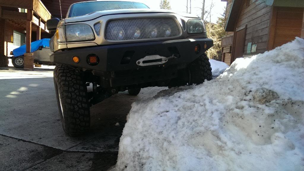

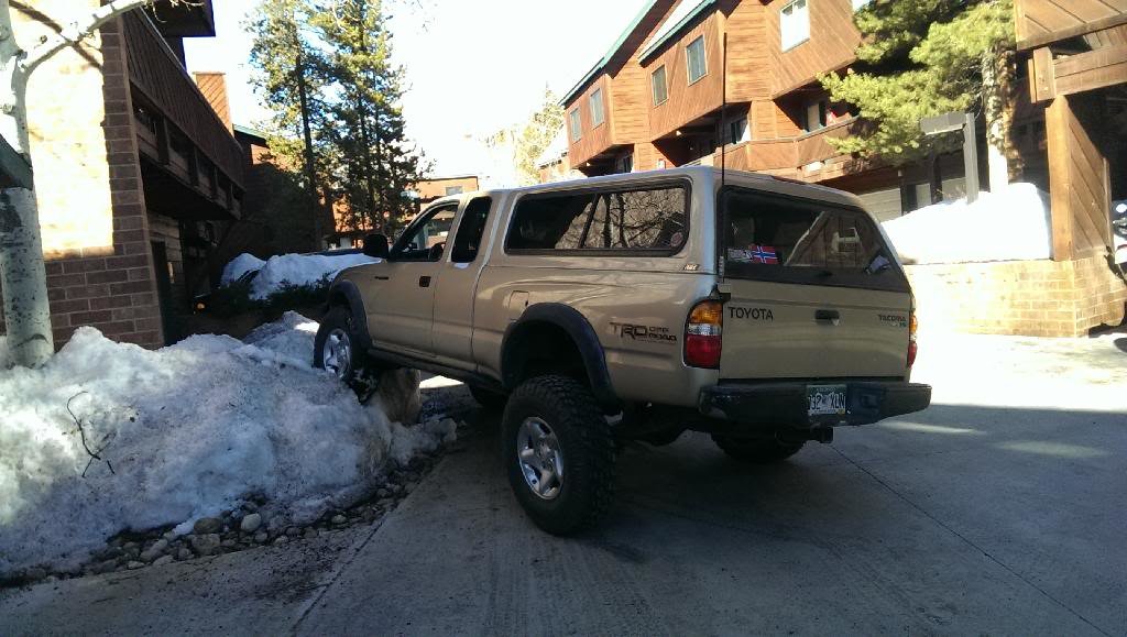

    It was nice this weekend, so I decided to work on the truck. Of course the coils sounded like a much better job than the steering rack bushings, so that's what I did. While swapping coils though, I noticed a tear in one the steering rack boots, and a little fluid in there. So, might have to look into an entire new rack. I was thinking back though, In two weeks, I'll have owned the truck for two years, 22ish thousand miles, and haven't had to do any repairs. So a steering rack doesn't sound too bad.
    Anyways, here are some picutres for you.
    Also added longer top plate studs:
    Looks a little funny with the small tires. So, right now I'm sitting at almost exactly 24" hub to fender without my skids. Don't know how much that will drop when they settle and I put the skids on, but I'm thinking I might end up adding a top plate spacer. Who knows...
    Oh, and obligatory hand wound, this one was the worst in awhile:

    Truck looks good! I bet they hold the skids fine, it sits pretty tall with your bumper as is.

    Where are you sitting now? I remember reading that with your 882s and no top plate spaces you were at 24.5". So I'm a solid half inch lower, and still have to put on my ~100lbs of skids.
    But yeah, looking good, will look better with the bigger tires. It's sitting perfectly level right now, so I should get the rake I want with the shackles.

    I'm still at 24 1/2". I wonder what the weight difference is between bumpers? Looking at your pics the angles of the uca and the lca's look similar to mine. Could also be a variance between my bushwacker flares and the flares you have as far as that 1/2" difference.
    Either way I would think that the 882 could handle the skids with no problem. A thin top plate spacer won't hurt anything at all if it's needed and you took steps to prepare for it.

    Also, my bumper is about 100 pounds, or 30 more than yours, and I'm sure my XRC10 weights a little more than your XRC8. But I agree, there's a lot of factors here so I think I'm in the ballpark.

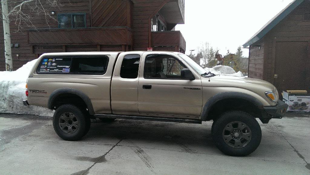

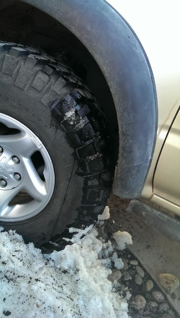

    Painted up the wheels today that came with my 255s. Decided to try yet another option. Stuck with Duplicolor wheel paint, but this time went with Silver paired with their Matte clear coat. I think it looks pretty good.
    Also decided to throw the jack under the hitch to get an idea what it would looks like with the 2" lift shackles. Should be close to the right amount of rake:
    Then decided to do some driveway snowbank flexing:
    882s compress nicely:
    And the 255/85s clear pretty well:
