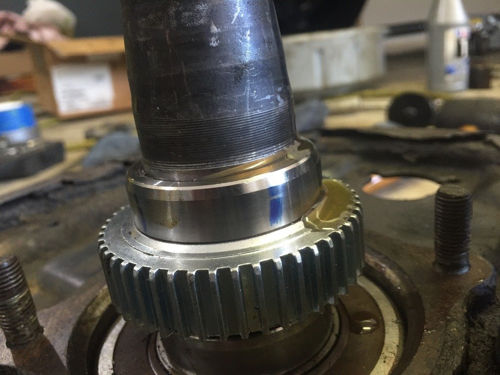

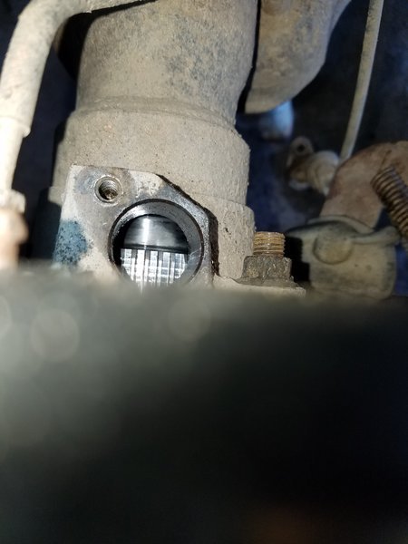

    I think toyota messed up when they did my bearing and pushed the part that is to seal outward way to far. Let me know what you think.
    Looking into the abs hole.
    Tried repacking it with grease to get me by I hope it's enough...

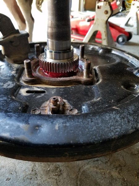

    Uh shit Ryan, there should be to collars on that. Toyota did that?
    The one collar is for holding the bearing on and the other collar is for riding on the seal. You arent going to be sealing at all.
    From bottom up it goes bearing, collar, c clip, tone ring, and last collar.
    Shows the order and where the seal rode on mine till I re-did it. I moved it up a smidge.

    Yes a Toyota dealer did this! I hope they work with me on getting this fixed. I took it there and paid there rate so I knew it was done right! So frustrating! And to find it days before a trip to black bear pass.

    Is there a second retainer ring down against the bearing? Can't believe a toyota dealer would do that :eek: There's no where the seal is anywhere close to the retainer.

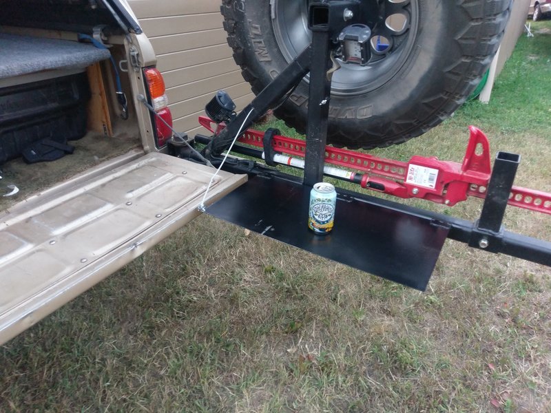

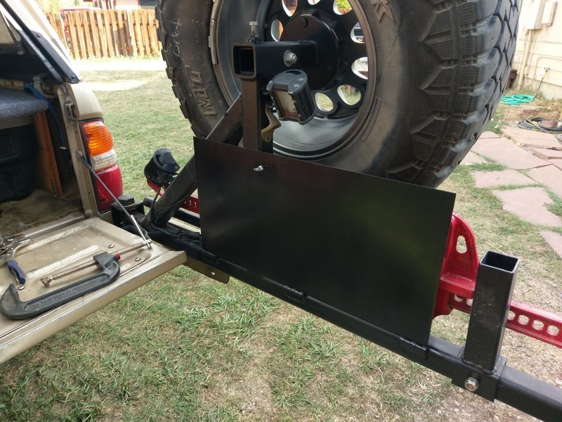

    Washed, clay bared, and waxed the subi.
    Felt bad about my truck get relegated to the back yard, so I fabbed up a quick camp table. Just need to get some cable to hold it out at 90°.

    Real kitchen status now

    Kitchen? As long as it holds a beer I'll be happy.
    :cool:

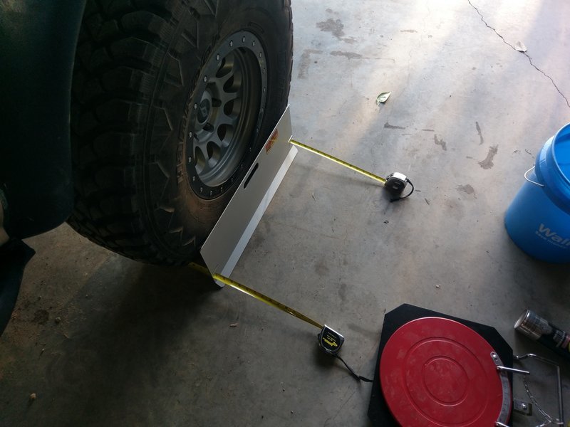

    Toe plates and turn tables are very handy. Hopefully this prevents messing up another expensive set of tires.

    Nice man! You just gotta watch the degree needle. I always push it forward to take the slack out when taking a reading 20°in and out cuz there's some play in it
