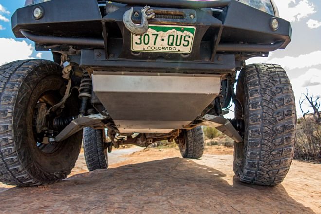

    Brian says he pulls 11'' with it. And he has bumped the uptravel to keep the 37'' tires out of the fenders. So in theory it could be as high as 12.5-13''
    Cool LCA design really.
    Its actually more of a spindle lift then anything which means less preload on the coils for a smoother ride. And wider stance = more wheel travel. But its an inch narrower per side then a full LT kit.
    Price will be the main problem though. You'll need custom CV axles. And really, at that point might as well go a full 3.5'' kit. So price will be the big deal here. You save money though by potentially not having to run fiberglass fenders and not needing 2.5x8'' shocks.
