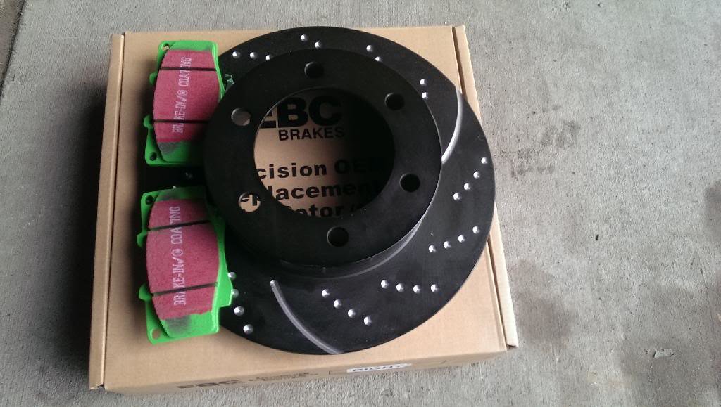

    More parts to install that I don't have time for. First thing I decided I need after running the 255/85s some more:
    EBC Sport rotors and green stuff pads. Kinda needed this anyways though, ever since I bought the truck I get a virbration out of the front brakes going down the passes. I'm guessing I'm on the stock rotors. Also, comtemplated the Tundra swap, but I wanted to keep things stock for a few reason included the possibility for 15" wheels in the future.
    And lastly, ordered a speedometer gear as well as OEM outer tie rods. Local Toyota dealership (3 hours away) didn't have them in stock so just ordered them online. And you were right Timmy, Moog's on Rock Auto are $31, OEMs online were $40. That dealership wanted like $60 BTW.

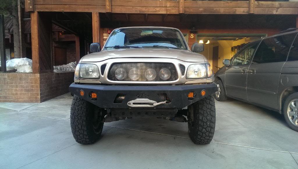

    Non-driveway pic of the current setup:

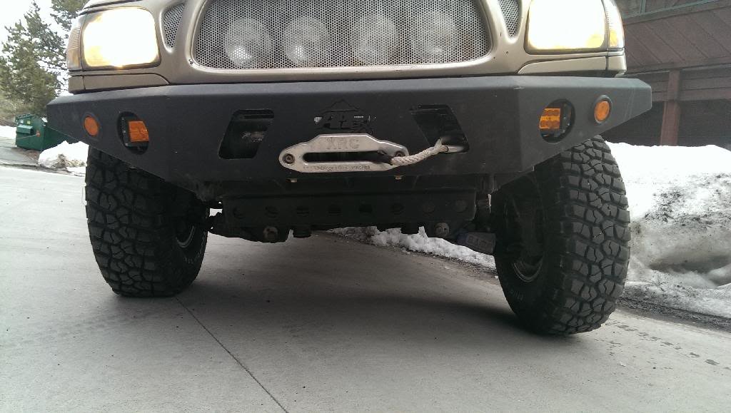

    I love driving up snowbanks:
    On the bump stop here. Tires clear nicely, but not saying that'll be the case when the wheels aren't straight.

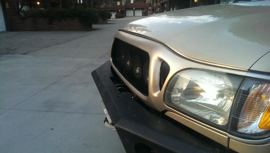

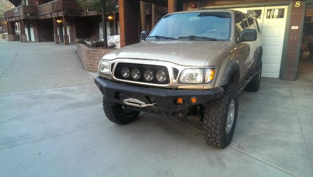

    Another iteration of my grill. Painted the mesh and the lip black this time. Don't know how I like it
    Also, does anyone have any input on those rear shocks?

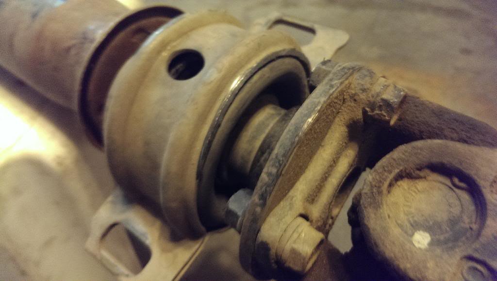

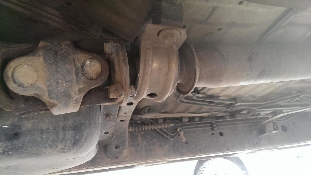

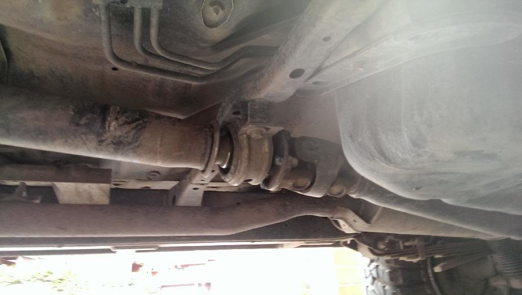

    Had an interesting adventure today:
    Got stuck in a creek:
    Didn't bother getting any better pics as I was franticlly trying to get it out.
    Found out what I got stuck on:

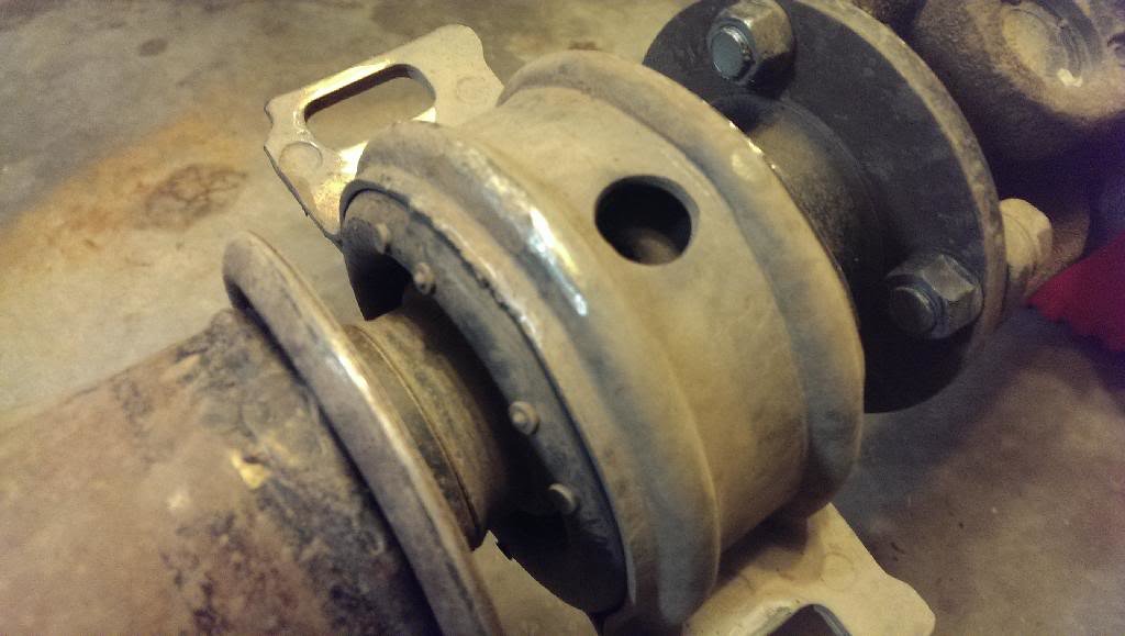

    And carrier bearing got smashed:
    Overall, not one of my better outings. Does anyone have any input on whether I can just replace the carrier bearing or if there may be other drive shaft issues. The angles looks kinda wierd, but the carrier bearing now has some extra play...

    Holy shit !:eek:
    I'll bet you were frantic. Sorry to hear about your day, that just sucks.
    The carrier bearing mounts may have been bent causing the angle, looks like you were hung up pretty good on that too.
    As long as the drive line has no dents it should be ok to just replace the carrier, if it's actually damaged, and pry the mounts straight again if they are actually bent. My money says the mount is tweaked back

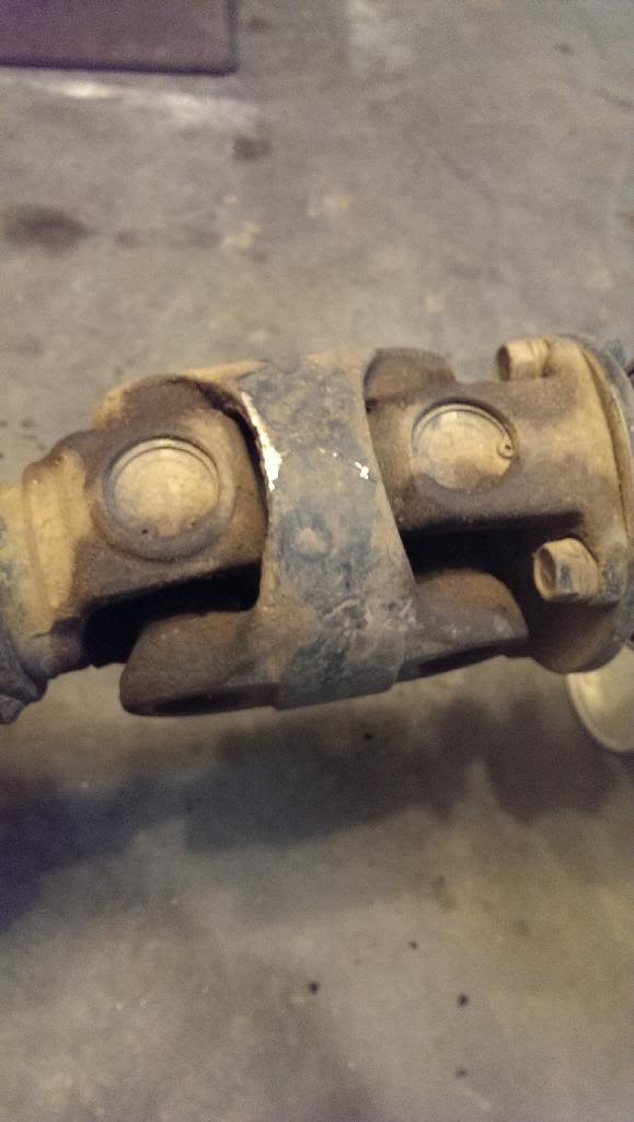

    Just pulled the drive shaft. Everything appears OK, carrier bearing is completely toast. Mount is clearly bent. Will be ordering a new carrier bearing ASAP, and attempting to get that mount as straight as possible. Maybe I'll get a quick video of that carrier bearing, it's rather comical.
    And hey, it wasn't the most fun thing, but it was a good experience, and will make for a good story :cheers:

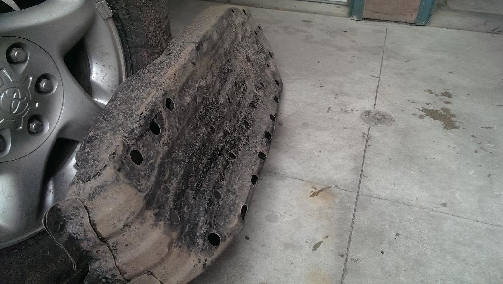

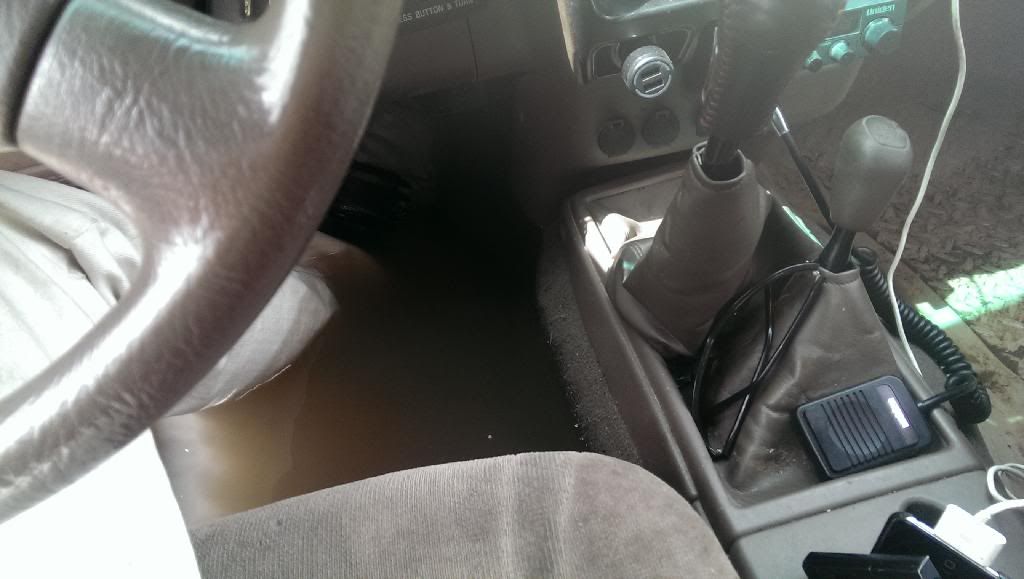

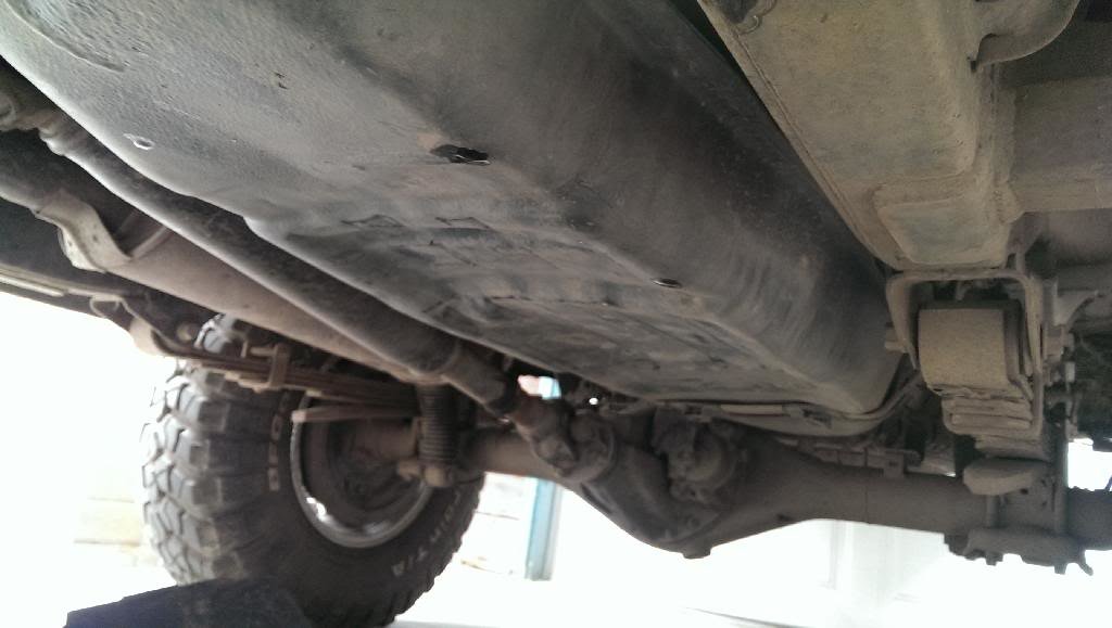

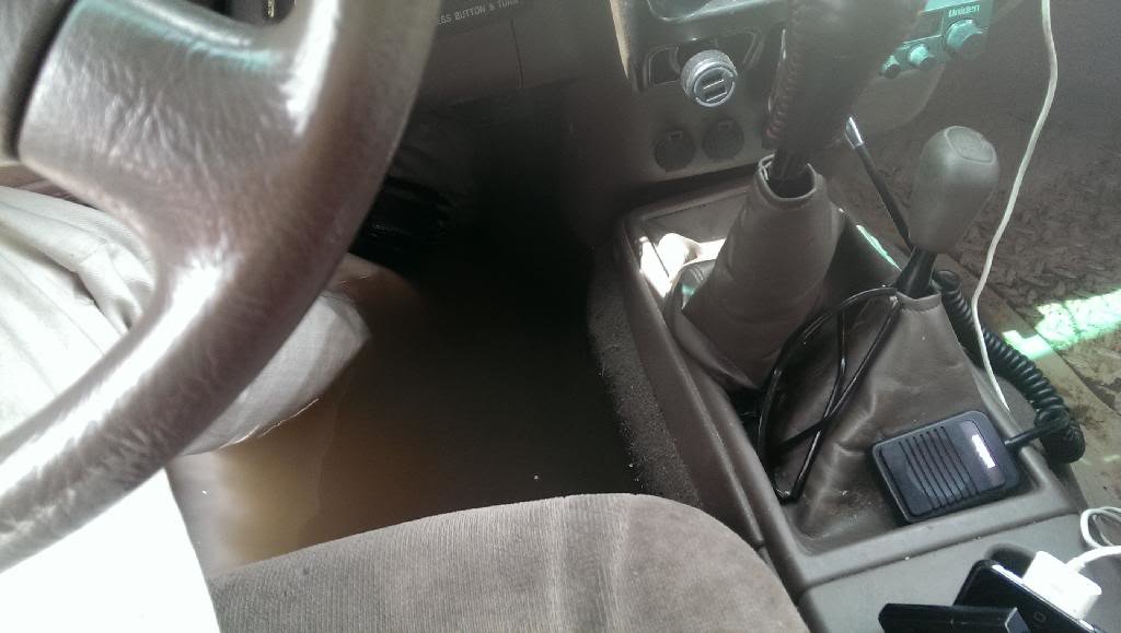

    In all honestly, I'm a little worried about the gas tank too. Any issue with it being pushed in like that? When I first got out of the creek, I though I heard the fuel pump whining, but don't hear it anymore :notsure:
    Everything seems fine so far. It was the drivers side that was in the deepest water. You should have seen the water pour out when I finally was able to open the door! But yeah, amp didn't see any water, my driver speaker was completely underwater, but that Polk is marine rated. I imagine there was water around the fuses too, but I haven't noticed anything not working....
    ....yet.
    Otherwise thanks guys for the comments, although the winch was partially underwater, it certainly saved my ass!

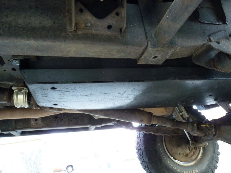

    I wouldn't worry about the tank too much. I know a couple of other guys who have bashed theirs pretty good and none of them leak.
    If you want, we can meet up and make a template of my skid. Or, if you don't have a welder, I could fab something up for you... with LilSkip's Offroad permission of course!

    So, evidently I was on the carrier bearing pretty hard. In fact, it's no longer round :anonymous:
    Pushed it all the way into those nuts:
    Hit it here too:
    and here:
    Don't see any major dents though.
    Slashaar likes this.

    Kind of hard to tell from the pics how deep the tank dent is. Depending on where the sending unit is it may not affect it too bad but I would go with Jace's advice.
    If it were me,cause I'm cheap and stubborn, I'd carry a 5 gallon can of gas and drive it till it runs out to see exactly where you're at with the tank level when it dies.
    I'm not familar with the Taco tank, but can it be pulled and accessed through the top where the sending unit is and maybe pushed back into shape with a dowel rod?
