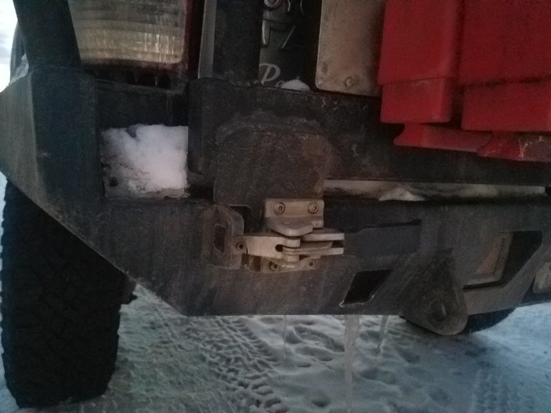

    I have a swing out and topper as well on my truck. The only time it is a hassle is when you are in a parking lot and somebody parks behind you. I can post a pick of my latch in a little if you would like. I can remember exactly what you would call Brett's latch, but it is basically a ubolt with a handle on it. I think it is rated for 2000 lbs, but don't quote me on that.

    Here is my latch. It is really nice and won't open on accident. Also it comes with option to put a lock on it if you want.

    @Night Eagle how do you ad tension so it doesn't vibrate or rattle?

    :brianr: it doesn't rattle any more
    There is a set screw on the clasp location so you can increase the tention.

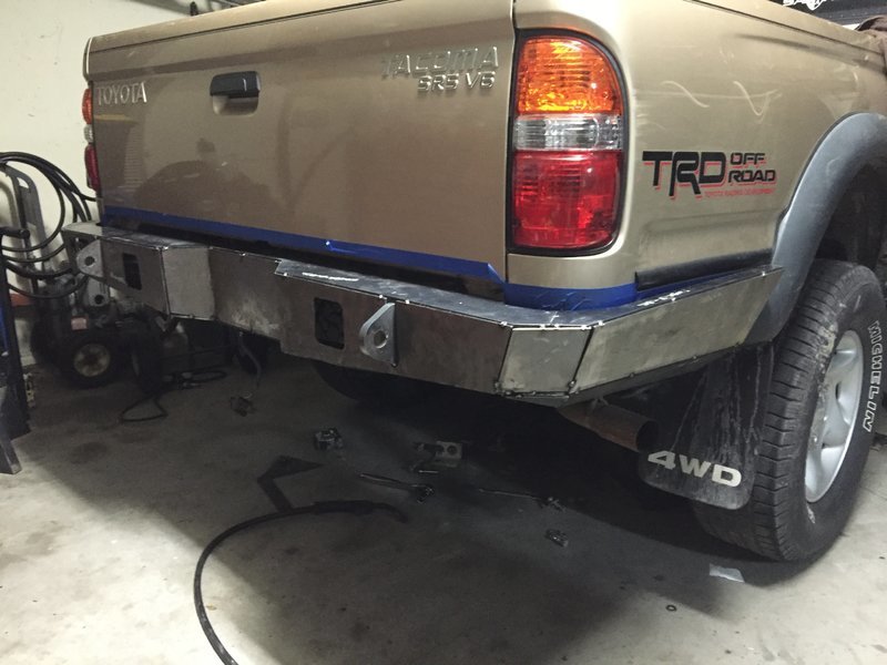

    On the come up...
