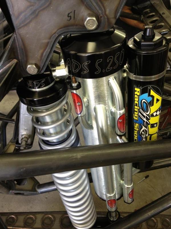

    Over the top caps allow the piston to travel inside them as they are threaded on outside the body VS inside like normal smooth bodies. You can get oil capacity back with a larger resi, longer or bigger diameter. Ask ADS for the shortest 2.5 shock you can fit and thier 5.25" resi's! I'm curious if they will do it.

    I looked, there 5.25 doesn't even have a matching diameter resi, look like 3" maybe 3.5. Kinda hard to get a reference as the fucking body is so damn big.

    I've seen photos of them. Freaking crazy huge..
    Mega Trophy truck status...i need them.. lol those things are almost laughably huge.
