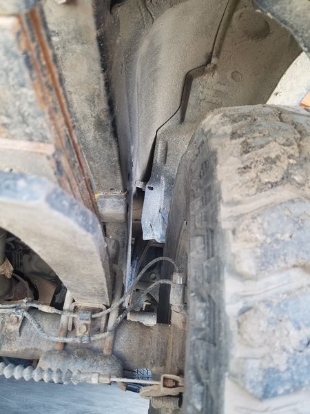

    So my rear shock finally took a shit so I've started to do some research on redoing my whole rear and found this thread Kind of what I was getting at a few weeks ago.
    This also popped up Not sure why it's only a 10" shock. Looks like there is more room in the wheel well to extend the mount. Maybe at extreme flexing the angle the compressed tire is will hit the shock. :notsure:
    quetzal and alee891 like this.
  16. Mar 20, 2017 at 6:45 PM
    #1956
    Squeaky Penguin
    Squeaky Penguin [OP] Nothing Ventured, Nothing Gained
    Apr 5, 2012
    #76340
    10,082
    Brett
    Steamboat Springs, Colorado
    '01 4WD, SR5, TRD & '13 TRDOR AC
    Lots of dust and custom dents, Check Build
    Here's a quick pic, real world gap would probably be less with the bump compressing etc:
    [​IMG]2017-03-20_07-42-10 by brettbjorgum, on Flickr
    I might be able to fit a 2.0 if I angle in way far forward, whereas I would loose dampening due to the angle. I'll be keeping the 10" shocks vertical just inboard of the frame.
    Reh5108[QUOTED] likes this.

  18. Mar 21, 2017 at 8:18 PM
    #1958
    Squeaky Penguin
    Apr 5, 2012
    #76340
    10,082
    Brett
    That picture was taken at full flex. Keep in mind the top edge of the tire will move closer to the frame as the axle articulates.
